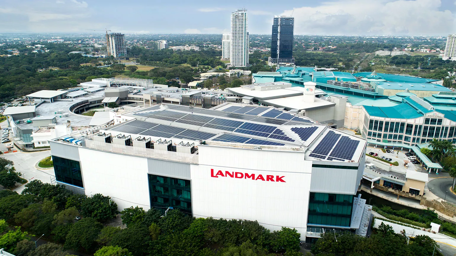

Like most of its competitors, the Philippine supermarket Landmark consumes a considerable amount of energy. The two biggest power guzzlers, cooling and lighting, drive up the company’s operating costs every month. The supermarket operator has therefore decided to make good use of the roof area of the building and to produce the electricity required using solar energy. In February 2018, the almost 740 kWp photovoltaic system in Luzon was put into operation and now supplies approx. 1,025 MWh of renewable photovoltaic electricity every year. This covers a large part of the store’s daily electricity requirements.

“Fronius is our first choice for large commercial PV systems,” says project manager Victor Garcia of Solenergy Systems Inc. The installer must take various factors into account when planning a PV system, such as roof pitch, roof orientation or shading. During this project, the local installation company was faced with the challenge of a particularly demanding roof situation. If, as in this case, the roof has five different orientations, the planning becomes very complex and not every inverter is then the best choice to achieve high yields.

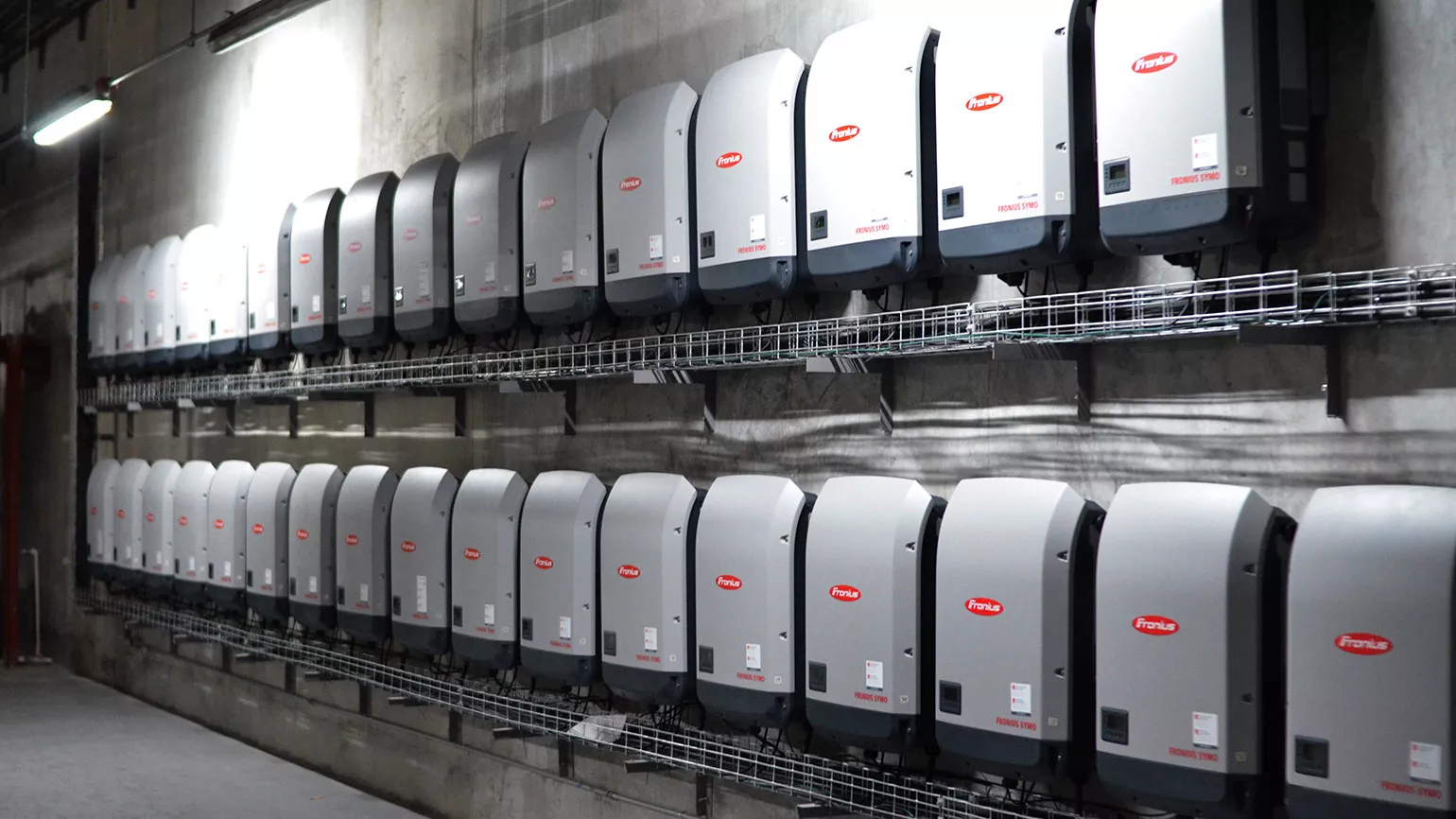

Project manager Victor Garcia knows that, with Fronius as his partner, he has the right solution for his customers whatever the challenge. This PV system in Luzon uses 33 Fronius Symo inverters, the flexibility of which clearly sets them apart from the competition. The devices are ideal for differently aligned or angled roofs and ensure the best yields, no matter how complex the roof orientation.

About the system: |
| System size | 740 kWp |
| System type | Roof-mounted system |
| Inverter | 33 x Fronius Symo 20.0-3-M |
| Annual yield | Approx. 1,025 MWh |
| CO2 saved/year | Approx. 543 tonnes |
| Loads | Lighting, air conditioning |
| Special feature | Different roof orientations |
