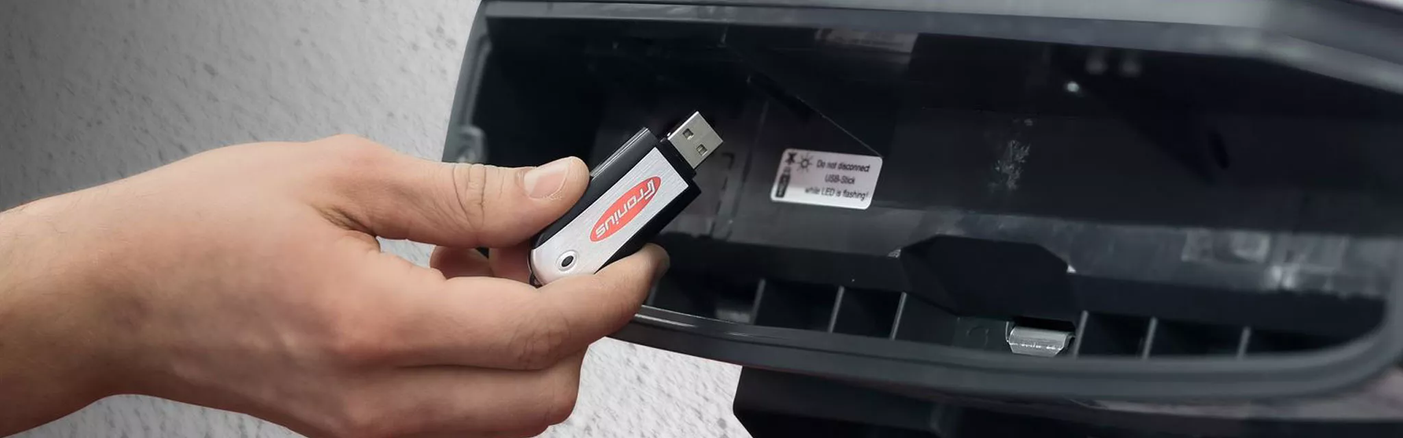

A USB firmware update is possible on the following Fronius inverters:
- Fronius Galvo
- Fronius Symo
- Fronius Primo
- Fronius Eco
- Fronius IG TL
For a USB update, proceed as follows:
- Download the required firmware file.
- Copy the froXXXXX.upd file onto an empty USB flash drive. The flash drive must be formatted with FAT32.
- Connect the flash drive to the USB port of the inverter.Note: Remove the lower, grey cover of the inverter.
- Start the update via the inverter display under "Setup" --> "USB" --> "Software Update".
- The currently installed firmware version and the new firmware version of the inverter will appear. Press Enter (far right key) again to start the firmware update.
Note: Do not remove the USB stick or disconnect the power supply during the update process!
