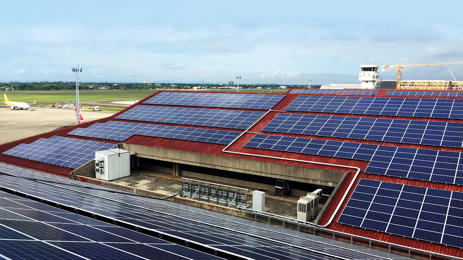

Solenergy Systems Inc. designs and constructs the first solar-powered airport in the Philippines
Mactan-Cebu International Airport is a major transport hub in the south for both domestic and international traffic. Its traffic is continually increasing and is now serving 850 commercial flights weekly transporting 13,049 passengers daily.
More than 6,300 PV modules are installed at the roof of the airport. The solar grid-tied system is expected to generate 2,169,900 kWh of energy per year that will offset a considerable amount of the daytime load peaks for the 2nd busiest airport in the Philippines. The 1.64 MWp PV-system is also calculated to save 1,301,580 kg of CO2 each year.
The system comprises 65 Fronius Symo 3-phase inverters, offering realtime online system monitoring and added safety functionality, such as arcand ground fault protection. The racking system was custom designed by Solenergy, with a cast in place ballast solution offering resistance to elevated wind speeds that are often experienced in the Visayas region. Solenergy also supplied a bespoke curtailment solution to enable the client to operate the PV system in parallel with their gensets, in case of brown out.
Installation data
Size of installation
1.64 MWp
System type
Roof-mounted
Module type and area
Risen Energy 265W on 1.01 hectares
Inverter
51 Fronius Symo 24.0-3-M; 14 Fronius Symo 15.0-3-M
Commissioned
August 2017
Annual yield 2,169,900 kWh
CO2 saved / year Approx. 1,301,580 kg
