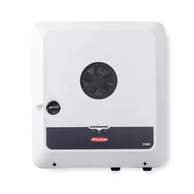

Fronius GEN24*
integrated basic backup power function
  • Primo (single phase) 3–6 kW
  • Symo (three phase) 3–10 kW
Fronius GEN24 Plus**
two backup power options/battery connection

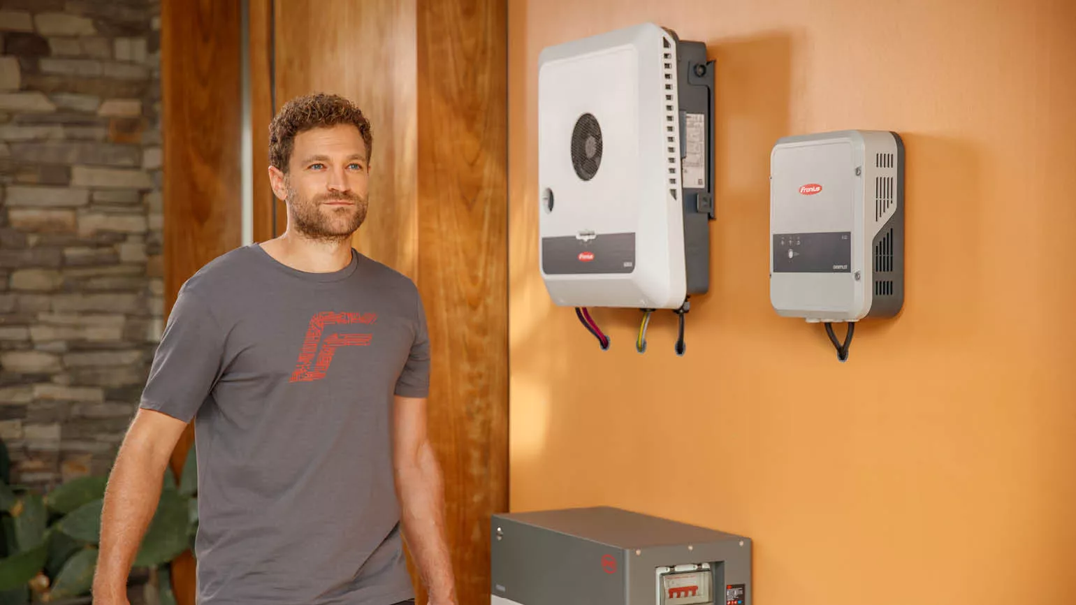

The inverter with flexible backup power options
Backup power for every situation
Your energy supply must be reliable. That’s why the Fronius GEN24 offers an integrated basic backup power supply. Backup power is supplied to connected devices up to 3 kW via the PV Point socket, as long as the sun is shining.
With the PV Point and Full Backup*, the Fronius GEN24 Plus offers two backup power options: a power supply for loads of up to 3 kW via a single socket and a backup power supply for the entire home, including large, three-phase loads such as heat pumps.
* The Full Backup option is not available for the Fronius Symo GEN24 3.0–5.0 Plus. For Full Backup, a battery and a switching device for safe grid disconnection are required in addition to the inverter.
