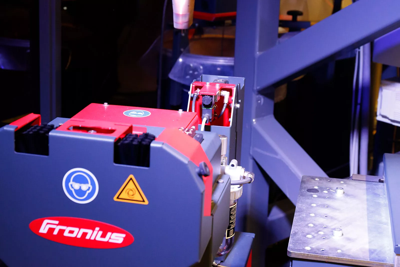

1. THE NEW TPS/i TWIN Push System

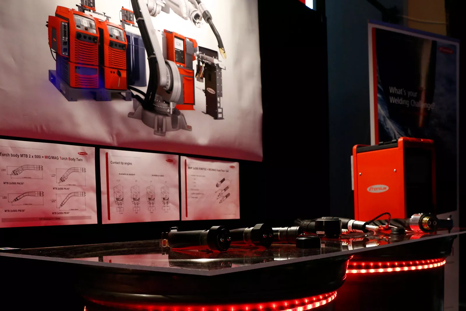

The new TPS/i TWIN Push System is now available with all TPS/i power sources. The whole TPS/i TWIN Push system, including a welding torch change station and a welding torch service station, will be available for purchase from May 2019.
Sales training will form part of the market launch. The training program is being offered as the sales department, as well as the technicians, need to be fully up to speed with the new system: The TWIN process features innovative process control that gives it exceptional stability and an extended process window. The newly developed TWIN welding torch has been specifically developed to give the very best performance thanks to its unique cooling system. The advantage of the TWIN wirefeeder is its compact design.

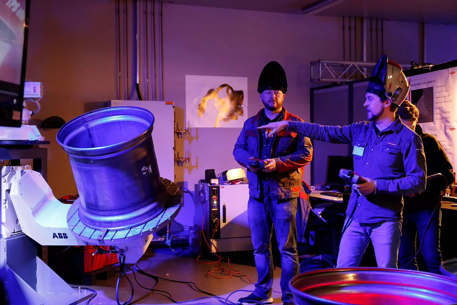

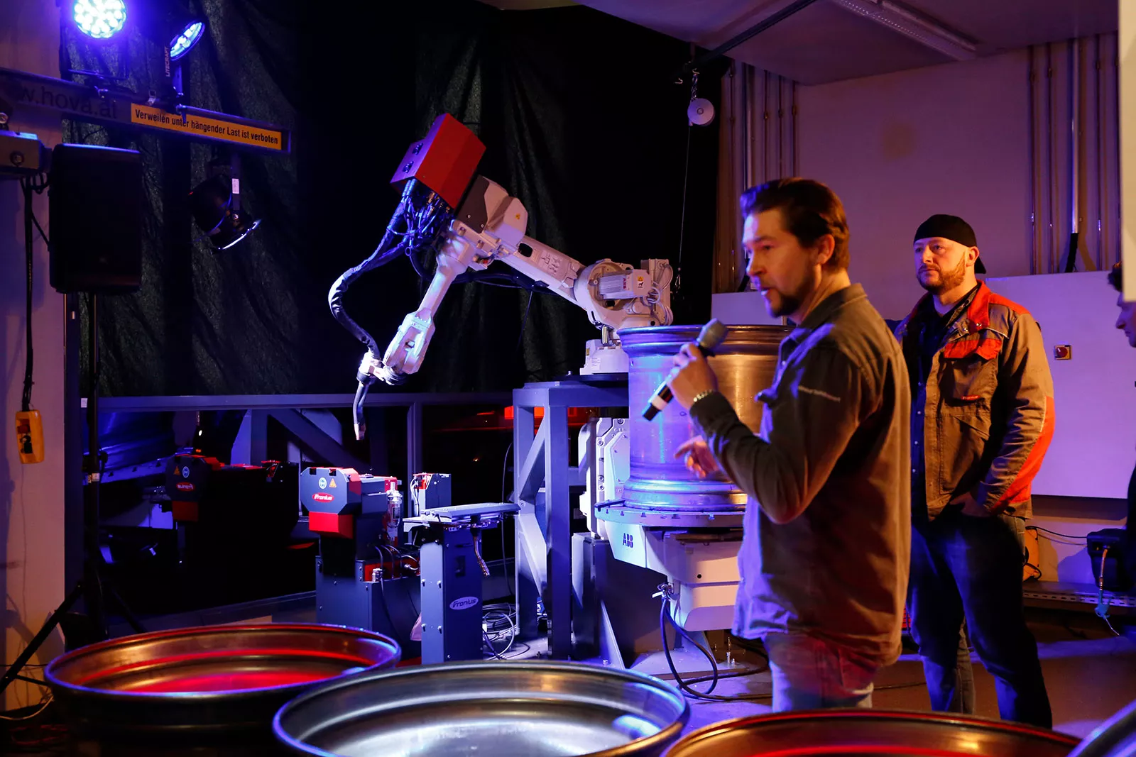

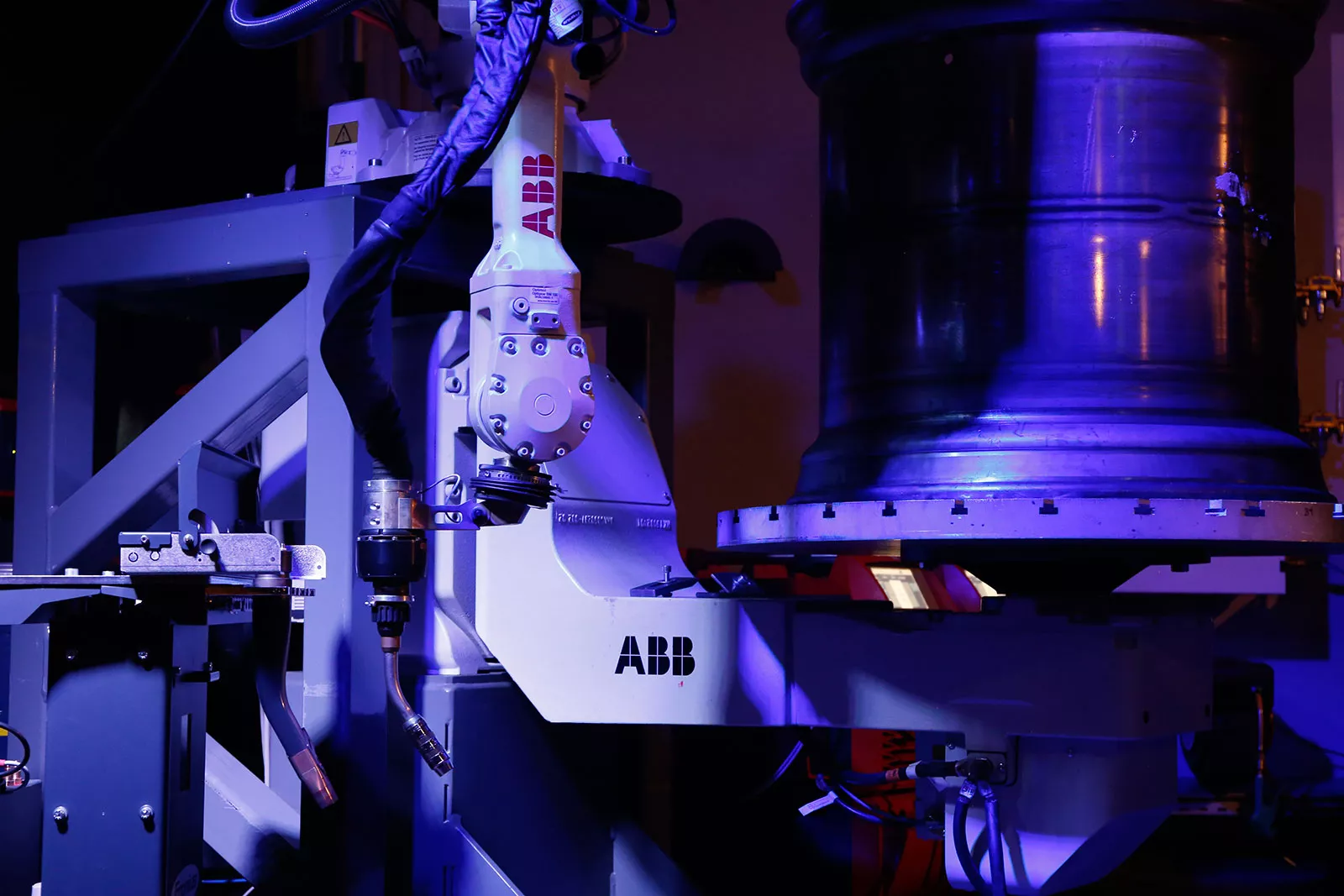

Huge harvester wheel rims were welded as part of a live demonstration. Two synchronous arcs (synchronized tandem process), an incredible deposition rate and a high welding speed – the raw energy released in the process is staggering!

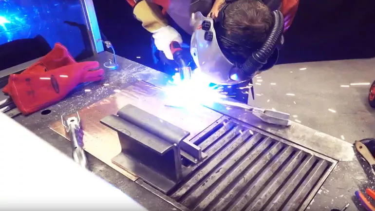

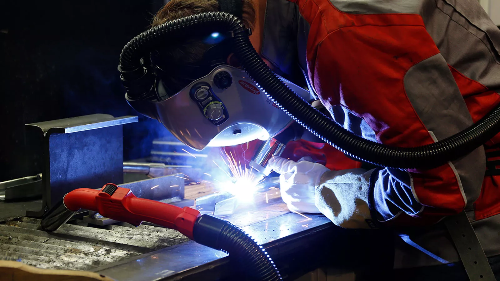

The advantages of the Pulsed Controlled Spray Arc characteristic (PCS) – such as a deep penetration profile – will be highlighted at the same time. These have been clearly demonstrated in various different trials, during which manual welding was carried out in two different settings. A fume extraction torch and a water-cooled welding torch were used.
