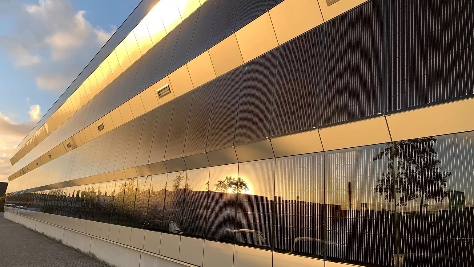

The PV system is mainly located on the roof but a very innovative futuristic BIPV facade of 75 kW has been installed in december of 2021.
Even though the installation was quite challenging due to the fact that the building has not a single support pole inside of it, therefore the building has long poles located in the walls with steel wires connected to the roof, our Fronius installer TULiPPs managed to install all inverters and every problem could be solved.
