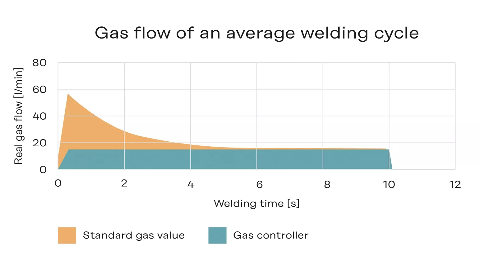

Not only is shielding gas expensive, it also requires a lot of energy to produce. Every liter we can save conserves resources, lowers emissions, and reduces our carbon footprint—which gives our customers a clear competitive edge. Our gas controller prevents the “blow-out” that typically occurs at the start of welding. Conventional systems will briefly consume up to 55 l/min even though only a much smaller amount is actually required. These spikes in gas flow add up to considerable costs that could be avoided, especially when tacking and working with lots of short welds.
Our solution is the intelligent Fronius gas controller, which immediately delivers the desired gas flow and maintains this level—without any losses. It also allows you to dose the gas depending on the power level or customize the amount for each individual welding job. So rather than using the highest amount of gas in all cases, you’re using exactly what you need to achieve perfect quality—weld by weld.
