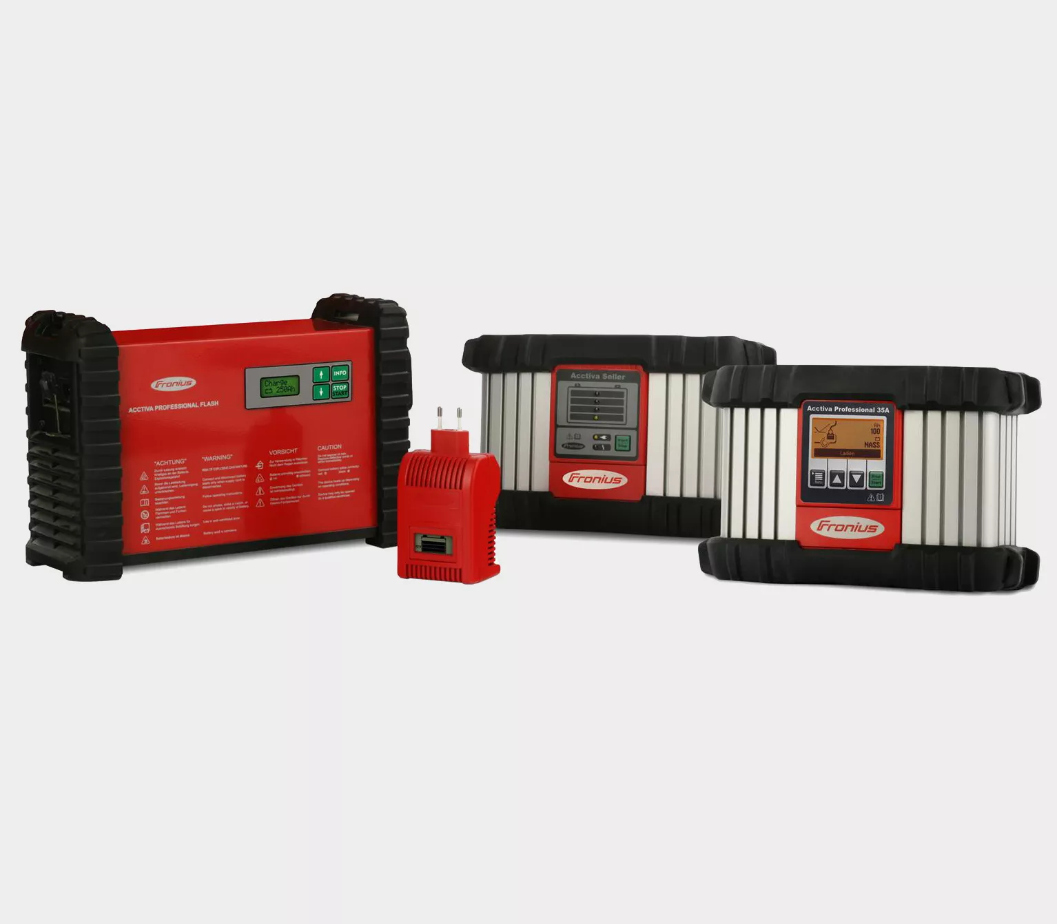

Fronius Acctiva: the perfect battery charging system for your starter battery every time
In addition to a range of different capacities, nowadays car manufacturers, dealers, workshops and drivers can also choose from a variety of battery technologies. The most appropriate battery charging technology must also be considered. Fronius Acctiva battery charging systems are suitable for all types of starter battery, thus providing a cost-effective, efficient and flexible solution for every application in the workshop or showroom. to the products
