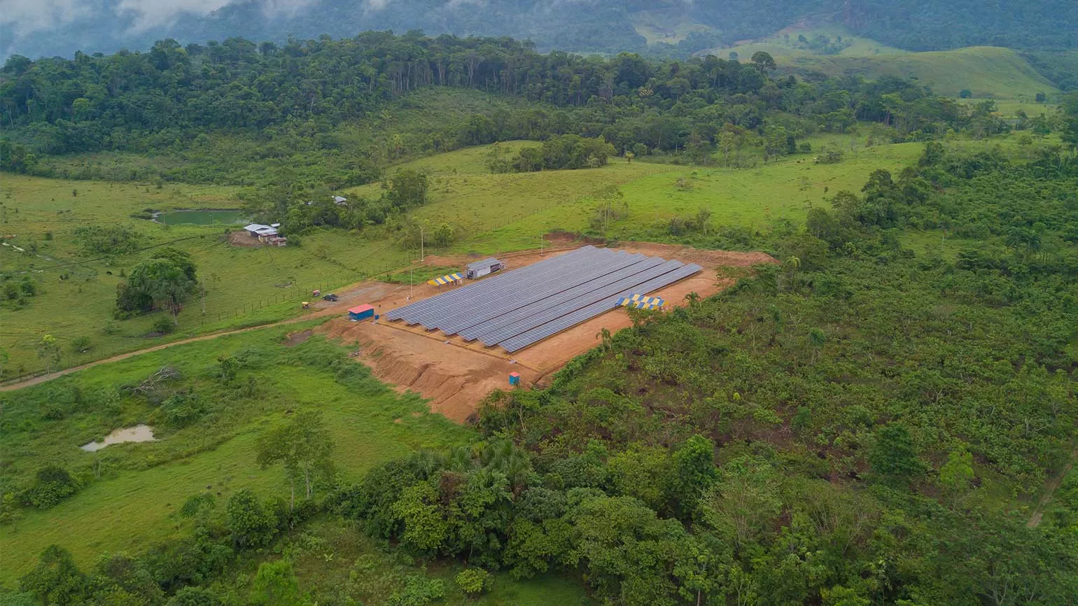

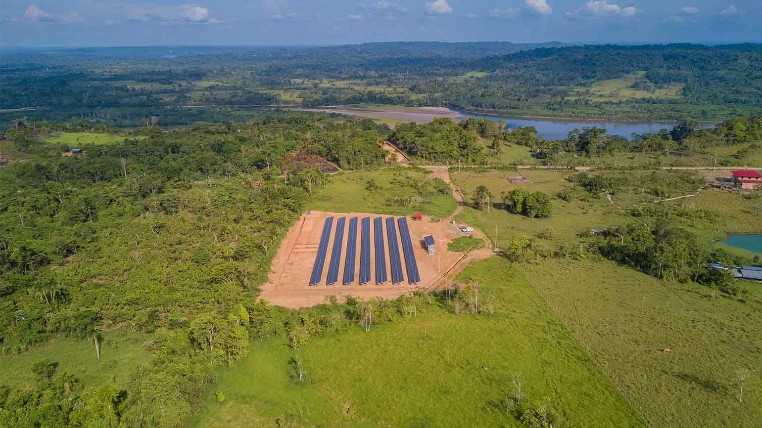

The town of Atalaya is one of the many isolated towns in Peru that are not connected to the main Peruvian electricity grid. The potential for solar energy in this region is enormous and so a 500 kWp solar power plant was commissioned in October 2020, providing clean energy to more than 12,000 inhabitants and enabling a stable and secure energy supply. The solar power plant will be coupled with an existing thermal power plant as well as a hydropower plant, making it the first intelligent PV-Genset solution installed in Peru.

The solar power plant was built jointly by local energy supplier Electro Ucayali and long-time Fronius System Partner Novum Solar, with the aim of permanently and reliably improving the town’s energy supply.
The new PV system will generate approximately 650,000 kWh of energy every year. It is estimated that this will save 193.5 metric tonnes of CO2 annually and 4,837.5 metric tonnes of CO2 over its lifetime. The town is thus making a major contribution to sustainable energy production and combating climate change.

Atalaya is becoming a pioneer in power generation with the smart PV-Genset. The solar power plant is connected to the existing hydropower plant and thermal power plant, ensuring a reliable and cost-effective power supply. Thanks to an intelligent control system, the use of solar energy is prioritised in the PV-Genset system.

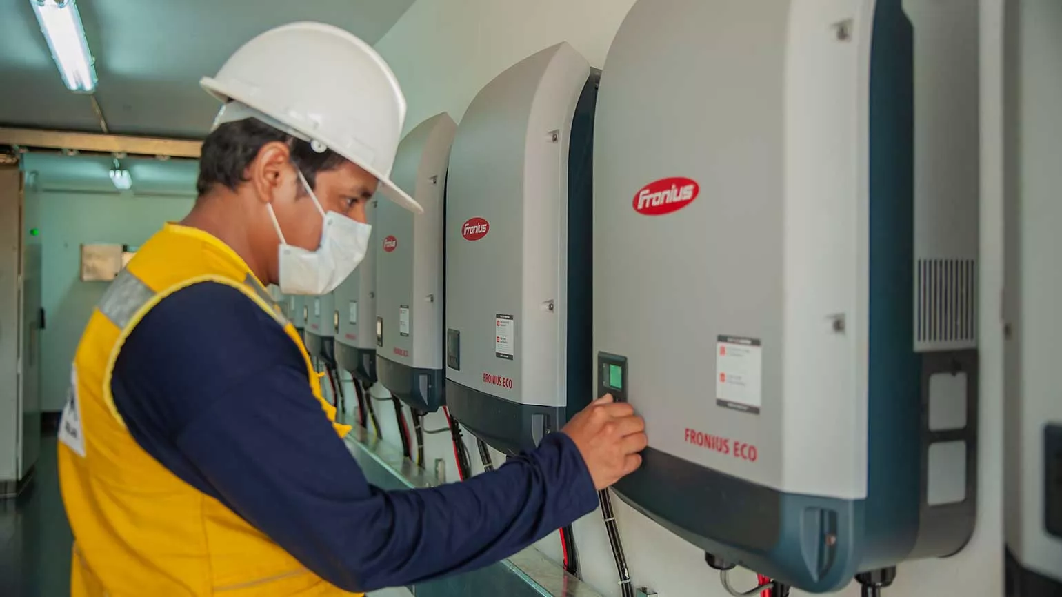

The PV system consists of 14 Fronius Eco inverters and 1,260 solar modules, all managed by a control system from Elum. This controls the entire system and ensures that all energy flows between the generators and the loads are coordinated.

Fronius components
14 x Fronius Eco
