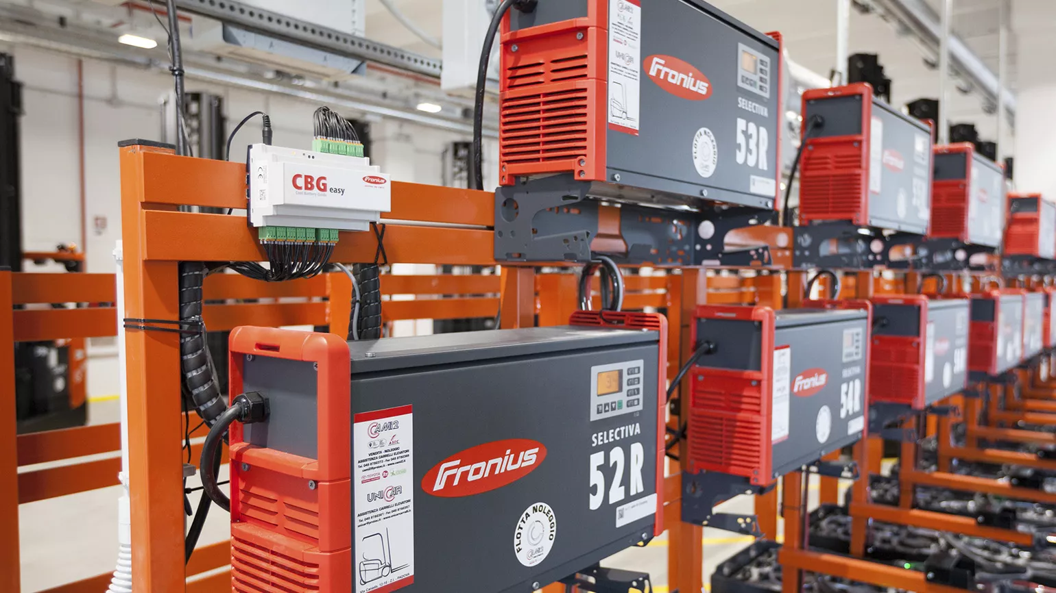

In order to ensure that the charge carriers are efficiently and reliably supplied with energy, the company chose to use innovative battery charging technology from Fronius on the recommendation of Cami2 S.r.l., sales partner of Toyota, who maintains the entire intralogistics system. The specialist also installed the Cool Battery Guide Easy information and management system for Alì. This system improves the utilisation of the battery pool significantly. A control unit processes the data from the individual chargers and uses a blue LED strip on the device to show which battery has been fully charged the longest and is therefore the coolest. “In this way, our employees are intuitively guided to the right battery,” confirms Canola. “This prevents some batteries being used continuously and others being used less often. Using all of the batteries equally ensures that they maintain their capacity for as long as possible.” This is also beneficial for the distributor, Toyota, who provide the rental devices, as it means that the expensive charge carriers require less maintenance work and need to be replaced less often.

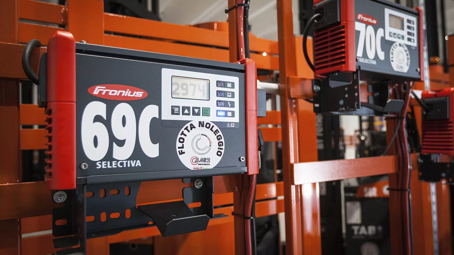

The battery charging room is equipped with a total of 44 Selectiva chargers with power ratings of 2kW and 8kW. Thanks to the Ri charging process developed by Fronius, these are particularly frugal in their power consumption and are gentle on the batteries. “Conventional processes often lead to overcharging, which causes the battery to overheat,” explains Davide Miotello, National Sales Manager at Fronius Italia. “This has a negative effect on both the capacity and the service life of the battery – the Ri charging process therefore helps to avoid high maintenance costs and low fleet availability.”
