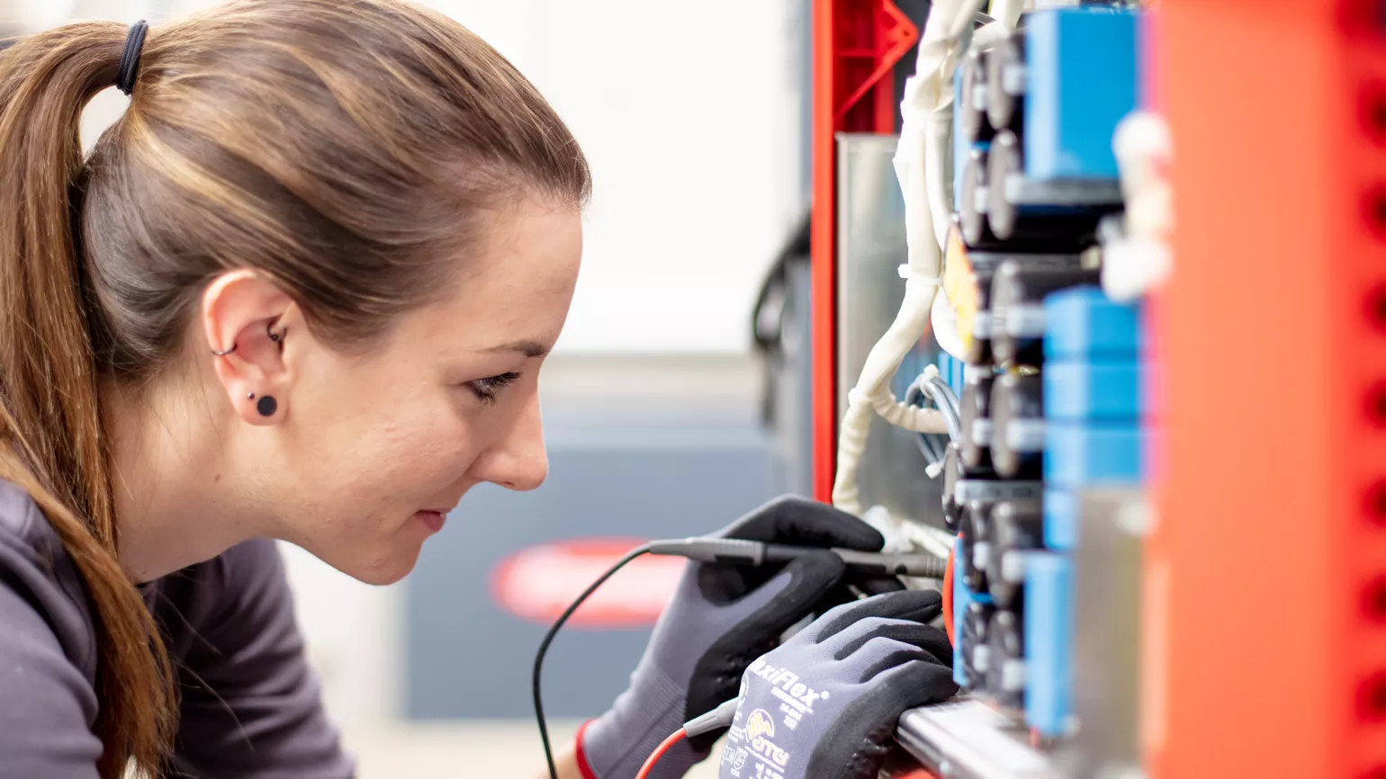

The inspection by our Fronius technicians includes the following steps:
/ Cleaning (internal cleaning of the device, removal of metal dust)
/ Visual inspection (condition, damage, labels, fuses, etc. )
/ Mechanical inspection (housing, covers, mounting, cables, etc.)
/ Electrical safety check (measurements according to IEC 60974 - 4)  Germany: section 5 of the DGUV Vorschrift 3, Austria: ÖVE/ÖN 8701-1, Switzerland: SR 832.30 section 32b
/ Check for correct functioning (manufacturer's specifications or state of the art)
Labeling with a test label
