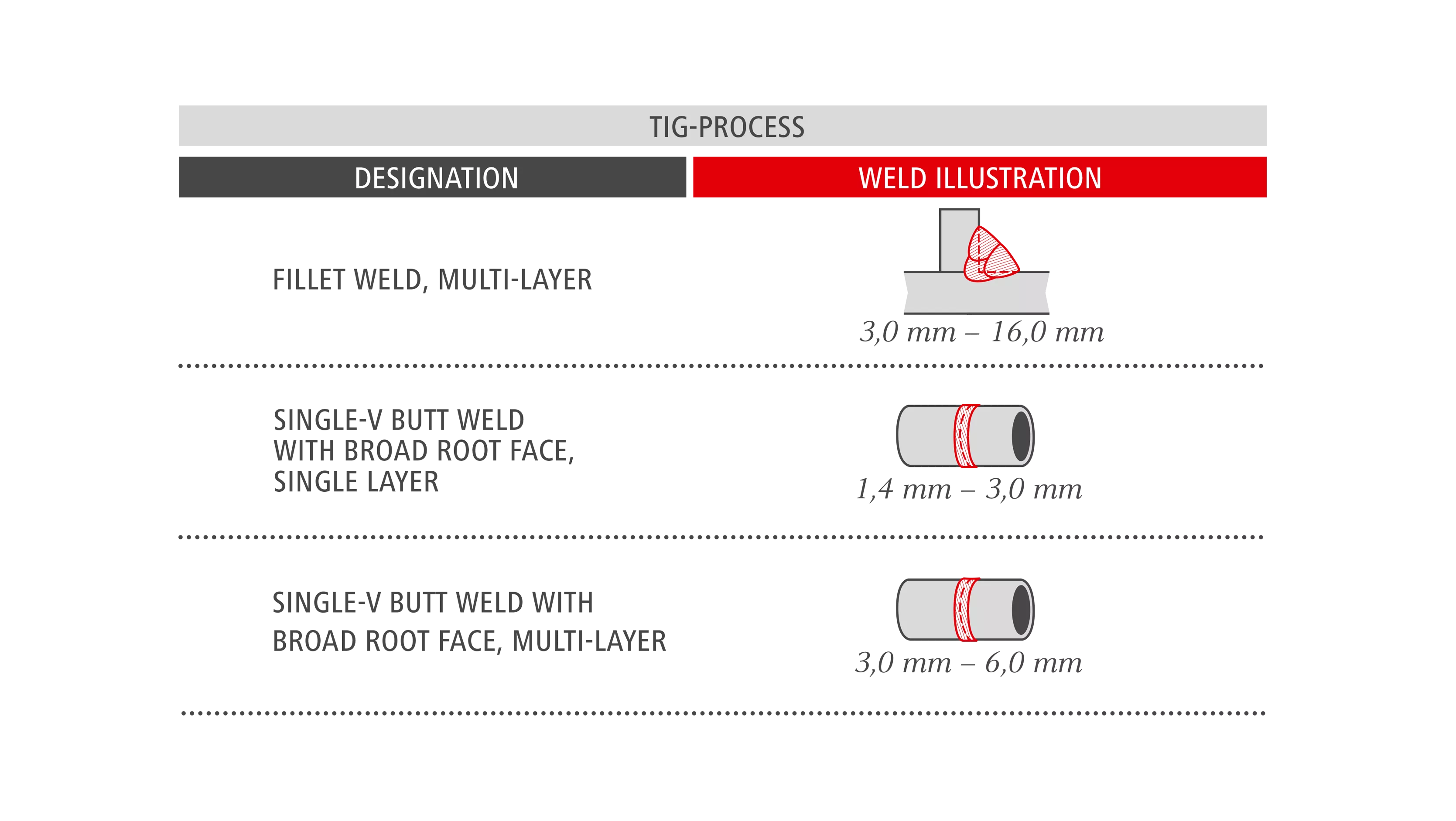

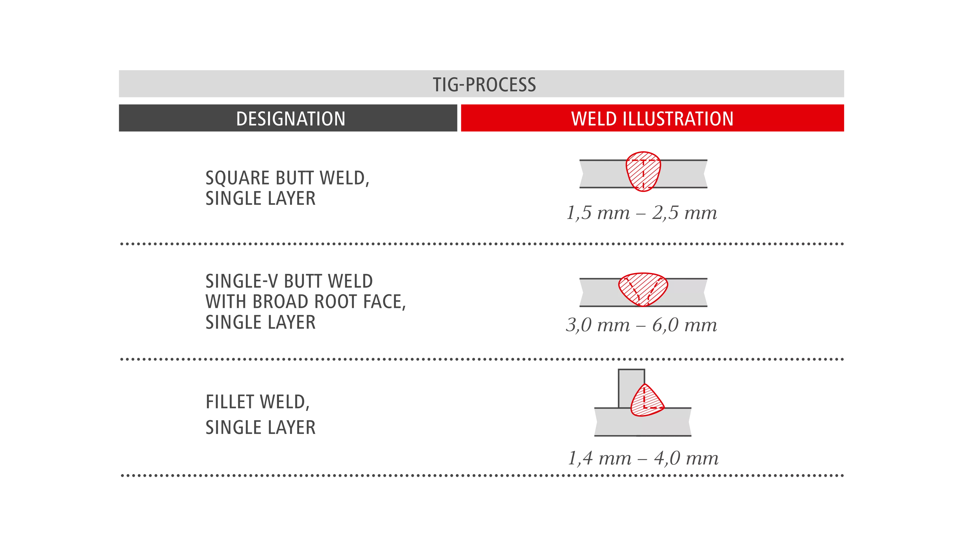

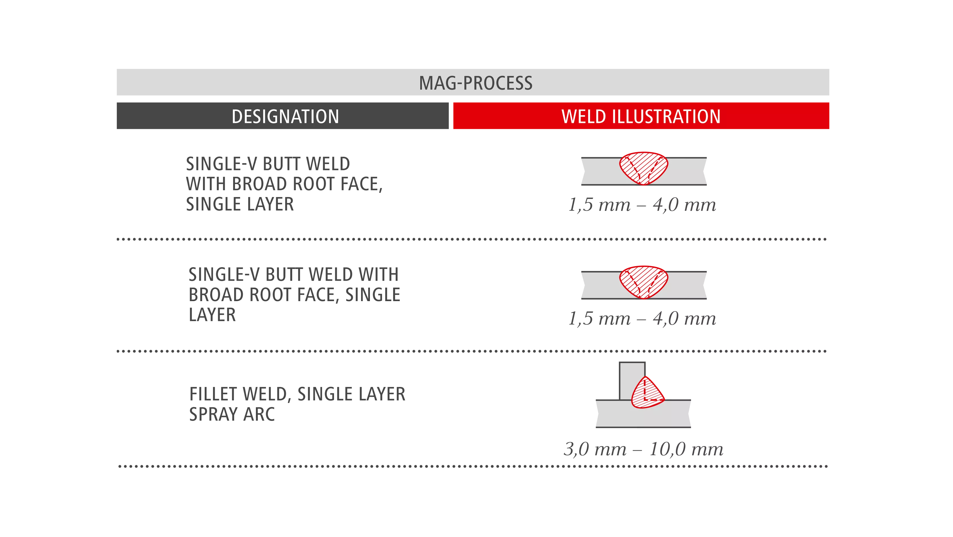

The WPS package CrNi includes 50 welding procedure specifications for manual TIG and MAG CrNi applications.
included welding instructions
  • TIG + MAG process
  • Material group: 8.1 (1.4301, 1.4541,1.4550, 1.4401, 1.4571)
  • Filler material: CrNi 19 9 / 18 12 3
  • Sheet thickness range 1.4 mm to 16 mm
  • All welding positions(except PG and J- L045)

  • MAG spray arc
  • MAG pulsed arc

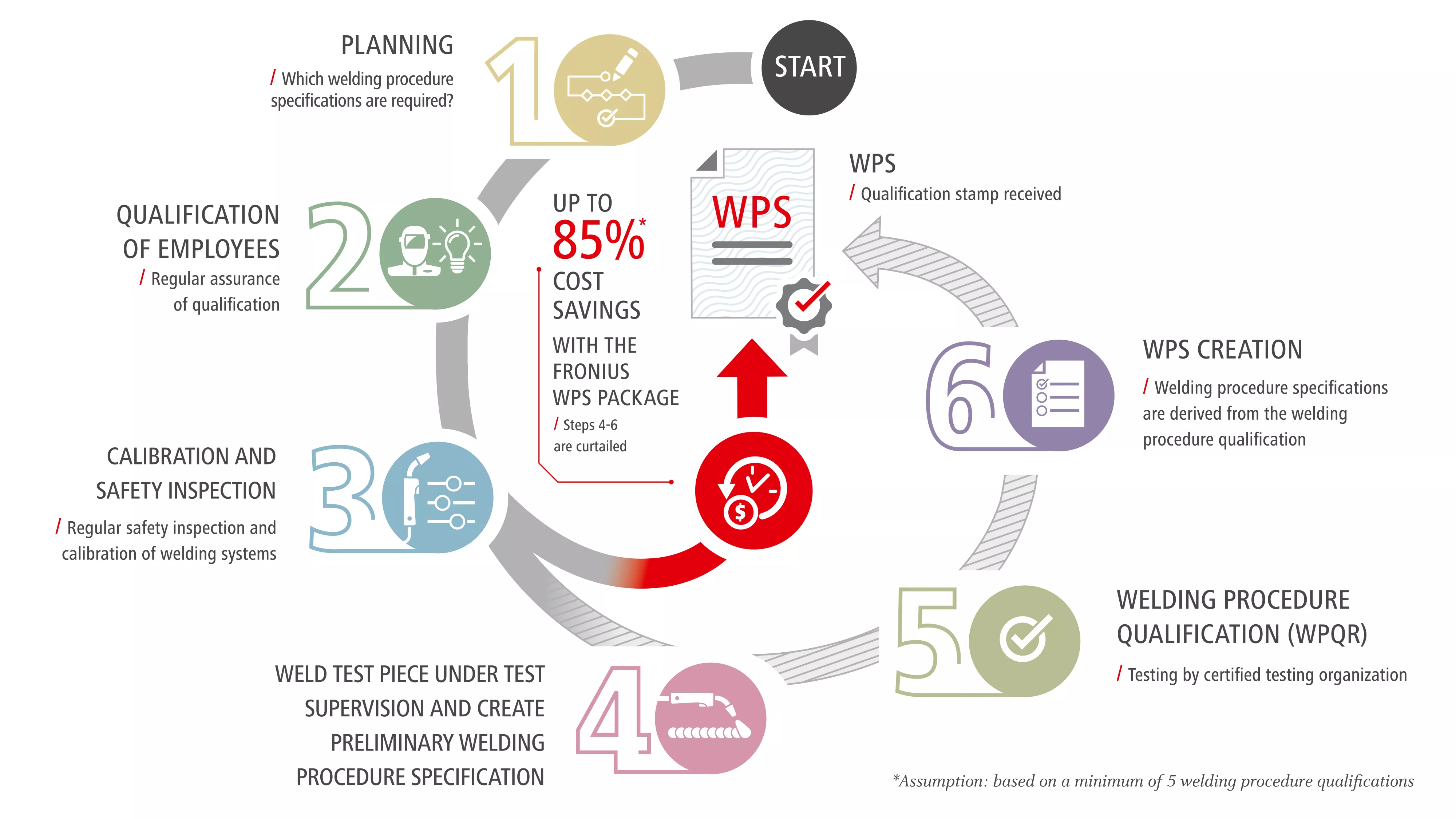

CREATING THE FINISHED WELDING PROCEDURE SPECIFICATION
SINCE EN 1090 CAME INTO FORCE IN 2014,FACTORY PRODUCTION CONTROL (FPC) IS REQUIRED FOR WELDEDCONSTRUCTIONS OF ALL EXECUTION CLASSES.
This FPC demonstrates that appropriate welding procedure specifications(WPS) are in place at the workplace and work is carried out in line with them.
"While the entire process in steps 1 through 3 requires a great deal of planning work,the cost of qualifying the processes in step 4 is huge, especially for small and medium-sizedenterprises. This is where Fronius comes in by offering ready-made and cost-effective WPSpackages for manual steel and CrNi applications. The organizational costs associated with weldingprocedure qualification, which would be necessary to create the welding procedure specifications, arecompletely eliminated."
