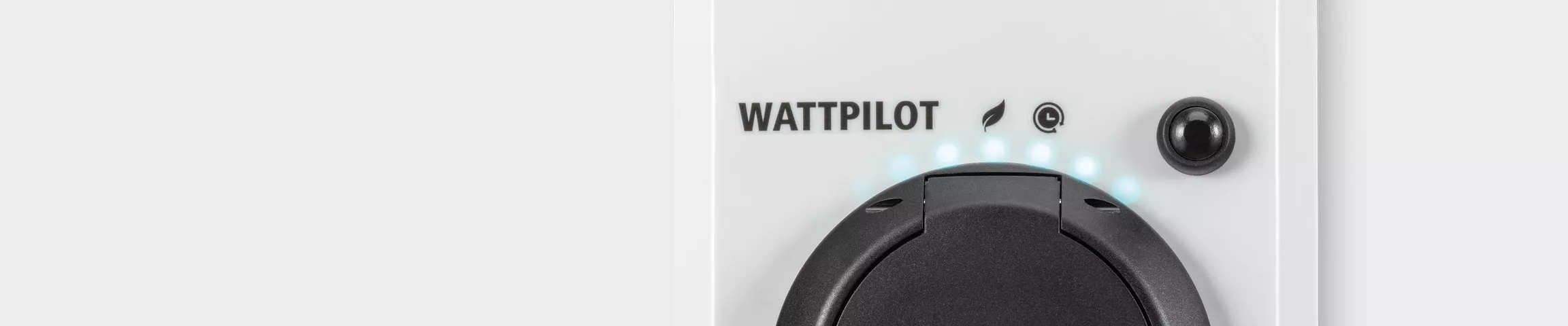

The LEDs provide information on the charging current, the type of charging (1-phase or 3-phase), installation of an update, etc.
