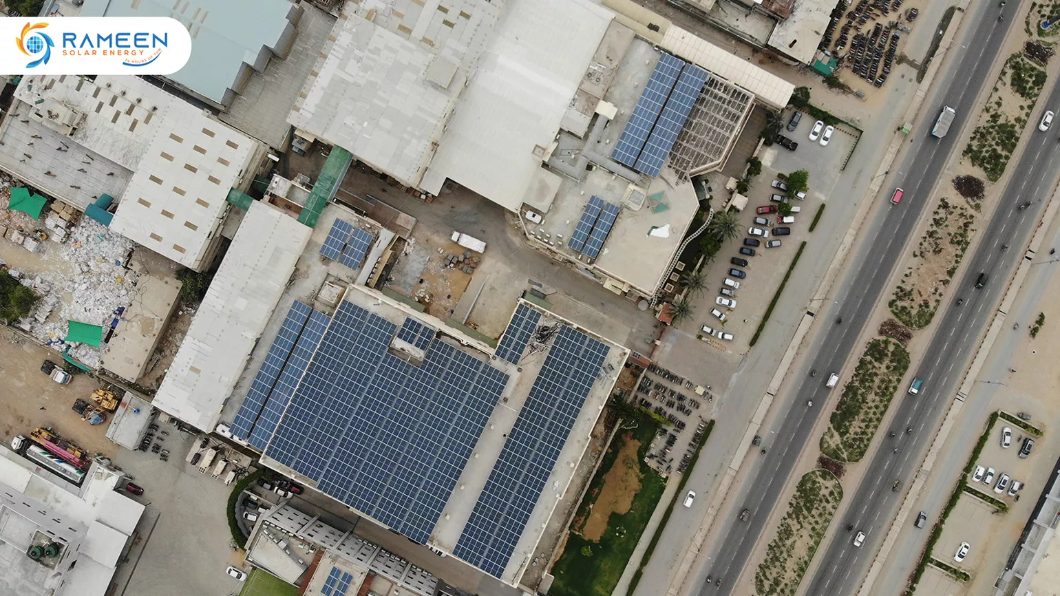

With a 370 kW rooftop installation at Mehran Foods and Spices, Rameen Renewables Pvt Ltd. has installed its first Fronius Tauro project in Pakistan.

Location: Mehran Foods and Spices, Karachi, Pakistan
Size of installation: 370 kW
Inverters used: 3 x 100 kW Fronius Tauro Eco - Direct Variant
Annual Production: 519.5 mWh
Module type & surface: Canadian Solar 54 W on a surface of 2363 m²
Self-sufficiency rate: 34 %
Installer: Rameen Renewables Pvt Ltd.
