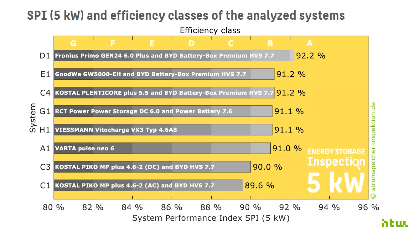

With an unbeatable System Performance Index of 92.2%, the new Primo GEN24 6.0 Plus, together with the BYD Battery-Box Premium HVS 7.7 secured first place in the 5kWp category.

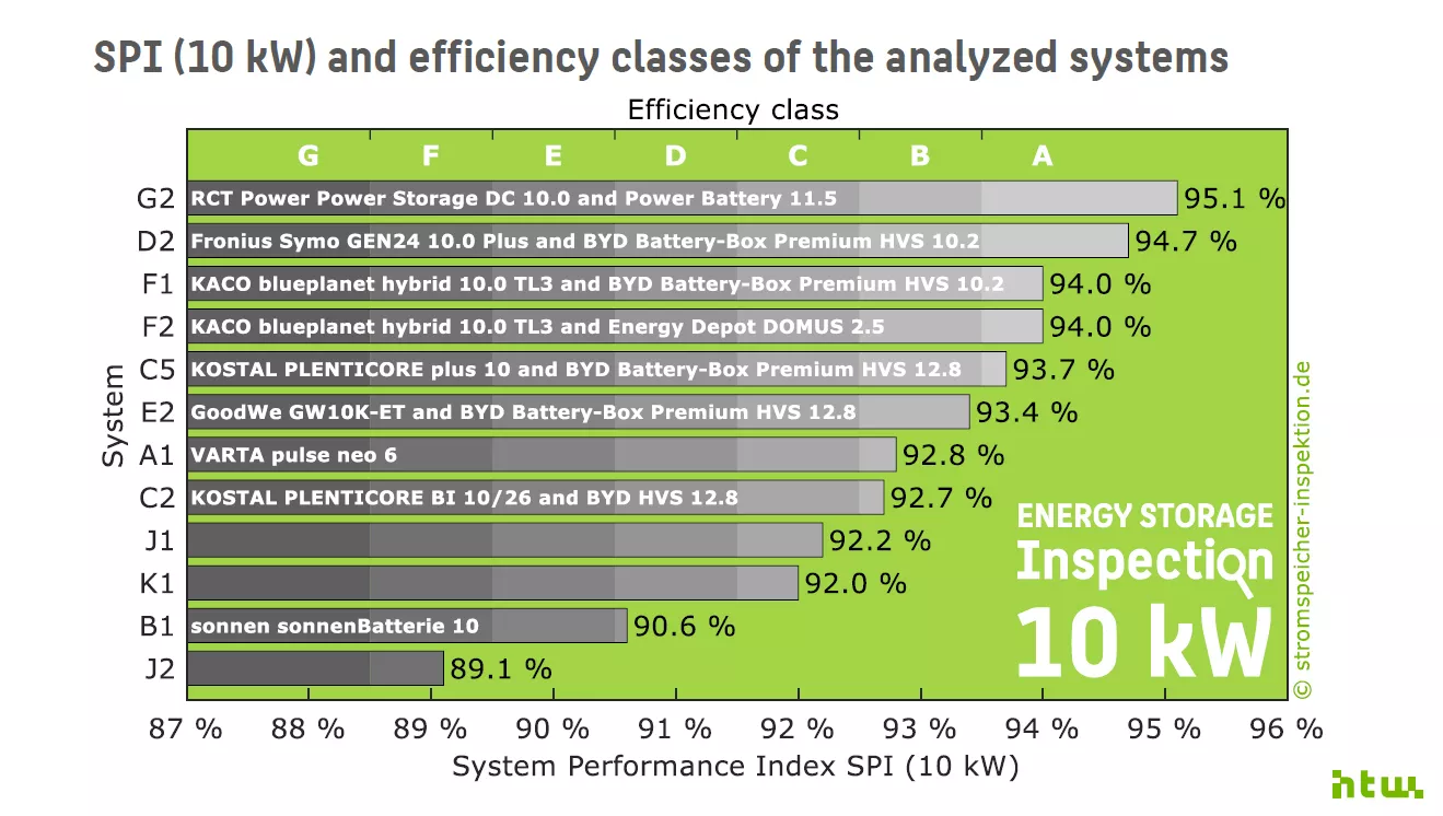

At the same time, the Symo GEN24 10.0 Plus with the BYD Battery-Box Premium HVS 10.2 was able to improve on its showing from last year with a system performance index of 94.7% (2nd place).

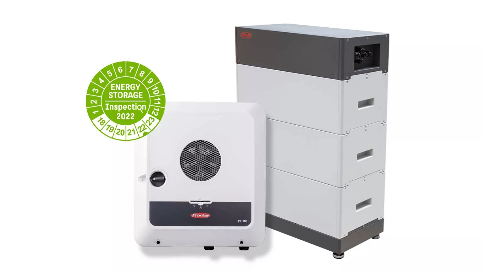

With the GEN24 Plus series and the BYD Battery-Box Premium, Fronius is also the only manufacturer to offer a complete system in the highest efficiency class A in both reference cases.

Two different reference cases were used for the evaluation. The first analyzed the SPI (System Performance Index) of a 5 kWp PV system with an annual household consumption of 5,010 kWh/a, while the second reference case combined a 10 kWp PV system with a heat pump (2,664 kWh/a), an electric car (1,690 kWh/a), and an annual household consumption of 5,010 kWh/a.
