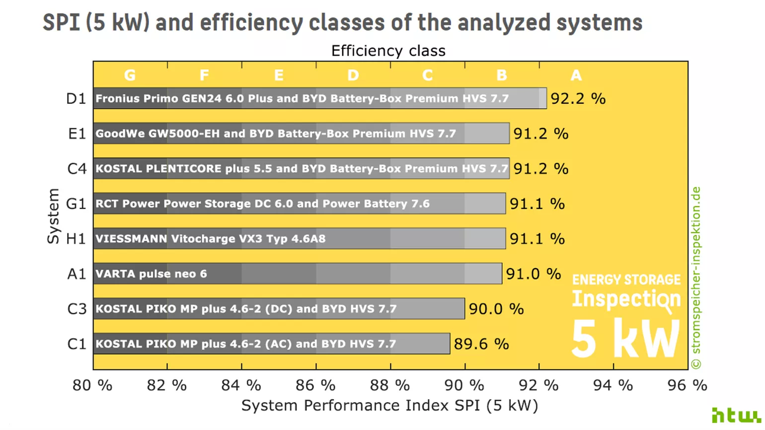

Fronius achieved top rankings for the third time in a row in the annual Energy Storage Inspection by the Berlin University of Applied Sciences (HTW). First place went to the Fronius Primo GEN24 6.0 Plus in the 5 kWp power class, while the Fronius Symo GEN24 10.0 Plus came in second in the 10 kWp power class. Fronius was also the only inverter manufacturer to achieve energy efficiency class A with both products.
The Energy Storage Inspection conducted by HTW Berlin is an industry-wide study carried out annually by independent institutes to compare photovoltaic storage systems for private households. This year, the competition saw 19 energy storage systems from 14 manufacturers go up against each other. They were evaluated with the System Performance Index (SPI), an independent evaluation method that provides a good reference for installers and end customers in their search for energy-efficient storage solutions. And the results are impressive: the system’s high efficiency means less energy is lost, which in turn leads to higher yields and consequently to a faster return on investment

A in both power classes The highest SPI in the 5 kWp power class was achieved by the Primo GEN24 6.0 Plus together with the BYD Battery-Box Premium HVS 7.7. Coming in at 92.2 percent, the PV storage system stands a full percentage point ahead of the runner-up. In the 10 kWp power class, the Symo GEN24 10.0 Plus with the BYD Battery-Box Premium HVS 10.2 achieved an SPI of 94.7 percent. “With the GEN24 Plus series, we were the only manufacturer to achieve energy efficiency class A in both power classes,” explains Susanne Lampl, Product Manager at Fronius International, with pride.

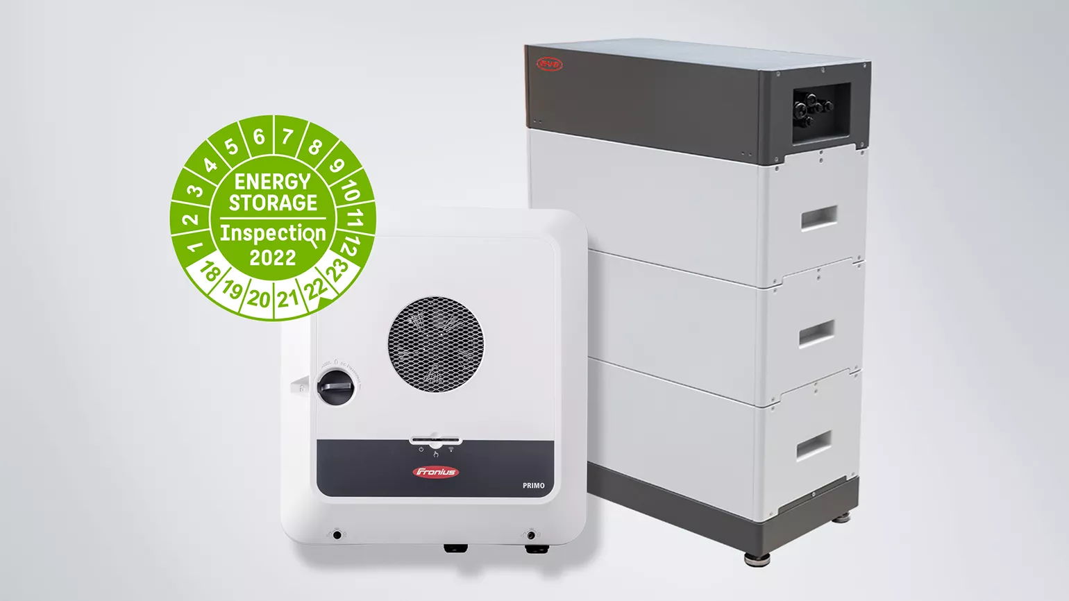

Fronius secures first place in the HTW Energy Storage Inspection for the third time in a row.
The high system efficiency means a faster ROI.
Susanne Lampl, Product Manager, Business Unit Solar Energy, Fronius International GmbH.
