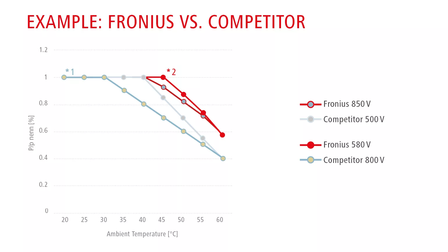

A frequently quoted rule of thumb is as follows:
“With every 10 °C rise in temperature, the service life is reduced by roughly half.”
1* Passive Cooling,[object Object],2* Active Cooling
Optimisation of yield through active cooling
In order to avoid overheating of the electronic components, there is a so-called “derating” function – a controlled power reduction. With actively cooled inverters, the cooling effect caused by the fans is much stronger than with a passive cooling system, where greater yield losses are unavoidable.
As can be seen in the diagram, the passively cooled inverter switches to power derating at ambient temperatures of 30 °C, while the actively cooled Fronius inverter only starts this process from 40 °C.
