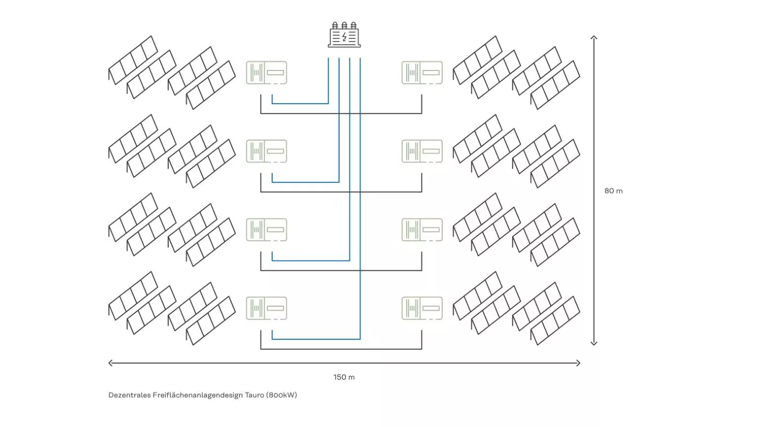

Direct (D)
  • For a decentralised system design and direct connection of the strings to the inverter
  • In a system with a decentralised design, the inverters are placed right next to the PV module array. In doing so, larger distances are covered using AC cables.

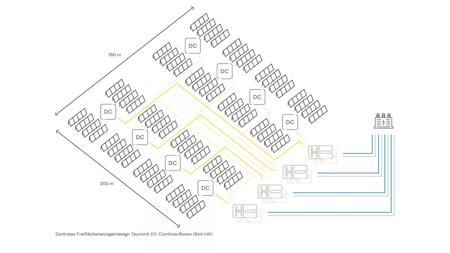

Precombined (P)
  • For a centralised system design in which the strings are connected to the Fronius Tauro via DC combiner boxes
  • In a system with a centralised design, the inverters are placed close to the transformer or main distributor and connected via DC string combiner boxes. The AC cable routes from the inverters to the transformer are therefore much shorter than in a decentralised system design. The larger distances from the inverters to the DC string combiner box and from there to the PV modules are covered using DC cables.

In a system with a centralised design, for example a photovoltaic system with the Tauro Precombined, all inverters are placed together close to the main distribution board or transformer (this could be approx. 10-15 metres). This means that it is possible to cover the cable distances from the string combiner boxes up to the inverters using cables with a cross section of 95 mm2. Thin AC cables can be selected according to the cable length and output.
In addition to easy handling, the large-scale use of cables measuring 95 mm2 leads to a considerable cost saving. Roughly €1000 can be saved with a 500 kWp photovoltaic system equipped with this cable type.*

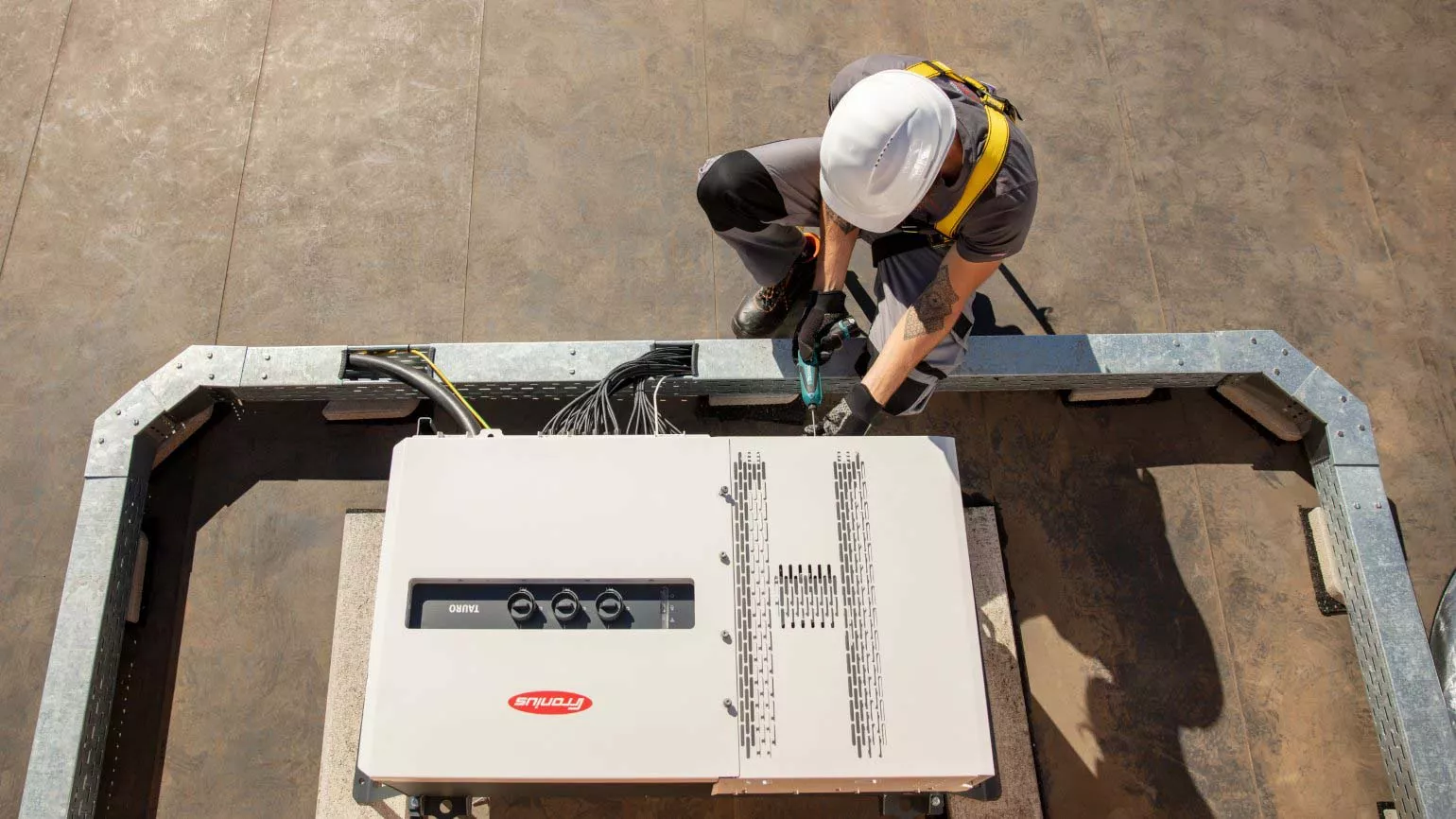

The centralised system design of the Tauro Precombined means that all inverters are very close to one another and placed near the main distribution board or transformer. This results in easier maintenance of the photovoltaic system, as all inverters are placed together in one location and are therefore easier to access than if they were distributed over a large area.

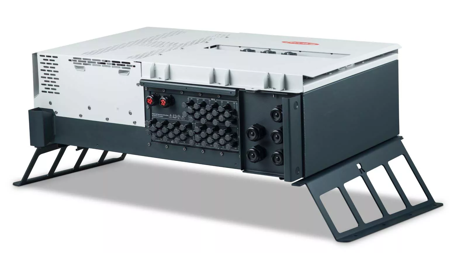

The Fronius Tauro Precombined is equipped with two separate DC disconnectors. These can be deactivated individually on the device. If servicing is required, only the string that is currently being worked on is deactivated. The second string continues to function as usual. The advantage here is that during maintenance work on the strings, very little yield is lost. Production losses can be halved in this way using the Tauro. Considering that such work can sometimes take several hours or up to an entire day, this represents a major financial advantage.
