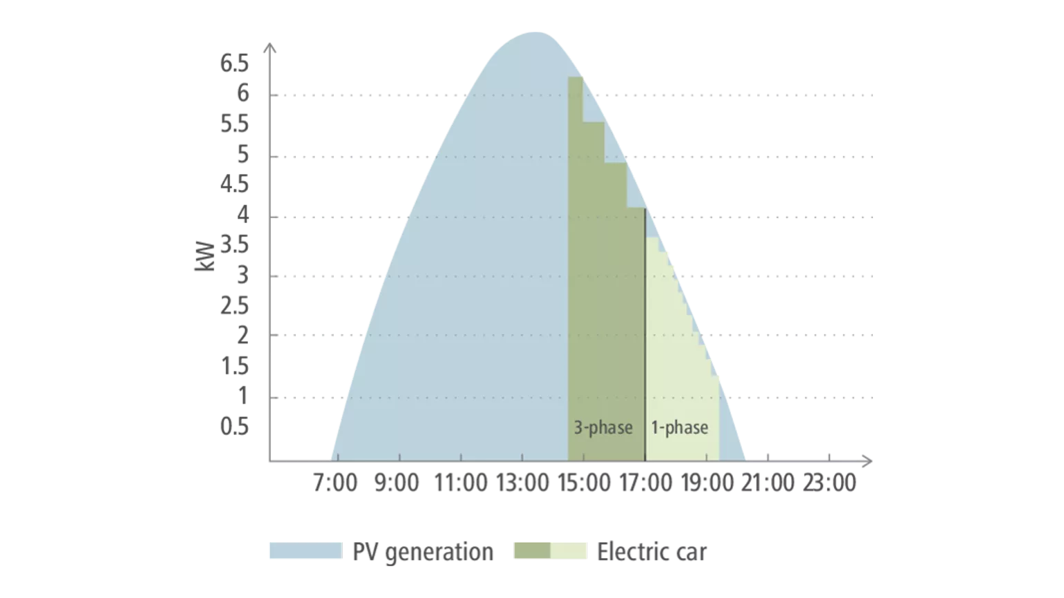

How dynamic PV surplus charging works
A starting power level and 3-phase power level can be defined for dynamic PV surplus charging.
The starting power level specifies the surplus amount that the photovoltaic system needs to reach before the Wattpilot begins charging the car.
The 3-phase power level is the surplus value that needs to be reached by the photovoltaic system to switch from1-phase to 3-phase charging. The figure shows the example of a starting power level of 1.38 kW and a 3-phase power level of 4.14 kW. If the PV surplus is between 1.38 and 4.14 kW, the Wattpilot regulates the charging power in 230 Watt steps. If the PV surplus exceeds 4.14 kW, the Wattpilot will switch from 1-phase charging to 3-phase charging in 690 Watt steps.

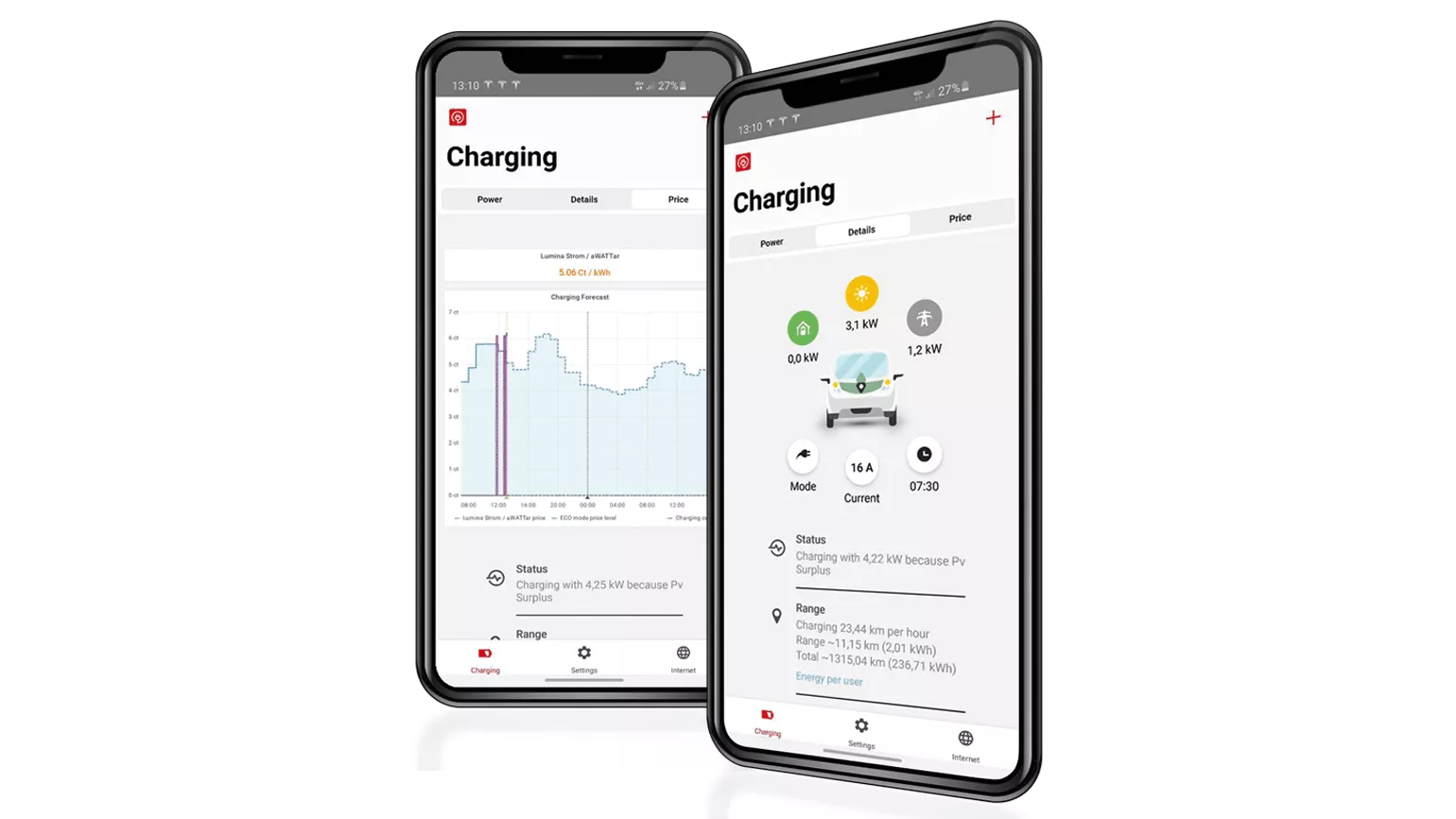

When charging an electric car, there are two different charging modes to choose from: Eco Mode and Next Trip Mode. Eco Mode is the ideal charging mode for PV system owners. Here, PV surplus is prioritized for charging the electric car. If there is also a variable energy tariff, the low-cost green power tariff from the grid will be used for the remainder of charging.
Next Trip Mode is used to refuel with energy for a specific route. Electric car drivers enter the exact distance and time of the next journey via the Solar.wattpilot app. Targeted charging is then completed to the required energy level right up to the defined, desired distance.
Charging is even easier with your own app
The Solar.wattpilot app makes the charging solution easier to commission and operate. Several functions, including charging modes, can be adjusted via the app. Charging with PV surplus and limit values in combination with other loads, such as a battery or the Ohmpilot, can also be activated and adjusted in the app under the “Cost optimization” function.
