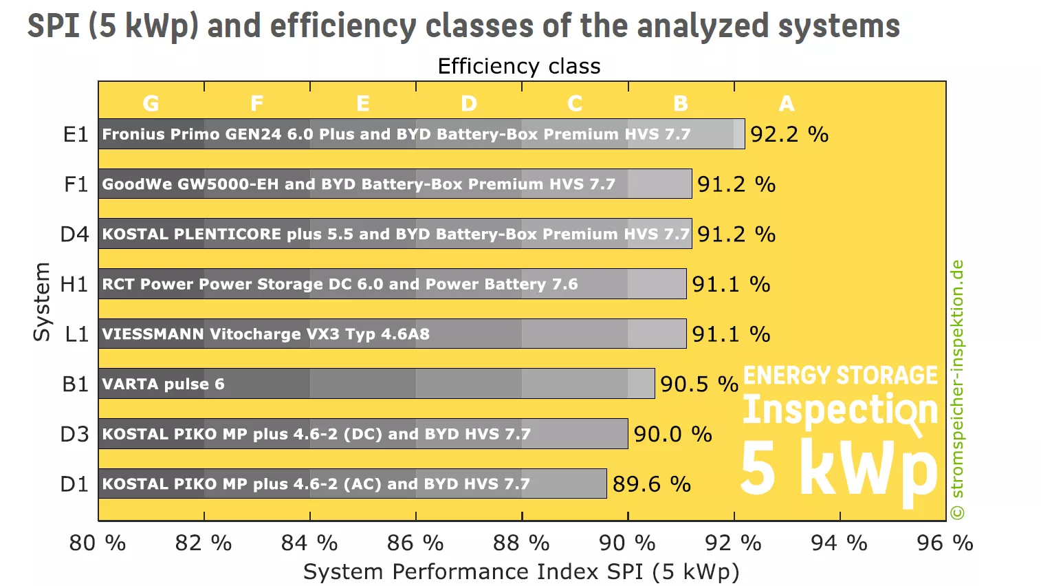

With an unbeatable System Performance Index of 92.2%, the new Primo GEN24 6.0 Plus, together with the BYD Battery-Box Premium HVS 7.7 secured first place in the 5kWp category.

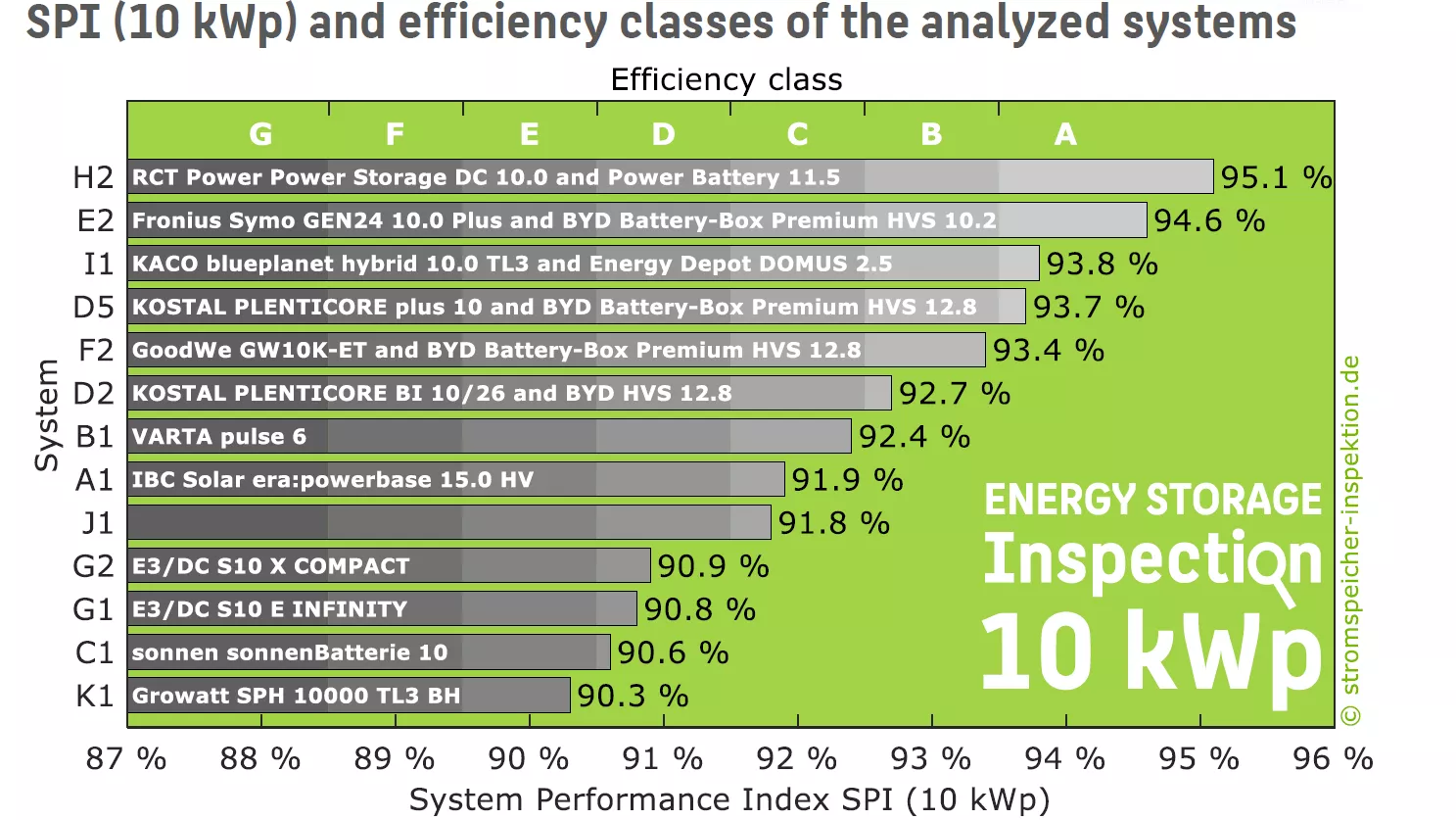

At the same time, the Symo GEN24 10.0 Plus with the BYD Battery-Box Premium HVS 10.2 was able to improve on its showing from last year with a system performance index of 94.6% (2nd place).

Independent testing institutes tested the overall efficiency of home storage systems, analyzing the interaction of PV systems and battery storage.
Two different reference cases were used for the evaluation. The first analyzed the SPI (System Performance Index) of a 5 kWp PV system with an annual household consumption of 5,010 kWh/a, while the second reference case combined a 10 kWp PV system with a heat pump (2,664 kWh/a), an electric car (1,690 kWh/a), and an annual household consumption of 5,010 kWh/a.
