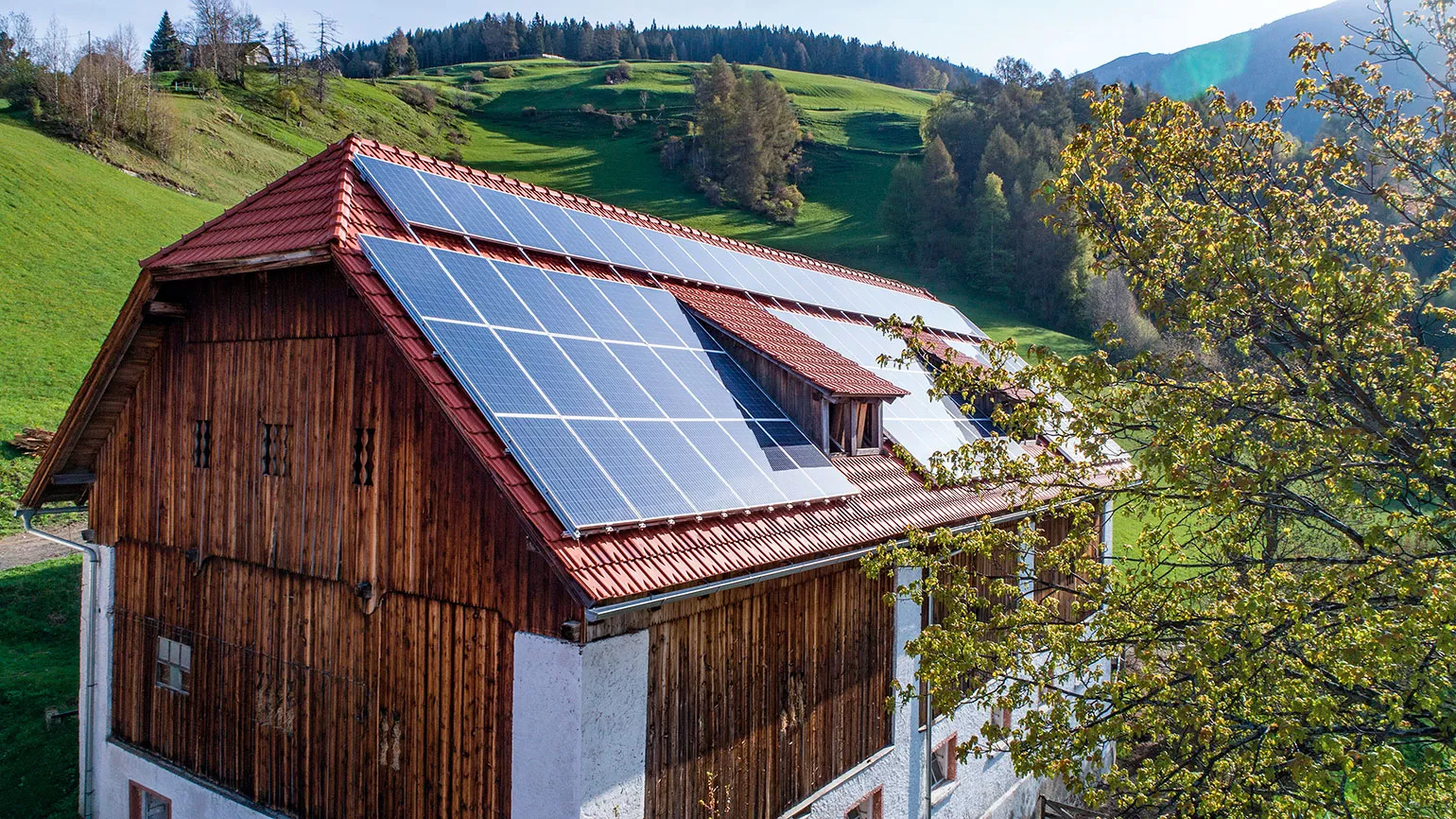

Bernhard Mölschl shows how the combination of intelligent load management and thermal storage works in practice. Together with his family, he lives in his lovingly renovated childhood home. Lying at 1385 metres above sea level, the house enjoys fantastic views of the surrounding High Tauern National Park. As a self-employed electrical engineer, Mölschl decided to put the latest technical innovations through their paces in his own home. He also knows that maximising his rate of self-consumption is a very attractive prospect from an economic perspective – which he has achieved by combining the Fronius Ohmpilot thermal storage solution with the intelligent home control system Evon Home.

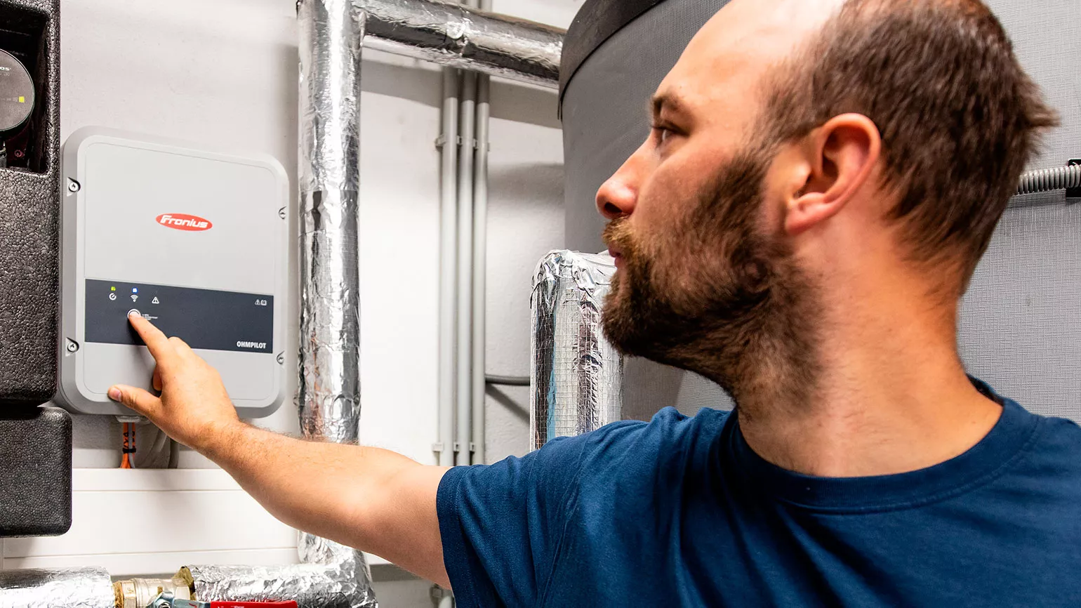

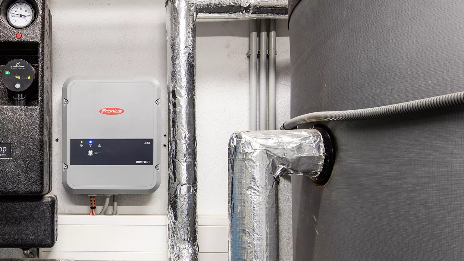

GREATER INDEPENDENCE WITH THE FRONIUS OHMPILOT

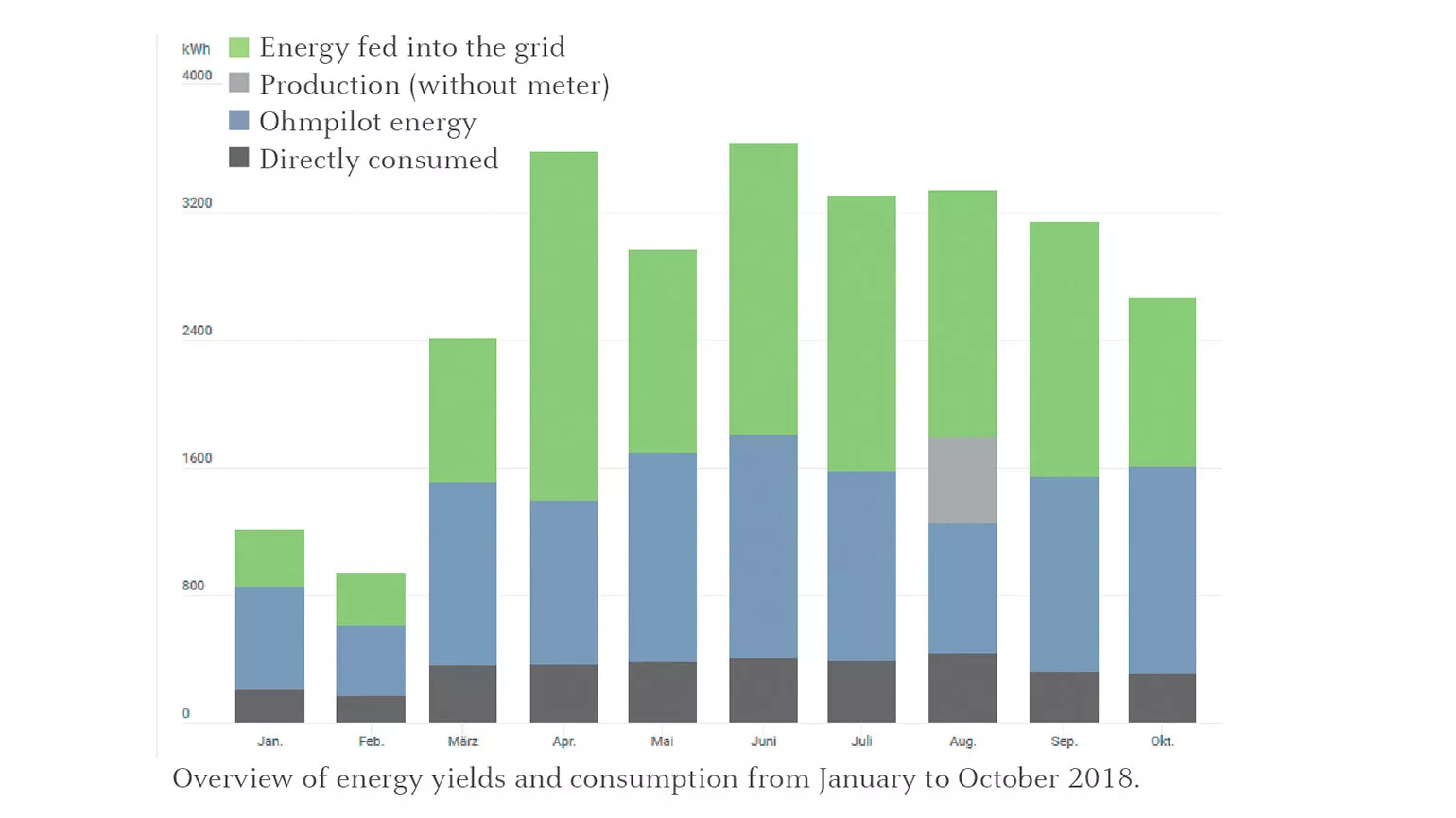

In the Mölschl family home, the Fronius Ohmpilot controls the 9 kW heating rod of a 1000 l buffer storage tank that provides hot water for the taps and the underfloor heating. This increases the family’s rate of self-consumption even further, reaching an average value of more than 50% over the course of the year. Furthermore, the PV energy can take the strain off the woodchip heating system during the summer months.

Size of installation 26.24 kWp
Solutions
Fronius Smart Meter as basis of load management
Fronius Ohmpilot as thermal storage solution
Commissioned October 2016
Annual yield Approx. 33 MWh
CO2 savings / year 17.5 t
Self-consumption rate Jan - Oct 2018: 53%
