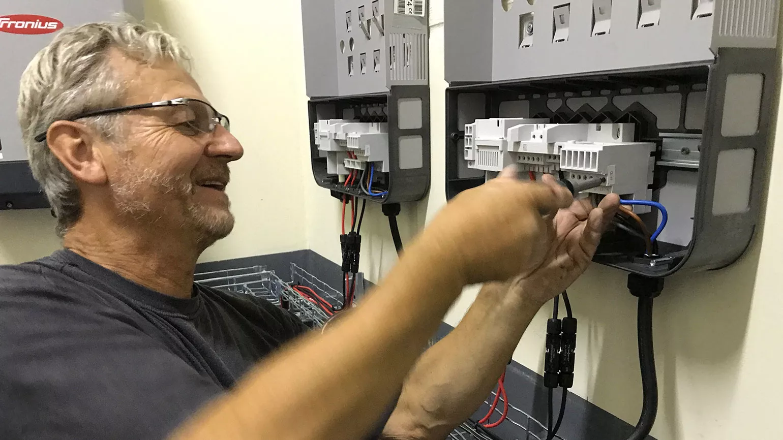

Installer Jean-Marc Panizza says about the installation conditions: "The roof-situation at the winery was quite challenging. Here we have 7 different roofs in 3 orientations. We used the Fronius Symo inverter to fix that problem. Thanks to its Superflex design such an installation is possible and the system owner still earns the highest yields. The Fronius technology made is possible, that I could do the installation alone. This helped me to save on installation costs.” More information on the Fronius Symo inverters
Maximum flexibility in planning
Bertrand Moulaire, Sales Manager at Fronius France, comments: “The Superflex Design of the Fronius Symo inverter allowed the installer absolute flexibility in planning the system. The high system voltage at 1,000 volts and broad input voltage range allows installers to add residual modules, for example. As this system shows, different roof orientations do not present a problem.”
Easy inverter installation saves on costs
The Fronius Symo is very easy to install and also wins when it comes to servicing. PC board replacement technology means Jean-Marc Panizza can carry out a technical service at just one visit, helping to keep long-term costs down. Not only that, Fronius inverters are maintenance-free, again shortening the pay-back time for the system.
