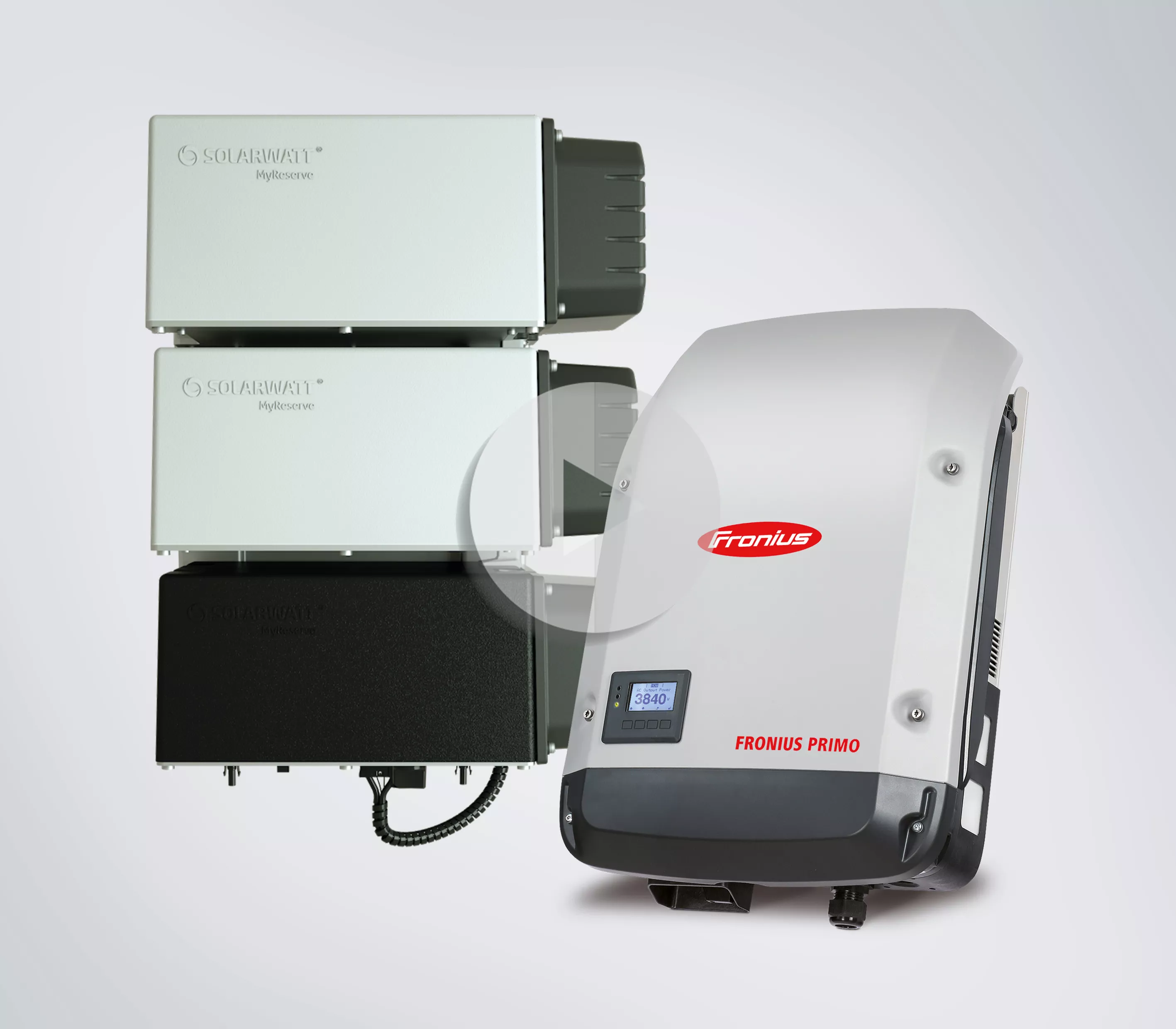

With a self-consumption rate of 63 % and a degree of self-sufficiency of 58 %, this 4.2 kWp photovoltaic system generates very good yields and pays for itself within a few years. In addition to a Fronius Primo inverter a PV string-coupled energy storage system has been installed.
Storage solution for single-phase markets

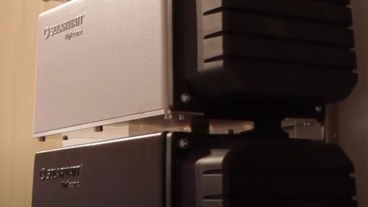

The local installer opted for a device from Solarwatt with 4.8 kWh to store excessive PV energy.
Fronius Primo, Symo and Eco inverters can be used for systems with PV string-coupled batteries.
Modular design of the battery adapts to the energy demand
One of the advantages of the Solarwatt storage solution is its modular design. If the energy consumption of the family increases, additional storage modules can be installed. This may become necessary following the purchase of an electric car or the conversion of the heating system to a heat pump, for example.

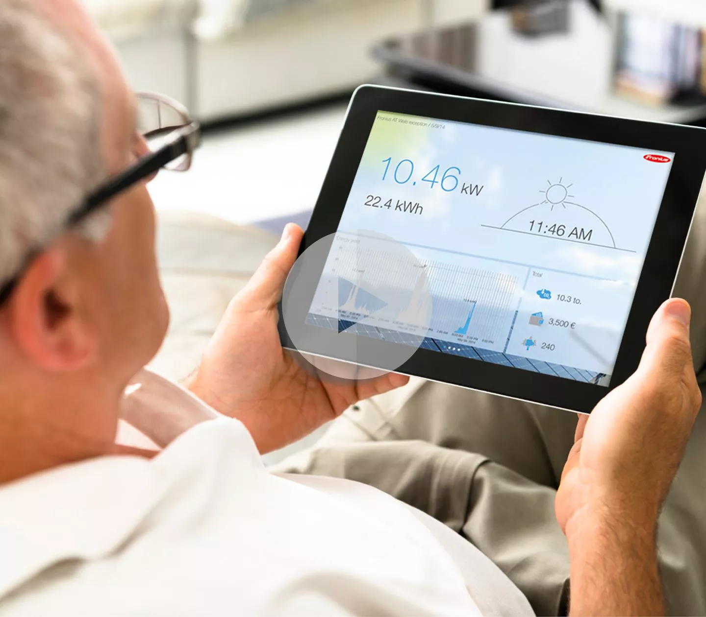

Adjusting power usage with Fronius Solar.web
The system monitoring tool Fronius Solar.web is used by the family to keep an eye on their yields and loads.
The weather widget in particular is very popular with the system owners:
“Thanks to the weather forecast, I can see today how much energy I will have available tomorrow and adapt my plans accordingly. Sometimes I just wait an extra day before doing the laundry.”
