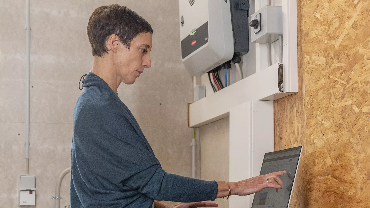

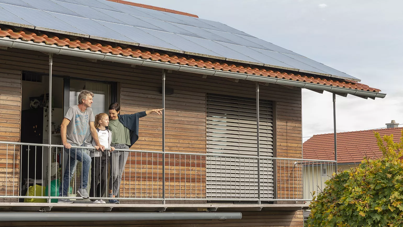

The couple consciously opted for solar energy as their energy supply, and first purchased a PV system including a Fronius Symo GEN24 Plus hybrid inverter with a total output of 8.5 kWp. A few years later, the PV system was supplemented with a 7.7 kWh battery storage system from BYD so that the family of four can use their self-generated solar power not only during the day but also when the sun is no longer shining. With Fronius, the Huber family brings 24 hours of sun into their home.

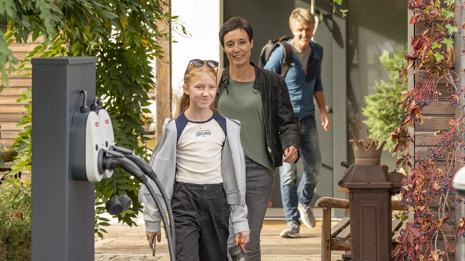

Tamara and Franz Huber now charge their e-car sustainably and cost-efficiently at home with their Fronius Wattpilot Home e-car charging box. “When I charge the car with regular grid power, it costs a fraction of what I would pay for diesel. But if I now charge our e-car with PV electricity, it's virtually free,” says Tamara Huber happily.

The Fronius Wattpilot charges the Huber family’s e-car with surplus PV power or at the guaranteed lowest grid power rate. Dynamic load balancing ensures that the total amount of electricity available in the household – that is, both the output of the PV system and the energy consumed in the household – is managed in the best possible way. To do this, a Fronius Smart Meter measures the current amount of electricity required at the connection point, optimally distributing the electricity and effectively preventing overloading in the home connection. This also reduces connection costs to a minimum. Another advantage: with dynamic load balancing, up to three vehicles can be charged and controlled in an energy-optimized way with the Fronius Wattpilot. This makes the Fronius Wattpilot a long-term support for the Huber family, reliably providing mobility to their family over time when a future e-car is considered for the youngest family members.

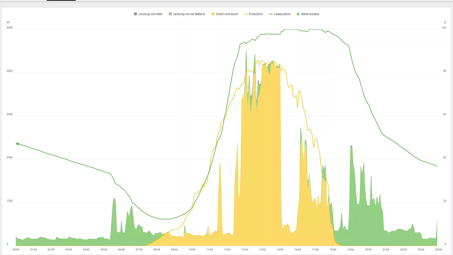

When it comes to self-consumption, Fronius hybrid inverters, battery storage and the Fronius electric charging solution together form an unbeatable team: optimally coordinated with each other, they provide the Huber family with an increasingly self-sufficient and cost-efficient energy supply. “First and foremost, all the consumers in the house are supplied – that is, the heating, ventilation and all kitchen appliances. What’s left over is stored in the battery,” explains Franz Huber. When the battery is 70% full, the electric car is also charged with PV power. Only then is the remaining electricity fed into the public grid.

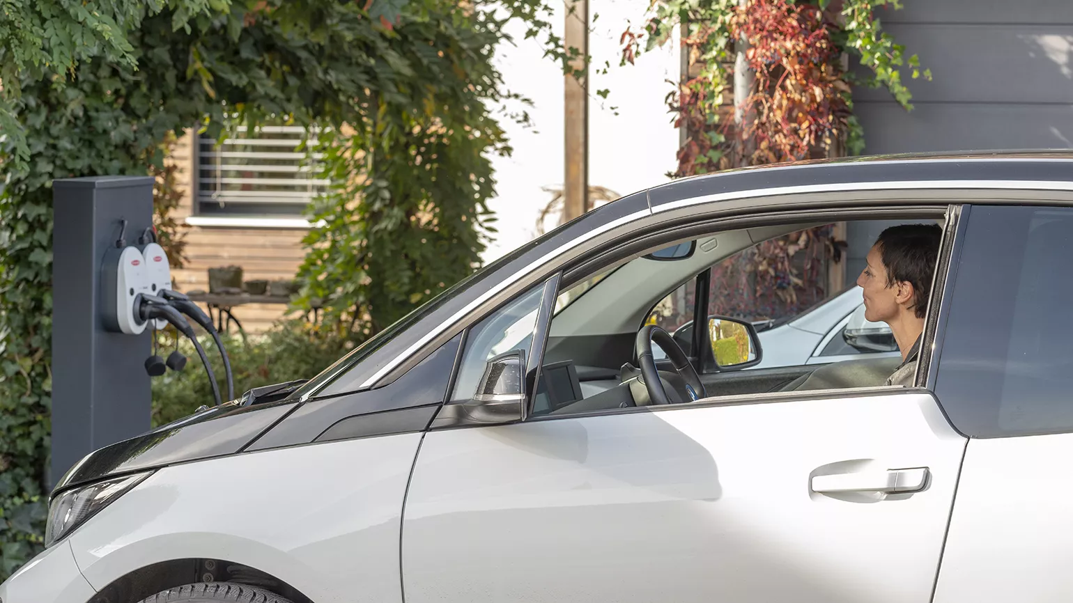

“The Fronius Wattpilot can also feed small amounts of electricity into a car. This is perfect because the car is charged from as little as 1,400 watts.”, says Franz Huber.
The Fronius Wattpilot can automatically switch between 1 and 3 phases when charging with surplus PV power and regulate in 1-ampere increments. This means that even low charging currents are reliably charged into the e-car – and even the smallest amount of solar power from the owner’s PV system is optimally used.

Percentage of self-sufficiency 63% in 2022, nearly 100% in the summer months

On sunny days, the Huber family achieves up to 99% self-sufficiency.
