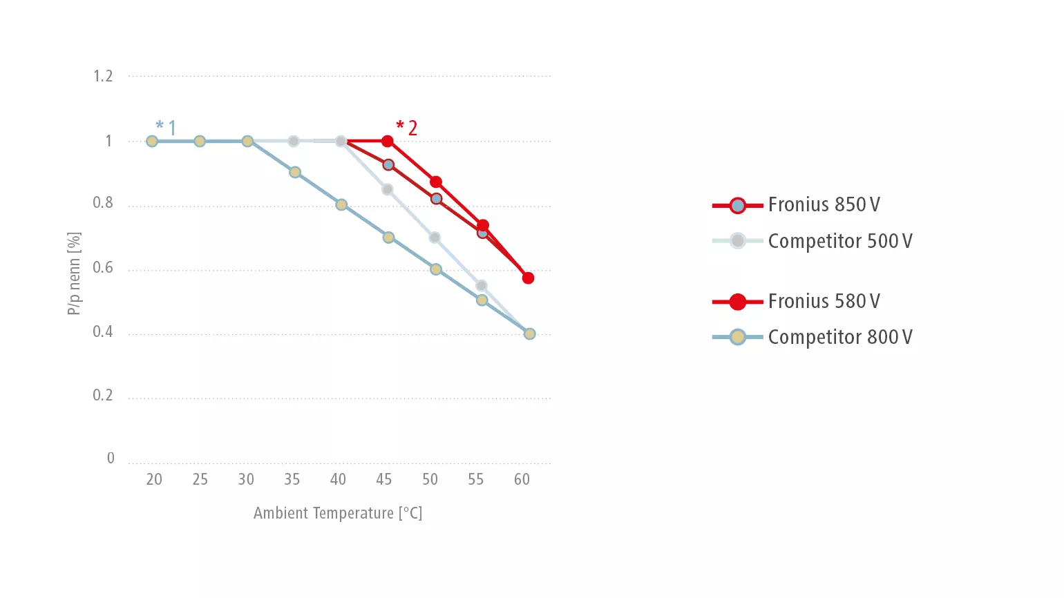

HIGHER YIELDS
To prevent electronic components from overheating, an inverter is always power derated, i.e. the output power is reduced. Inverters with active cooling technology have a clear advantage here, especially in the higher temperature ranges.
Since the inverters are significantly cooler inside, they only start to reduce their output power at higher ambient temperatures. This has a positive effect on the yield. The inverters deliver higher yields, thereby reducing the payback period of the investment.
*1 passive cooling
*2 active cooling
