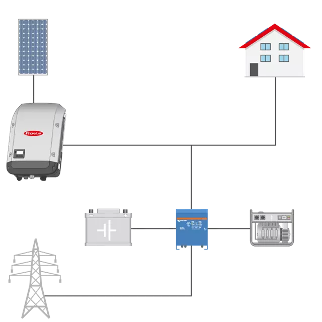

How the Fronius MicroGrid & backup solution works
Fronius inverters have a special MicroGrid setup to ensure stable MicroGrid operation. The inverter provides the MicroGrid with as much PV energy as possible. If the load is less than the maximum capacity of the PV generator and if the batteries are already full (or the charging power of the inverter charger is too low), automatic PV power reduction will be required. Most of the time, the output of the inverter is controlled without communication. In this case, the frequency droop characteristic of the inverter charger and the Fronius inverter ensure optimum power setpoints.
With an inverter charger from Victron Energy (Victron MultiPlus, Victron Quattro), the Fronius MicroGrid setup can be used without further configuration on the Fronius inverter.
PV generator The sun’s energy is absorbed by the solar modules in the form of direct current.
1
Fronius inverter The inverter converts the direct current into the alternating current used as standard in the home and supplies the MicroGrid with as much PV energy as possible.
2
Inverter-charger The current produced in the inverter can be saved in the battery using the inverter chargers.
3
Battery The surplus PV energy is stored in a battery.
4
Loads The loads are supplied with predominantly solar energy via the MicroGrid system.
5
Backup generator Diesel generators can also be integrated as a backup for the energy supply.
6
1
PV generator
2
Fronius inverter
3
Inverter-charger
4
Battery
5
Loads
6
Backup generator

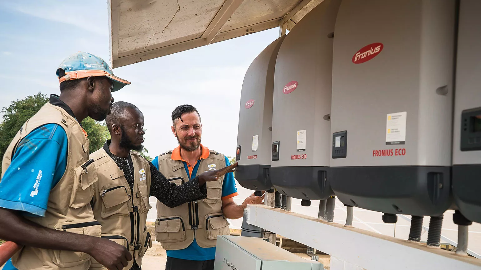

Fish farm in Mali
Five tonnes of fish a day are produced by the Complex Agro Industrial de Baragnouma fish farm in Mali. One of the biggest challenges is maintaining a continuous power supply for the water treatment plant. In order to ensure a stable power supply, the company decided back in 2014 to cover as much of its needs as possible with photovoltaic energy.
With the solar system providing 98% of the firm’s energy requirements, only 2% is provided by backup diesel generators.
