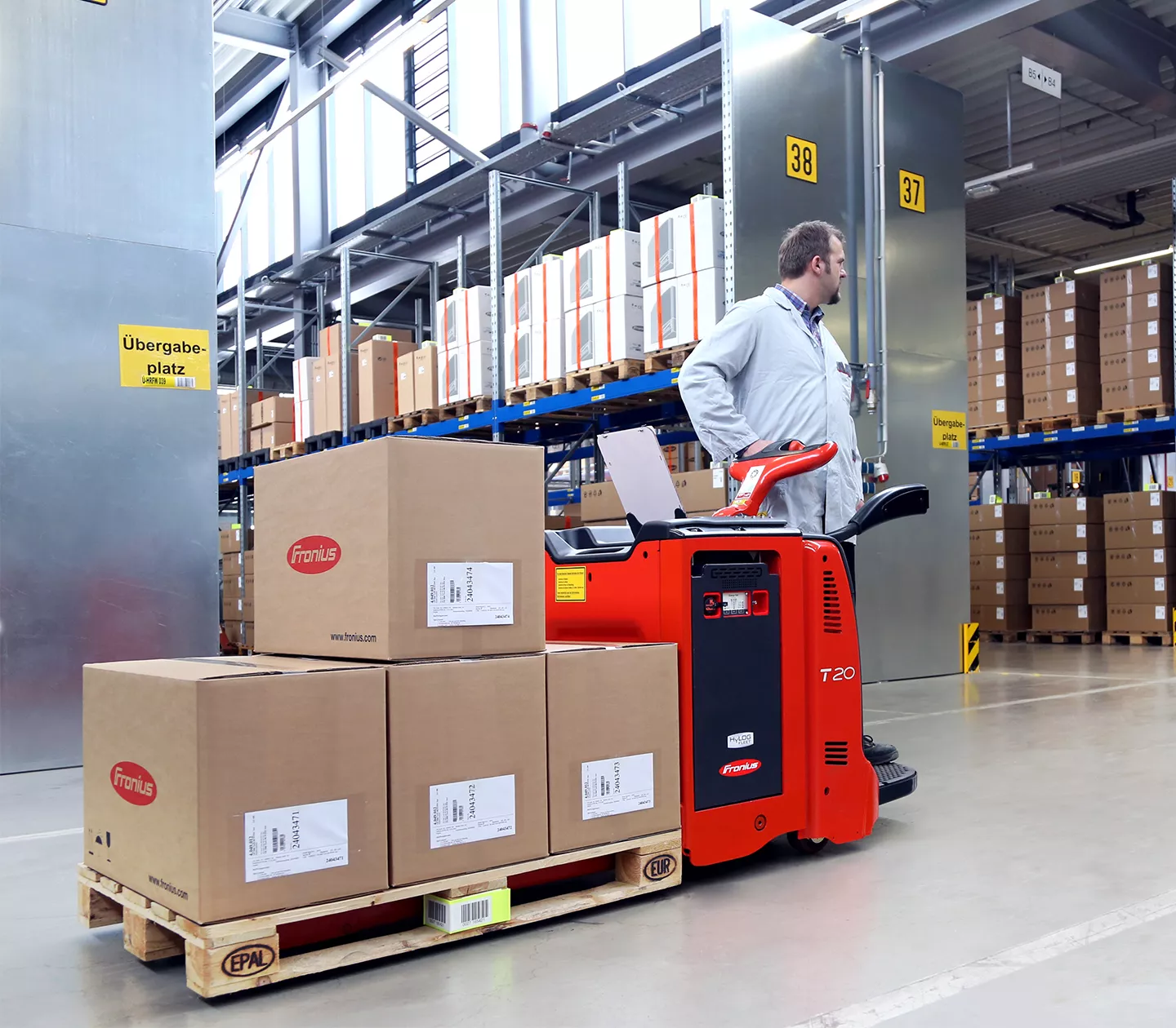

We have developed a fuel cell system for forklift trucks called Fronius HyLOG Fleet. We presented this for the first time in 2011, together with the forklift truck supplier and project partner Linde Material Handling. HyLOG Fleet is currently being used in class 3 forklift trucks, that is, in warehouse equipment with a seat or operator platform. The fuel cell scores highly compared to a battery, and has many advantages: it only takes a few minutes to charge rather than seven to twelve hours, there is no need to set up battery charging rooms and stations and the Fronius HyLOG Fleet also has zero emissions, making it extremely cost-effective and environmentally friendly.

Since June 2013, logistics service provider DB Schenker has been testing a fleet of forklift trucks with hydrogen drives (the E-LOG biofleet) at its freight terminal in Hörsching near Linz. A consortium consisting of Linde Fördertechnik GmbH, OMV Refining und Marketing GmbH, Fronius International GmbH, HyCentA Research GmbH, Schenker & Co AG and the JOANNEUM RESEARCH Forschungsgesellschaft mbH is responsible for the pilot project.
The ten Linde low-lift pallet trucks are each equipped with a Fronius fuel cell hybrid drive. This consists of a hydrogen tank, a 24 V fuel cell that converts the hydrogen into electrical energy and a lithium-ion battery, which stores the generated power and acts as a traction battery. To supply the fleet with fuel, the Austrian energy firm OMV installed the first indoor hydrogen filling station in Europe. The project receives state funding from the Austrian Federal Government’s Climate and Energy Fund.
The aim of the E-LOG biofleet is to increase productivity and cost effectiveness at DB Schenker, while also improving environmental sustainability and energy efficiency. All participants also hope to derive important knowledge from the project that can be incorporated into the development of fuel cells through to series production.
