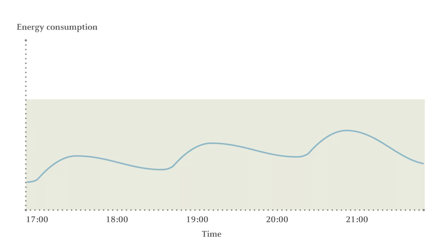

Fully charged by a given time
Slow rise in energy consumption - the time until the battery has to be fully charged is given
With the function "fully charged by a given time" the time at which the batteries have to be fully charged is set. This enables a gentle and slow start of the charging process. The time available for charging of the batteries is used in the most efficient way. Elongated charging process limits the heating, this way the charging process is gentle to the battery. This has two major benefits: energy savings and extension of the battery life.
