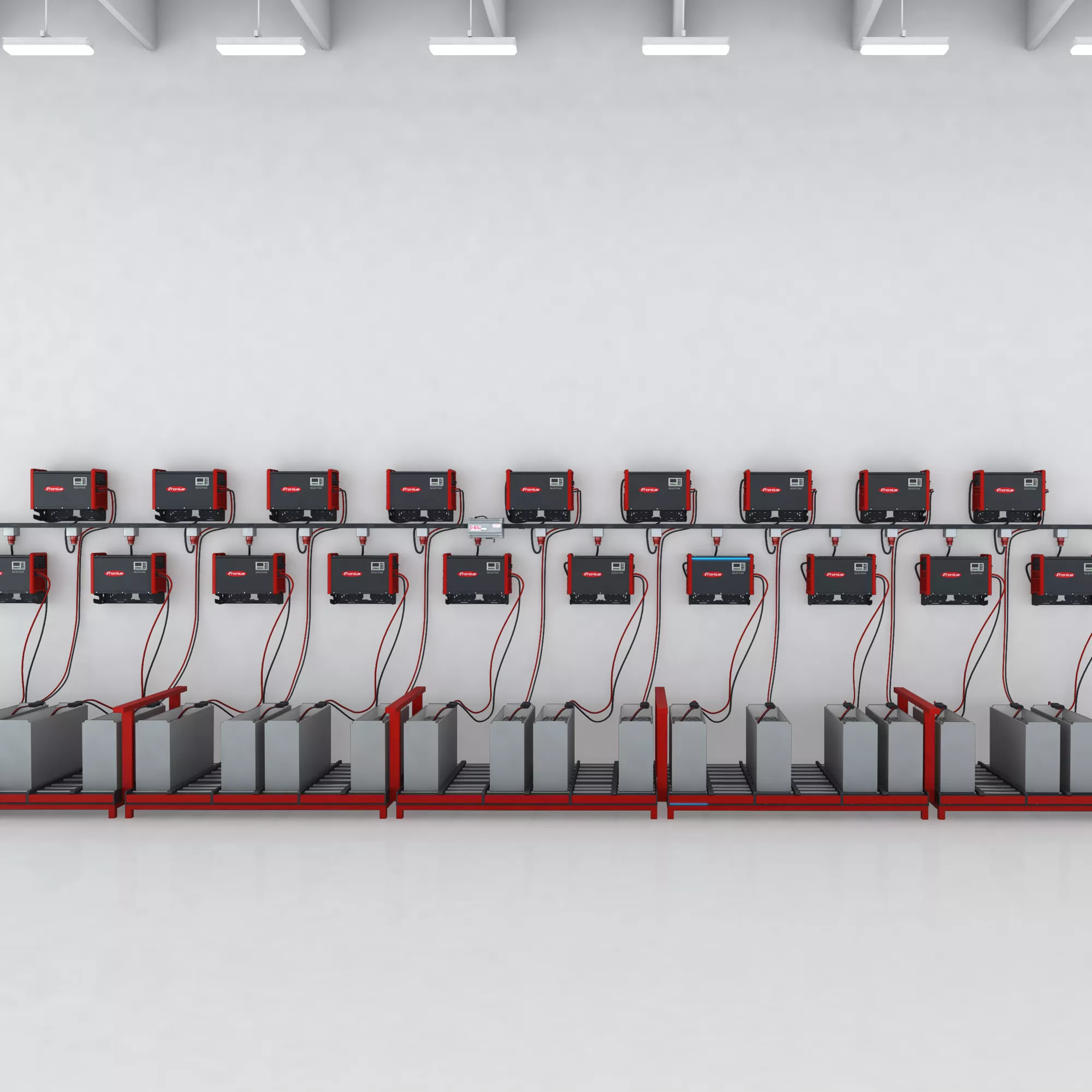

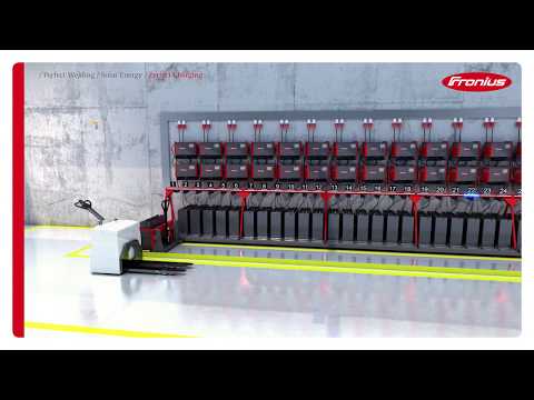

Intelligent battery management with the Cool Battery Guide Easy
With the Cool Battery Guide Easy information and management system from Fronius, users can dramatically improve the utilisation of their battery pool. A control unit processes the signals of the individual Fronius Selectiva battery charging systems, while a blue LED strip on the unit itself shows the user which battery has been fully charged for the longest and is therefore the coolest, intuitively guiding the user to the correct battery. In addition, an alarm signal can be output if the wrong battery is taken, making incorrect selections made by employees a thing of the past. More effective utilisation improves the chemical properties of the battery and ensures maximum capacity and performance for as long as possible.
The intelligent battery management system from Fronius extends the service life of the traction batteries, thereby reducing the operating costs. As the user always has access to a fully charged battery, constant availability of the forklift truck fleet is guaranteed. Pro Cool Battery Guide Easy allows up to 30 battery charging systems to be connected, while coupling of several control units is possible to equip larger battery charging rooms and stations with the management system. For those wishing to deploy the system in harsh environmental conditions, Fronius can also supply on request a special housing for the control unit that provides enhanced IP protection.
