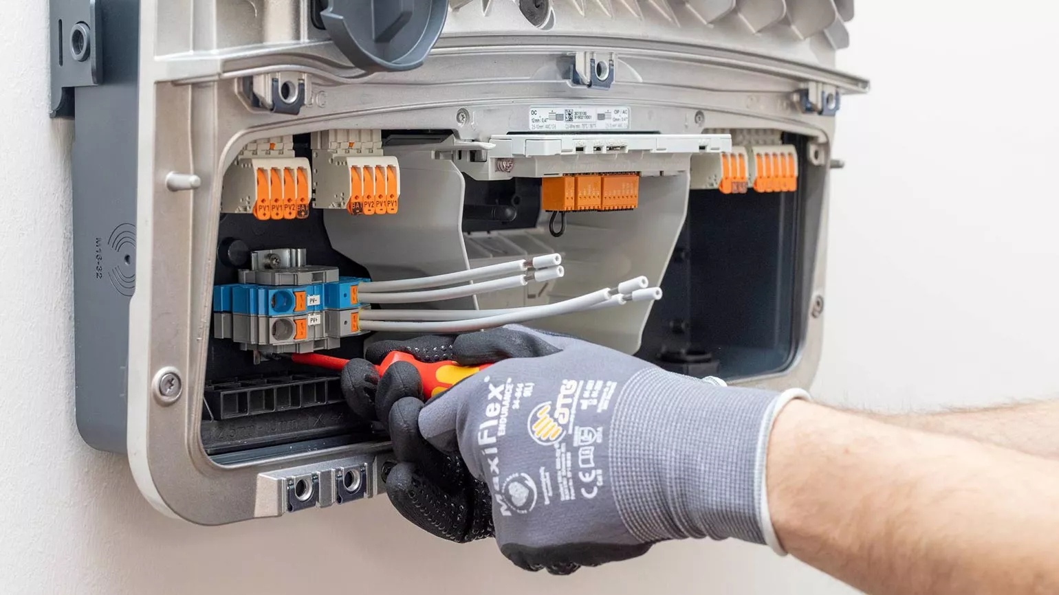

Connecting MPP trackers
When MPP trackers are combined, the currents are added together, which makes it possible to connect strings with higher amperages and cables with a cross section of up to 16 mm². The Connector Kit therefore provides complete flexibility when selecting solar modules.
The DC Connector Kit GEN24 has been specially developed for use with the Fronius Primo and Symo GEN24. The terminals used are safe to touch and no ferrules are needed.
