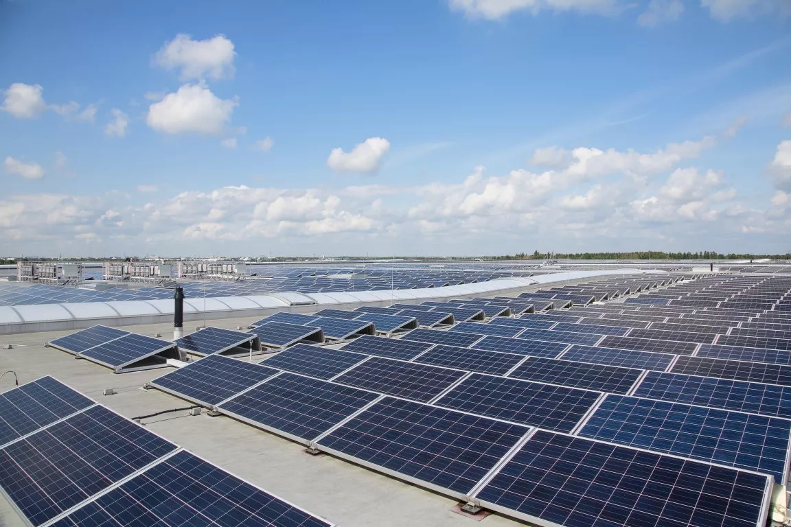

PV Array in Parsdorf

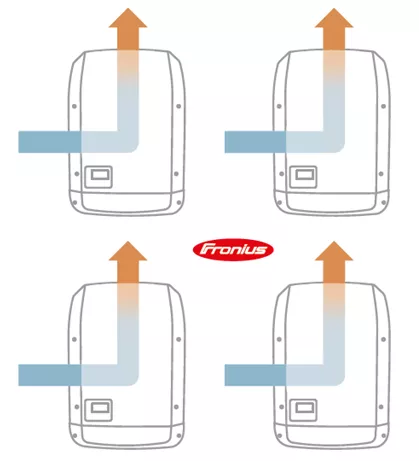

How active cooling works
The electronic components inside inverters react very sensitively to high temperatures. Inverters need to be cooled to prevent these components from overheating. Active colling technology aims to proactively avoid heat fields by using interior fans and removing warm air in a controlled manner. One or more fans ensure that the air inside the inverter circulates and keeps the temperature low. By contrast, passive cooling technology relies on natural convection as used in many inverters on the market. Large heat sinks keep the internal temperature down.

Simple and flexible installation
Thanks to active cooling, the inverters are also highly flexible concerning installation. Some inverters can be mounted vertically, horizontally, and even flat on the roof. An intelligent, active airflow also makes it possible to mount the inverters side-by-side.
