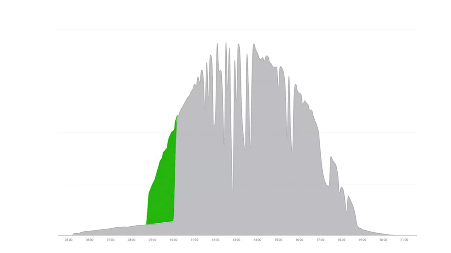

With Dynamik Peak Manager.
String inverters have software based shade mitigation
Intelligent shade management, which is part of the inverter software, reduces shade-related yield losses to a minimum, without the hassle of additional hardware on the roof. This highly efficient software algorithm detects any shade and optimizes the yield at the string level. Not only does this cost less because there are fewer system components, it also keeps installation and service (O&M) costs to a minimum, as well as reducing safety risks to technicians.
Detailed information about Dynamic Peak Manager here.
