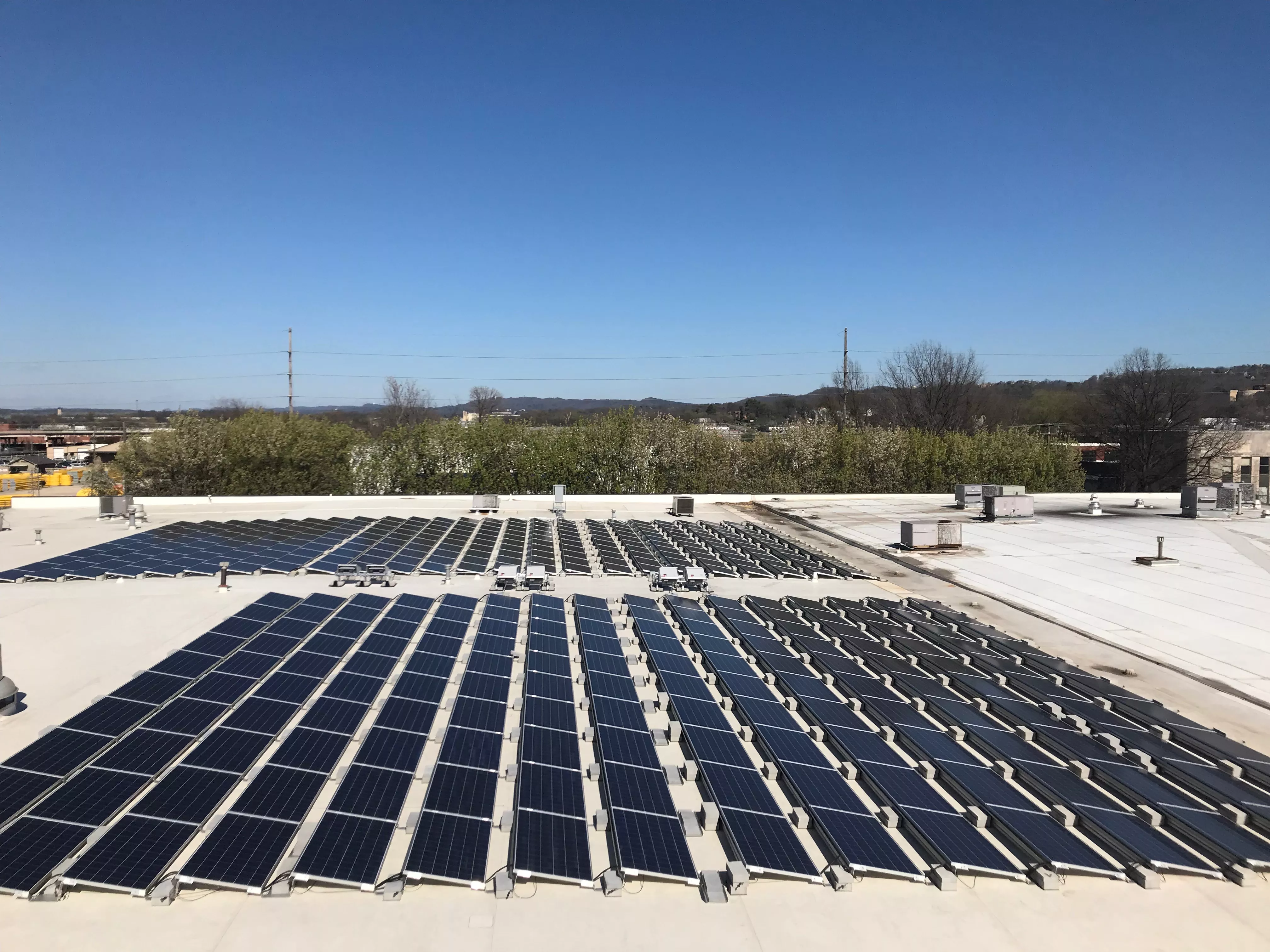

Marx Brothers Inc., is a family owned company based in Birmingham, Alabama. A national importer and supplier of high quality coconut products, Marx Brothers has launched a new sustainability initiative that includes the installation of a 132- kilowatt PV system on the roof of its Birmingham facility.
Birmingham, AL

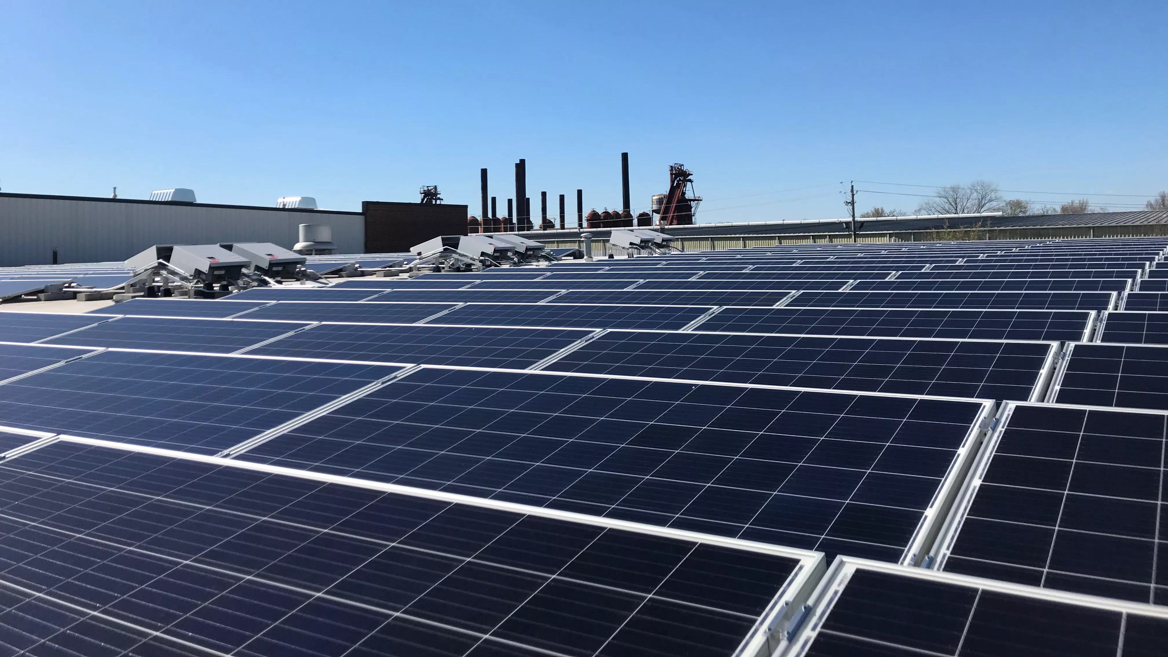

The PV system consists of 10 Fronius Symo SnapINverters, 10 Fronius Shade Covers, and 400 JA Solar 330- watt solar panels. Vulcan Solar Power a leading provider of turnkey solar energy systems across Alabama, Mississippi, and Georgia, designed and installed the PV system that is projected to produce more than 205,000 kilowatt-hours (kWh) of electricity in its first year. The system is also the largest commercial system in central and southern Alabama.

Size of Installation 132 kW
Purpose, system type Marx Brothers Inc, commercial rooftop
Module type 400 JA Solar 330-watt panels
Inverter 10 Fronius Symo and 10 Fronius Shade Covers
Annual yield approx. 205,000 kWh
Location Birmingham, AL
Installer Vulcan Solar Power
Special feature Largest commercial PV system in central and southern Alabama

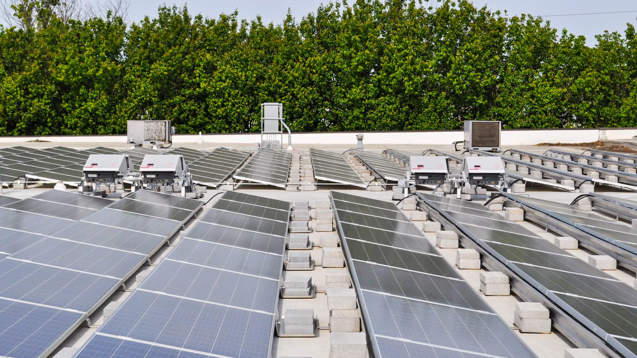

The Challenge:
/ Possible overheating
Our Solution:
/ Install Fronius Shade Covers, keeping the inverter's temperature low and performance high
