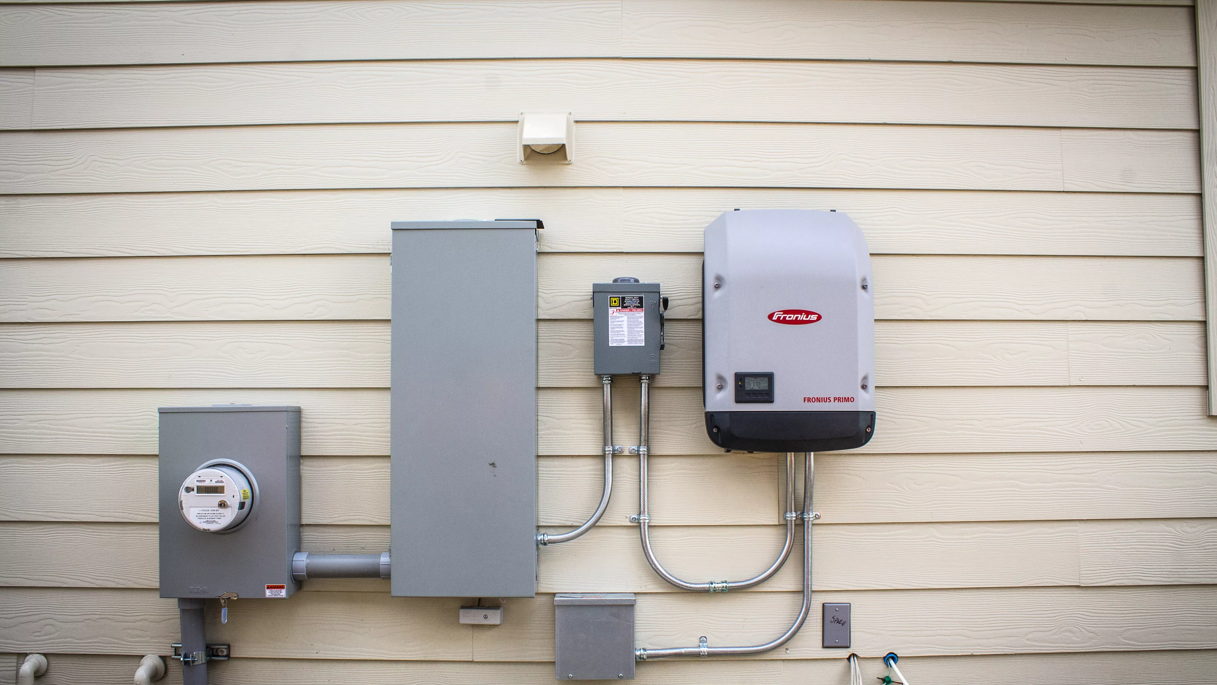

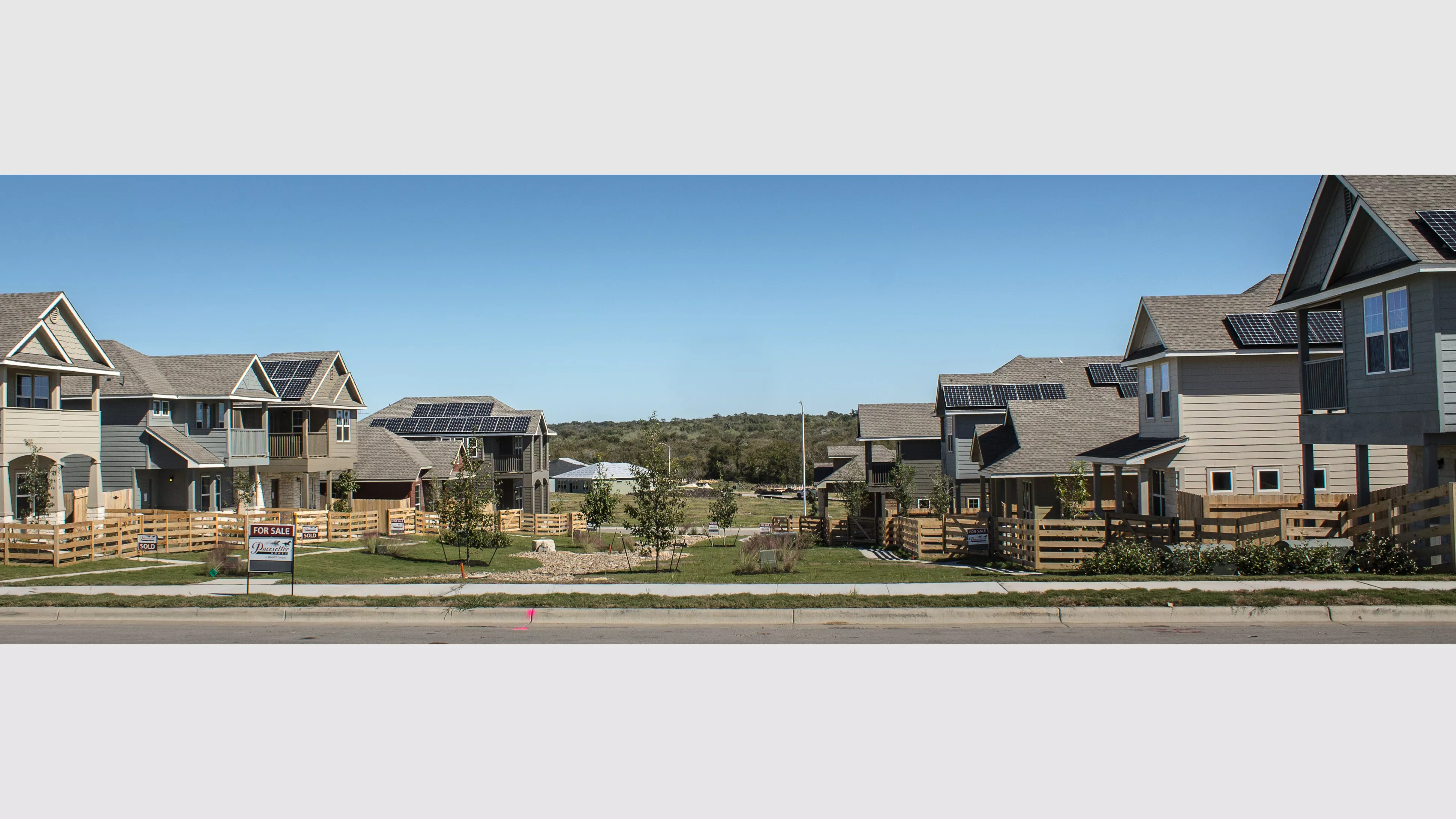

Whisper Valley is an environmentally-friendly, 2,000-acre development committed to sustainability, affordability, and cutting-edge technology. The 2,000- acre community includes 7500 homes, two schools, restaurants, retail and emergency services. Thanks to advanced technology and innovative products, it is now possible for homes to be energy self-sufficient. By reducing consumption using high-efficiency geothermal heat pumps and producing power using photovolatic (PV) solar panels, a home can become zero-energy capable.
Whisper Valley 2

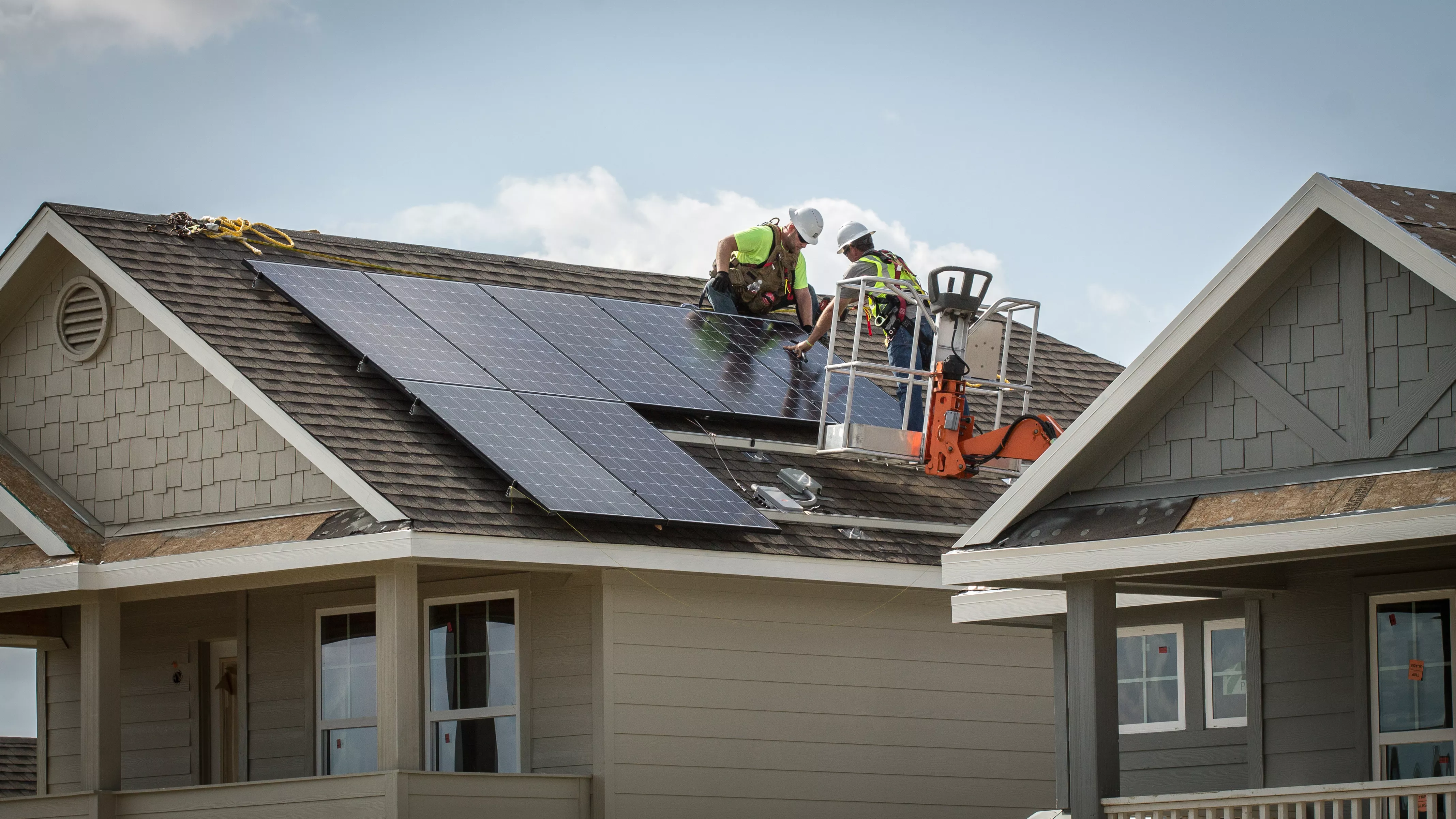

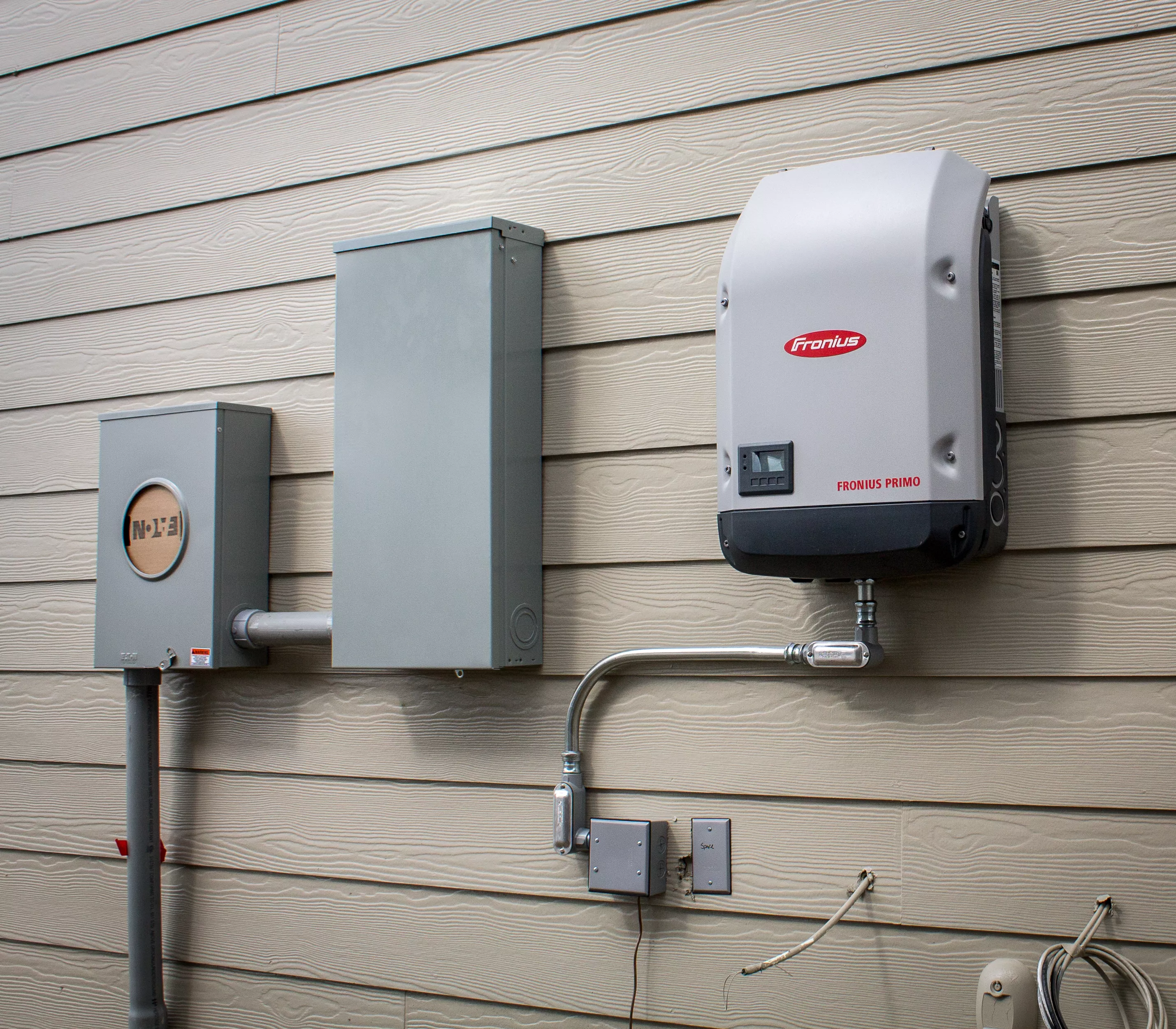

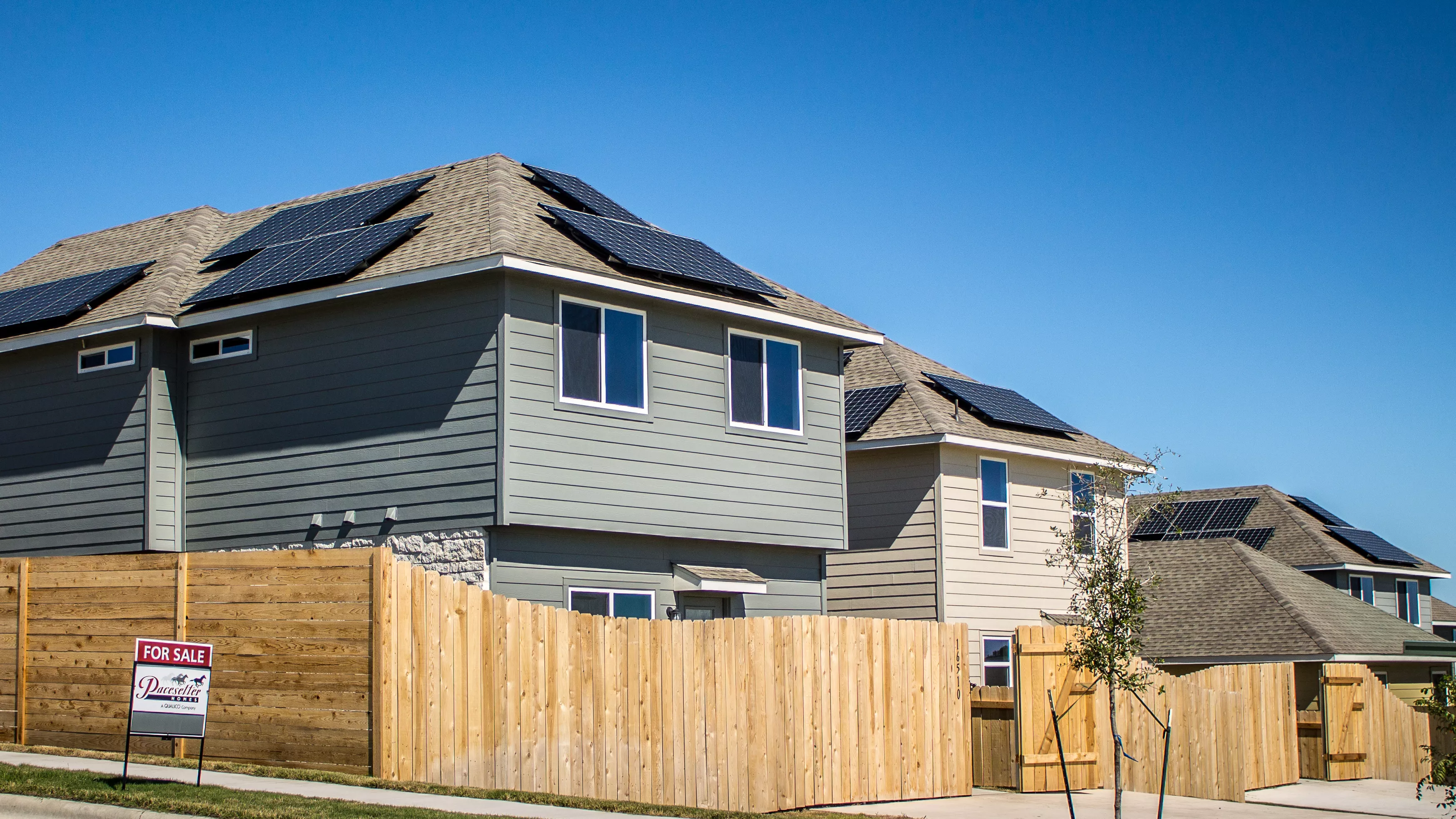

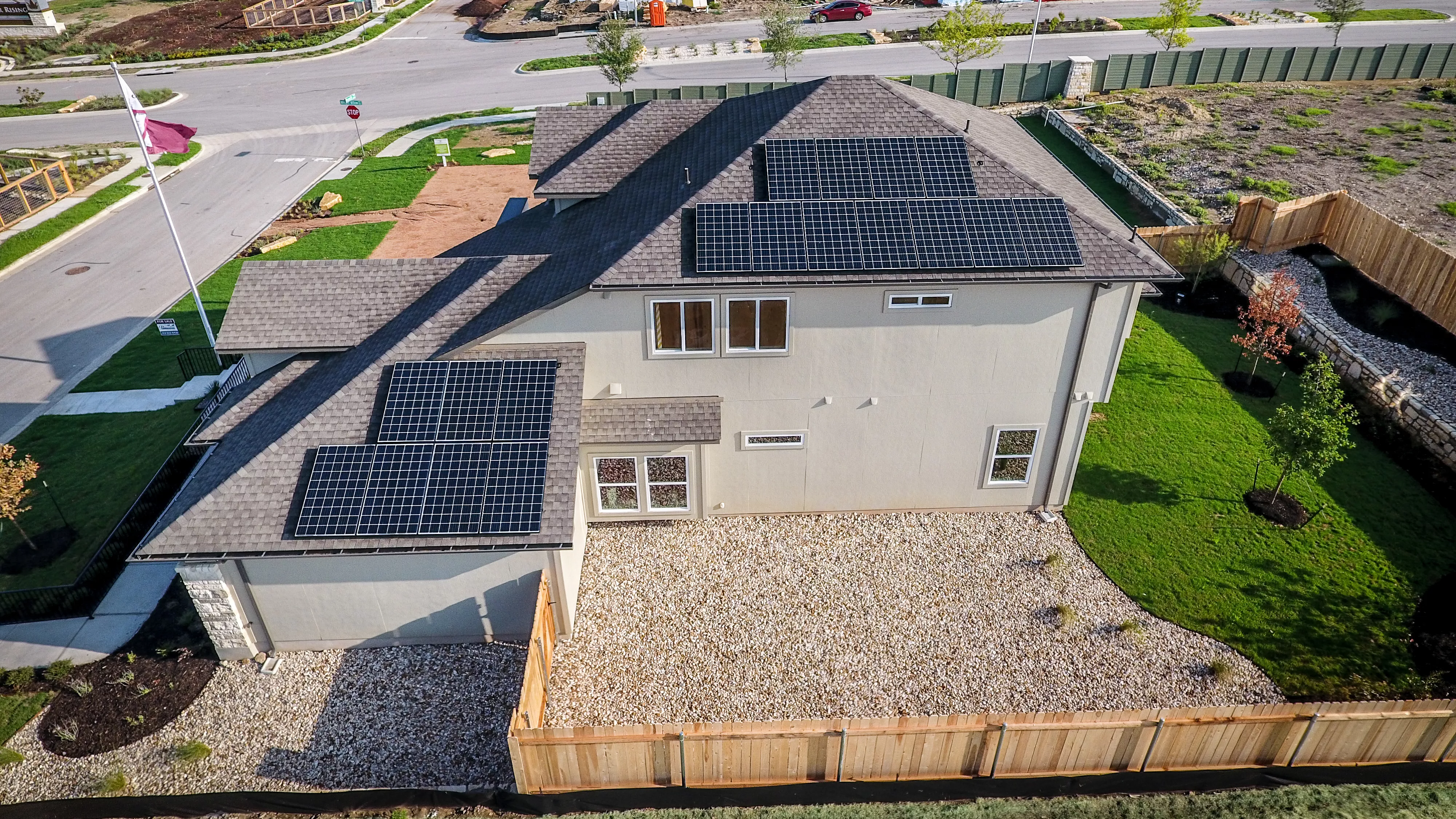

Francis Solar, in partnership with Eco-smart Solution and Taurus LP, designed a district thermal system and renewable energy systems for the 7500-home master planned community of Whisper Valley. The individual residences were aided by Francis "solar-ready" design, and will feature between 4-6 Kw DC systems, including Canadian Solar Panels and Fronius Inverters. Because of the geothermal HVAC systems in each house and other energy efficiency measures, the homes can attain net-zero status without over sizing the solar arrays. Upon completion, the Whisper Valley community will feature 35 MW of solar!
Size of Installation  35 MW upon completion
Purpose, system type  7500 net-zero homes
Module type  Canadian Solar Panels
Inverter  Fronius Primo Inverters
Location  Austin, TX
Installer  Francis Solar
