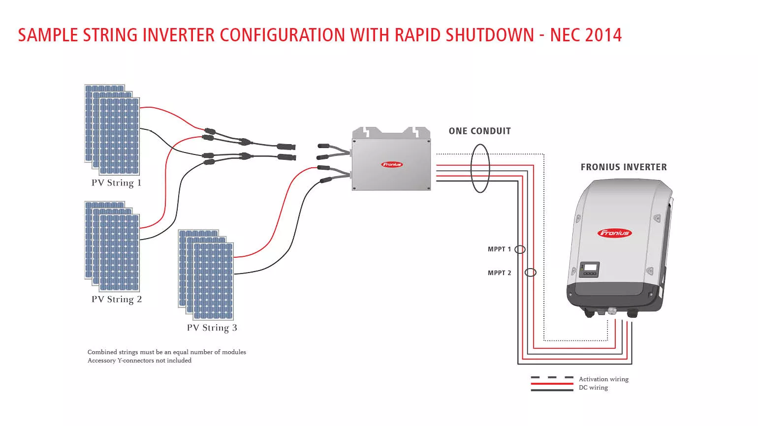

To highlight this variation, let's have a look at a typical 6 kWp residential system. If the system is designed with DC optimizers or rapid shutdowns, the number of electrical components adds up to 26. There is one DC optimizer attached to each of the 24 modules, and then there is an inverter and most likely some sort of communication gateway. If a string inverter is used, the number of components is only 2 - a Rapid Shutdown Box and the string inverter. This is a significant difference, with a big impact on many aspects of the system. Let's have a closer look on these.
Solar configuration with a string inverter
A string inverter solar system requires fewer components. Here it is shown how a PV system in a NEC 2014 state could look
