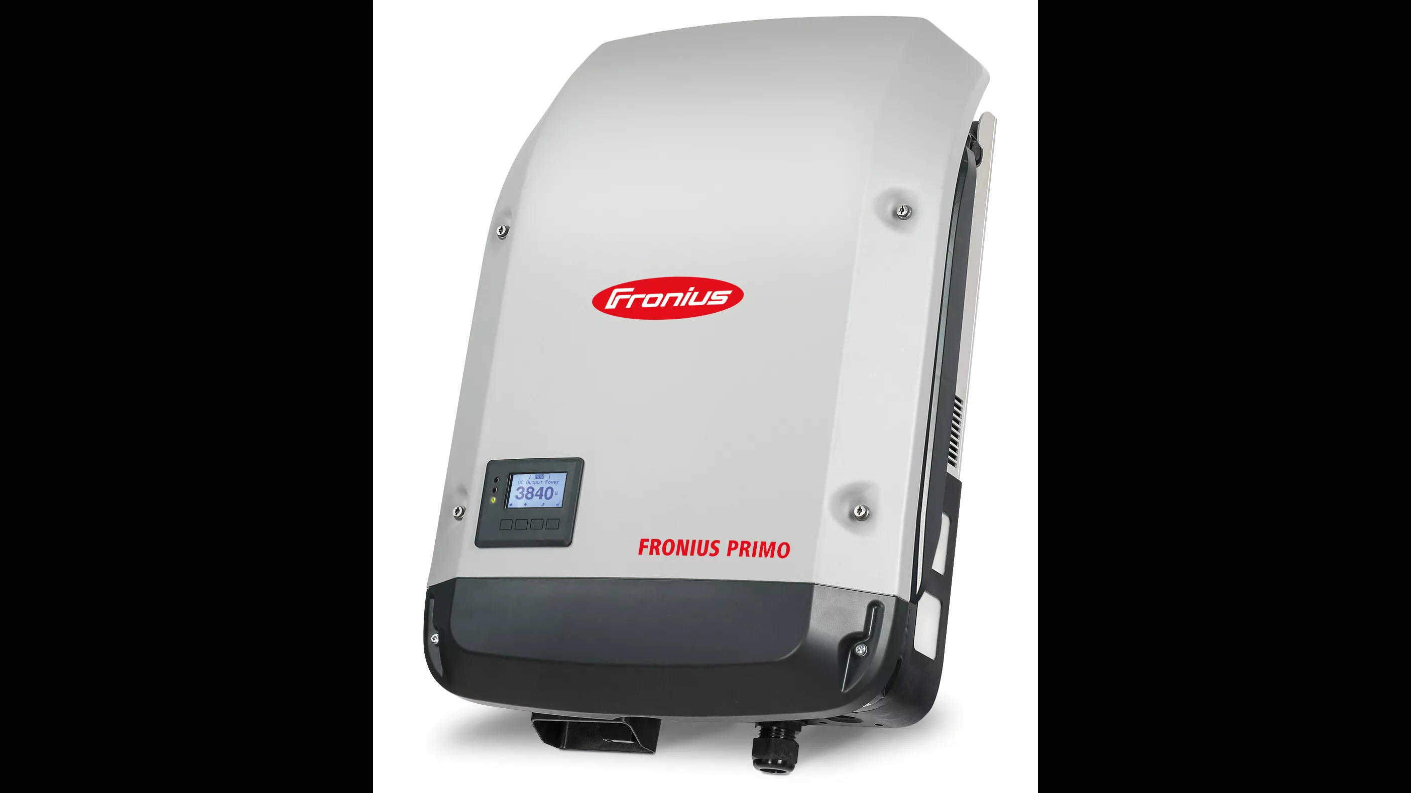

/ The maximum current on a given AC panel is the reason for some odd looking inverter power classes. In order to avoid costs for AC panel upgrades, it makes sense for inverter manufacturers to provide power classes that get the most solar power on an existing customer’s AC panel without upgrading it. That’s why Fronius offers the Fronius Primo in the power classes 3.8 kW and 7.6 kW, or the Fronius IG Plus A with 11.4 kW.
