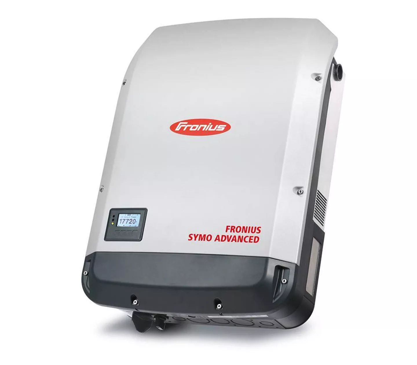

Fronius Symo Advanced
The Fronius Symo Advanced string inverter is UL 3741 certified for use with listed flat roof systems when the inverter is installed within the 1 ft array boundary. This certification eliminates the need for module level rapid shutdown devices. When modules are properly mounted with either of these UL 3741 approved PV Hazard Control commercial installation systems, the Fronius Symo Advanced is NEC 690.12 compliant.

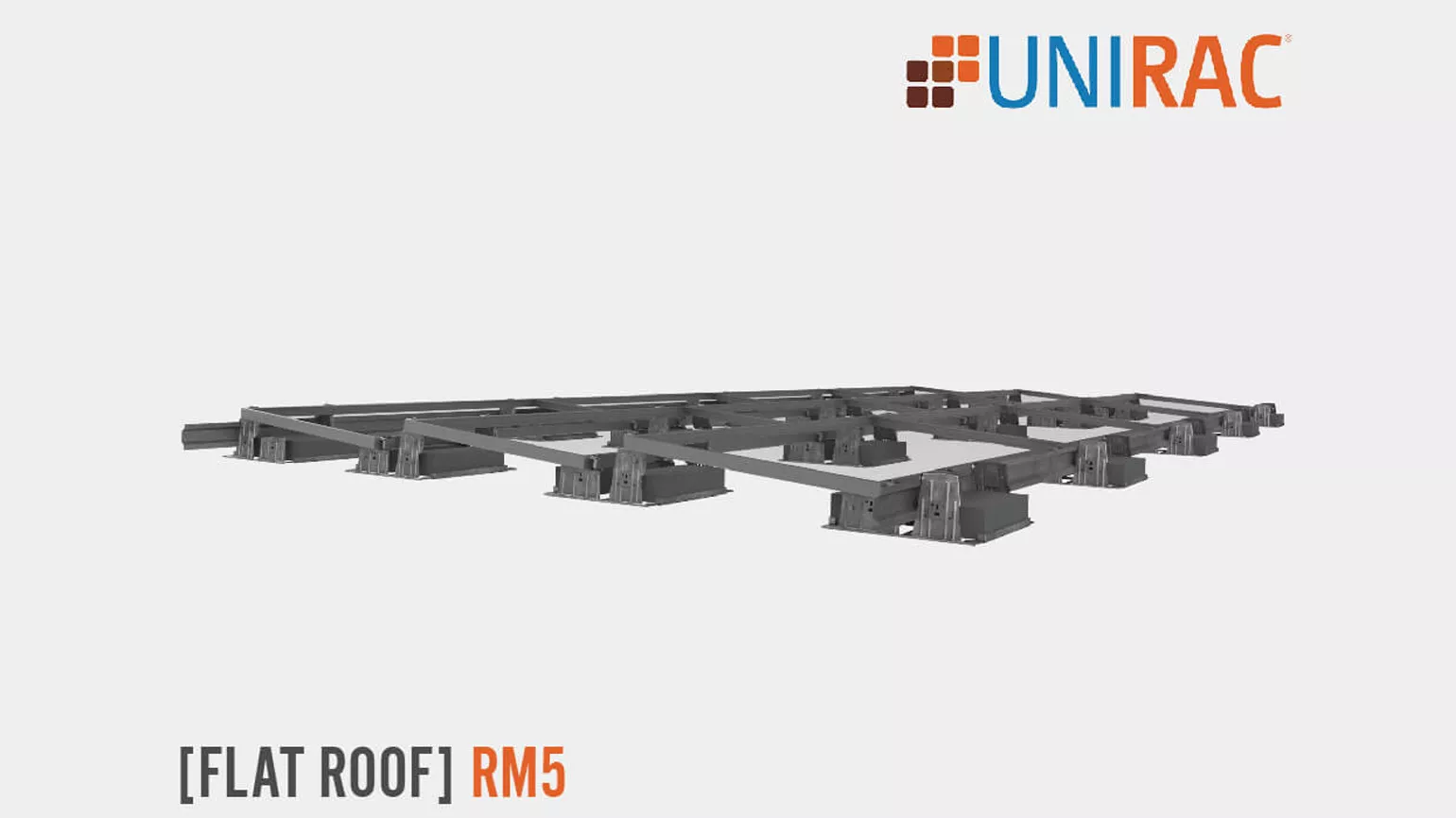

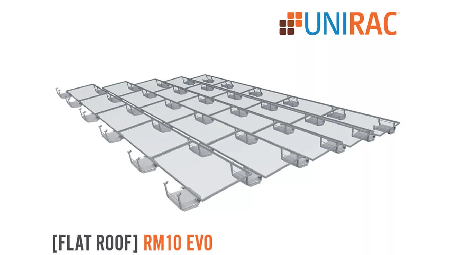

UNIRAC®
UNIRAC® Flat Roof Systems (RM10 EVO, RM10 LEGACY, RMDT, RM5, ECOFOOT 2+, ECOFOOT 5D, GRIDFLEX 5) are UL 3741 Listed systems that comply with NEC 690.12 when installed by qualified persons per the installation procedures outlined in the UNIRAC® UL 3741 Installation Guide.
For installation instruction manuals, procedures and product requirements, click the link below to be directed to manufacturer’s website

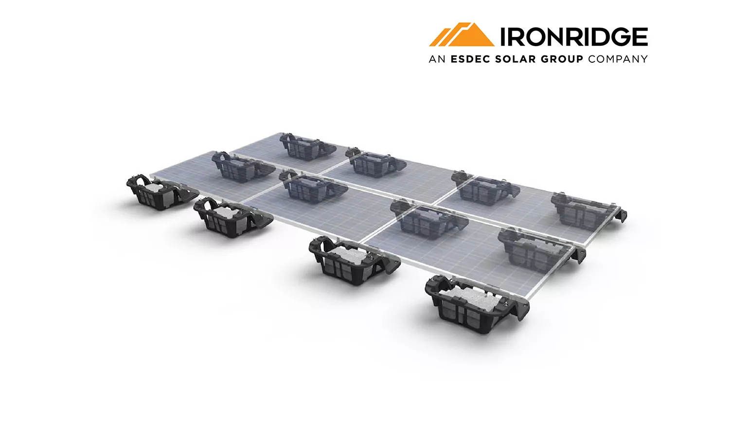

IRONRIDGE®
The BX Ballasted flat roof Photovoltaic Hazard Control System (PVHCS) is a UL 3741 Listed system that complies with NEC 690.12 when installed by qualified installers per the installation procedures outlined in the BX System Installation Manual.
For installation instruction manuals, procedures and product requirements, click the link below to be directed to manufacturer’s website.

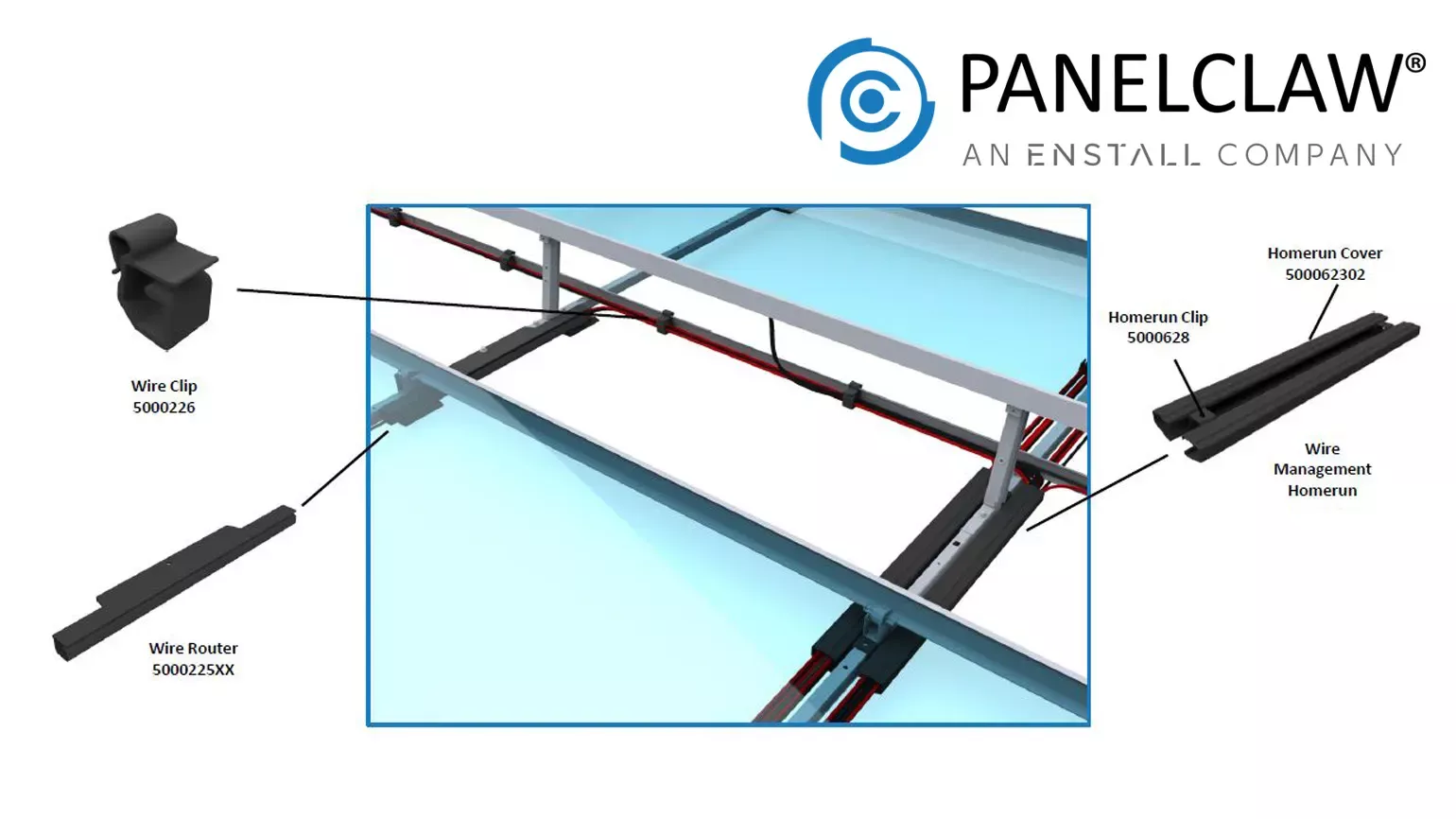

PANELCLAW®
The clawFR Photovoltaic Hazard Control System (PVHCS) is a UL 3741 Listed system that complies with NEC 690.12 when installed by qualified persons per the installation procedures outlined in the clawFR System Installation Manual.

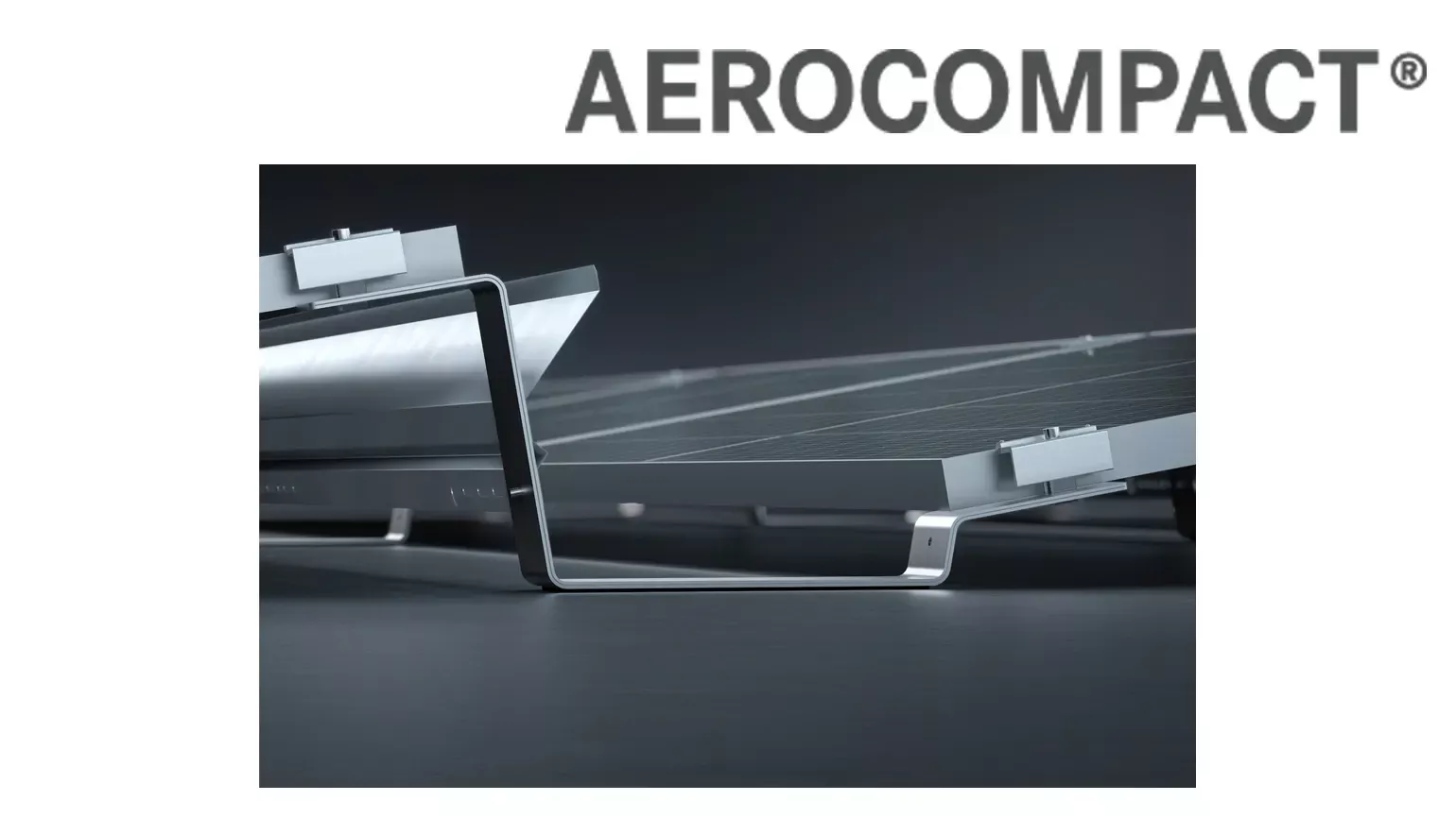

AEROCOMPACT®
The SN2 and COMPACTFLAT S bracket-based flat roof system are UL 3741 Listed systems that comply with NEC 690.12 when installed by qualified persons per the installation procedures listed on the manufacturers instructions.
- Module sizes up to 98.4 in x 51.60 in / 1310 x 2500 mm
- Low point loads
- Short-side and long-side clamping
- High wind and snow loads
- Versatile system with few components
- Preassembled components, plug & play

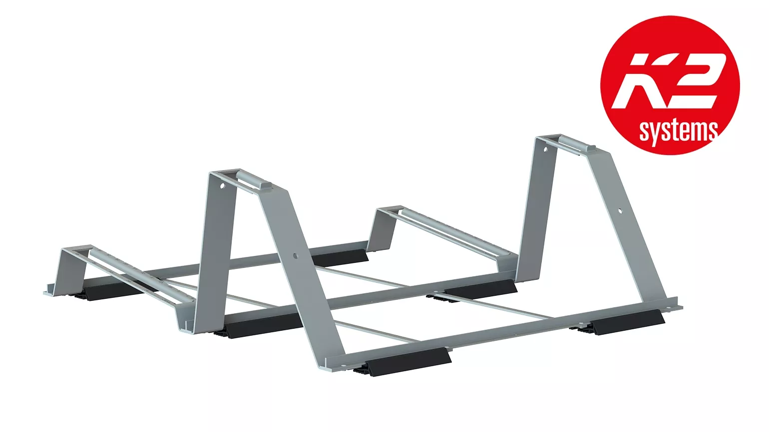

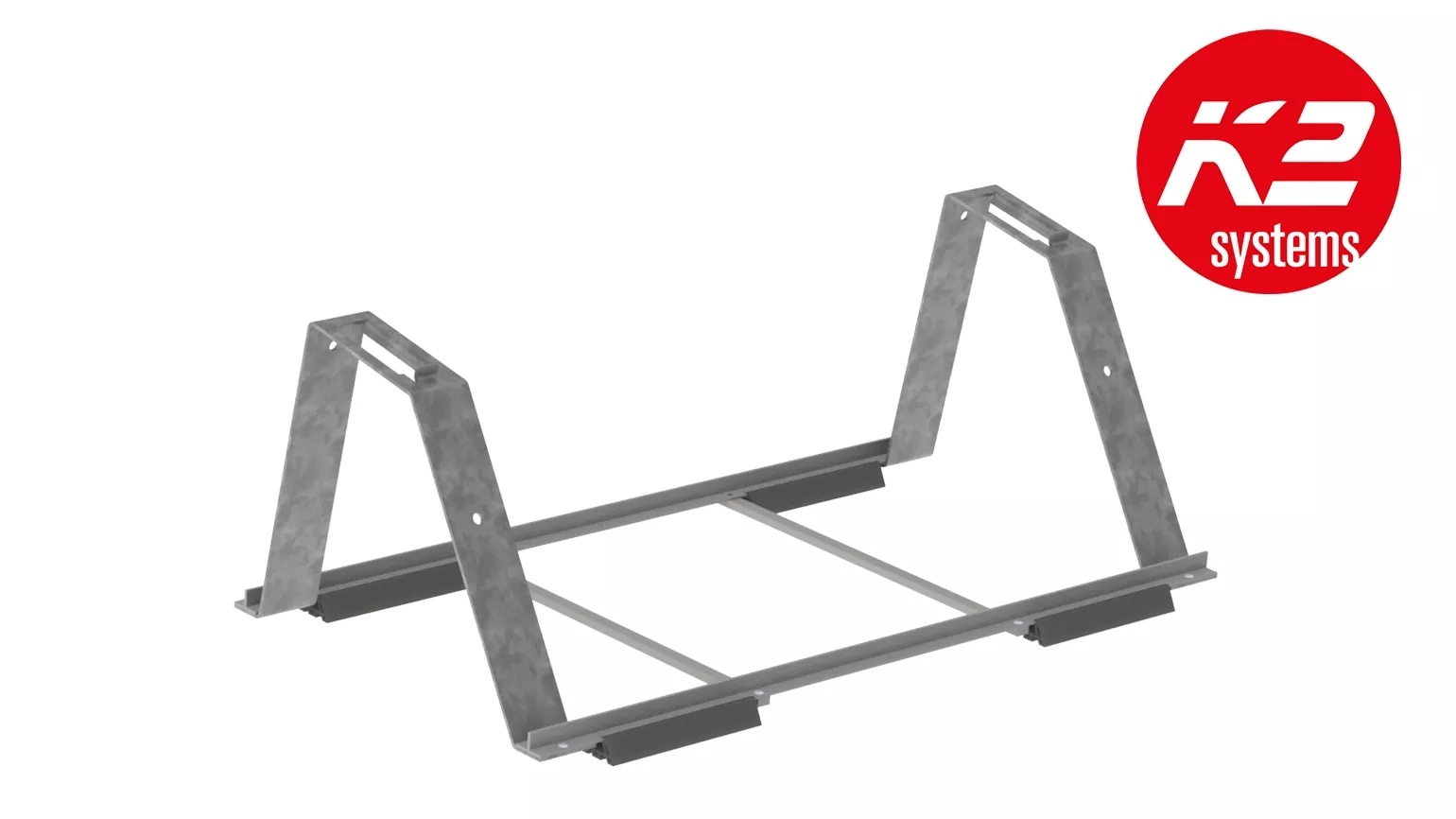

K2 SYSTEMS®
The South Face flat roof system is a UL 3741 Listed system that complies with NEC 690.12 when installed by qualified persons per the installation procedures.
- Adjustable Inter-row spacing 8-18"
- 2-part system, optional accessories
- Pre-assembled clamps twist into place
- Pre-installed mats with load/movement absorption
- Module staging tabs for easy row alignment
- South and North edge tucked chassis

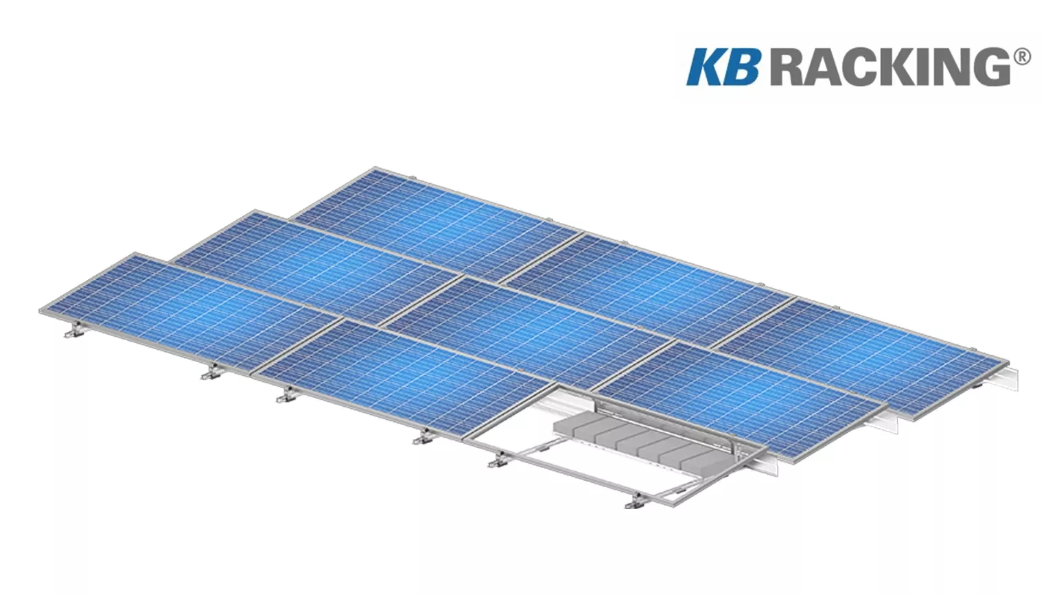

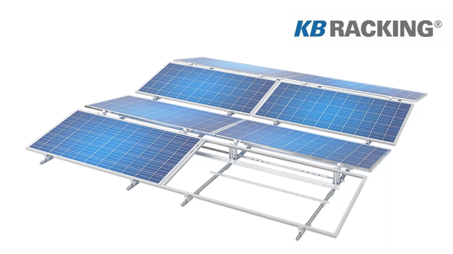

KB Racking®
The Aerogrid and EkonoRack 2.0 flat roof racking systems are UL 3741 listed and comply with NEC 690.12 when installed by qualified persons per the installation procedures outlined in the KB Racking installation manual.
Aerogrid
- Grid-based system with low ballast requirements
- Click-in components for easy tool-less installation
- Customizable row spacing
EkonoRack 2.0
- Non-penetrating solar mount solution
- Composed of only one major component
- Pre-attached roof mats
Fronius rooftop solution
It is required by Fronius USA, in accordance with our installation manual, that the Fronius Shade Cover be used when the Fronius Symo Advanced is installed in direct sunlight.
This solution allows you to:
- Place inverter next to array
- Lay flat or tilt up
Benefits:
- Protects from harsh weather conditions
- Keeps inverter’s temperature low and performance high
- UL 3741 code compliance
More about the Fronius Symo Advanced
The Fronius Symo Advanced is the ideal compact three-phase inverter for commercial and industrial applications. Get to know more about the technical specifications of the Fronius Symo Advanced.Disclaimers
