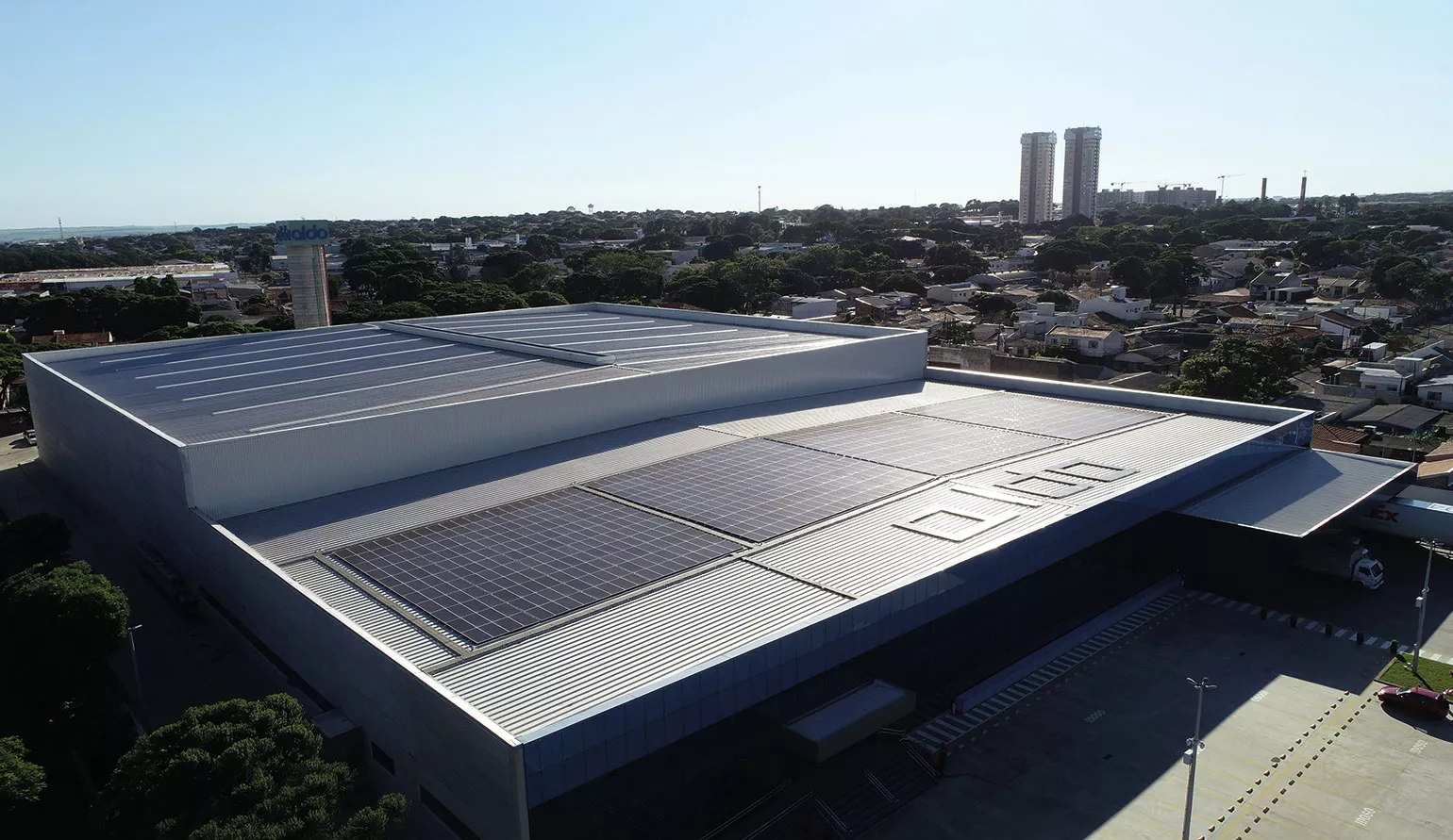

On the roof of Aldo Components Eletronicos in Maringa (Brazil) there is a 310 kWp PV system. Eight Fronius Eco inverters with an output of 25 kW ensure efficient and clean power production, with 100 % of this energy being used for the company’s own loads.

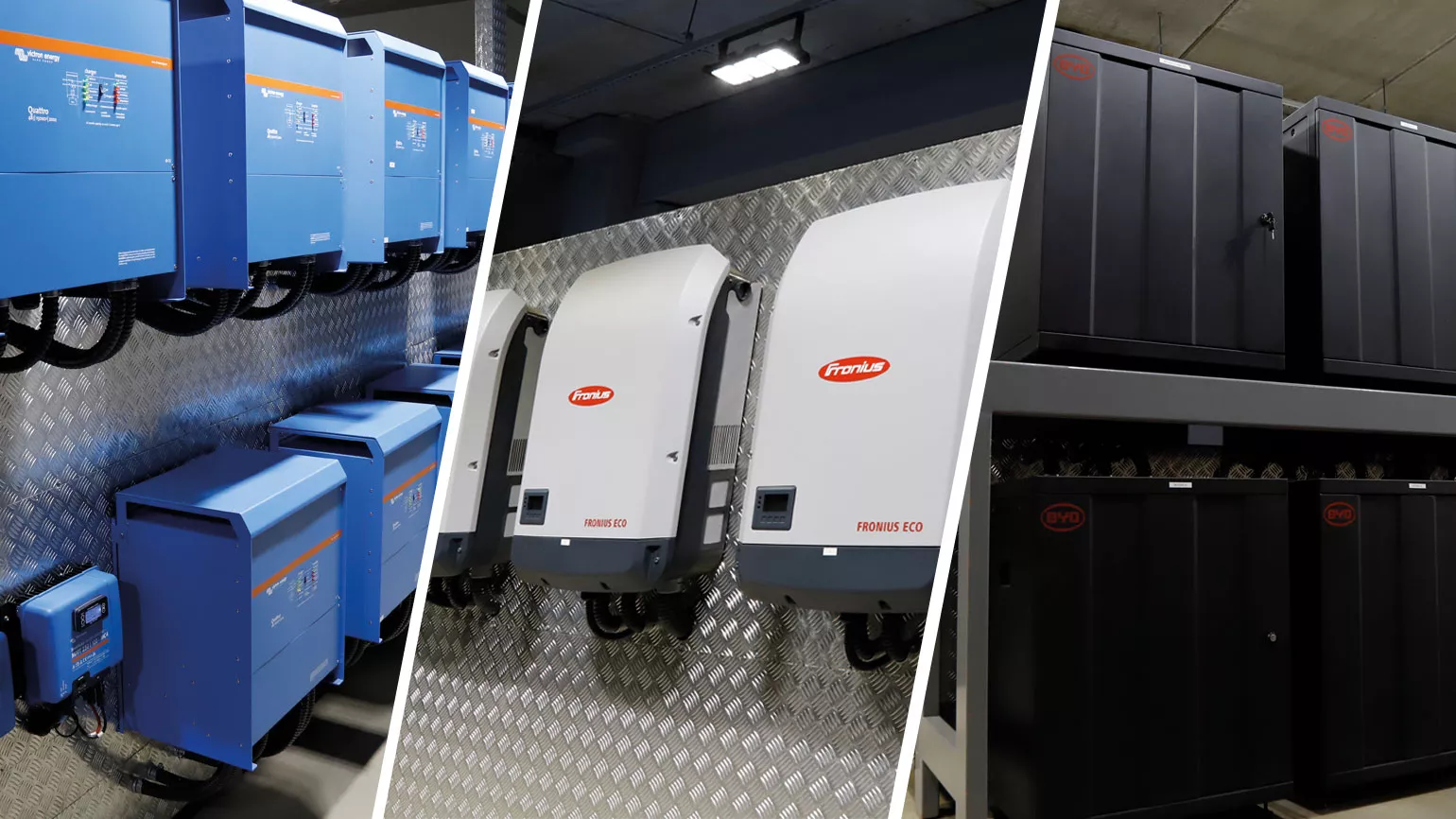

At Aldo, in addition to the production of photovoltaic energy, the installers have also focussed on its storage. With the “Aldo Solar 365” package, the company can supply itself with solar energy even in the event of a power outage. The package consists of inverters from Fronius, inverter/chargers from Victron and batteries from BYD.
The aim here is to save electricity at peak times and to protect against power outages.
Optimum communication between Fronius, Victron and BYD in the event of a power outage
During the day, the Fronius Eco supplies the energy produced from the PV modules directly to the company’s loads. Surplus energy is stored in the battery via the Victron devices.
In the event of a power outage, the inverter/chargers establish an AC grid and supply the company with PV energy from the batteries. The communication between the individual components could not be better.

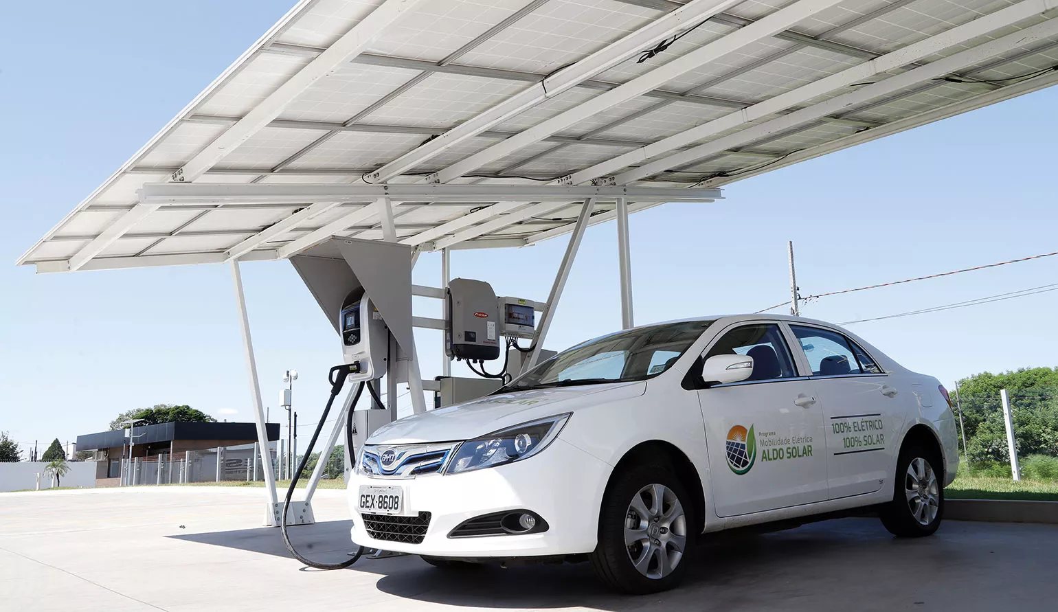

At Aldo, it is not only loads such as lighting and air conditioning units that are supplied with PV current. A charging station also draws energy from the PV system and charges electric cars with it. The PV modules were mounted directly on the carports, which means that they offer double benefits: shade for the parked cars and space for a PV system.
The current comes from a Fronius Primo 8.2.-1 inverter. Thanks to the open interfaces, Fronius inverters are compatible with almost all quality suppliers of charging devices.

  • Fronius Eco inverters
  • Victron Quattro inverter/chargers
  • BYD lithium batteries
