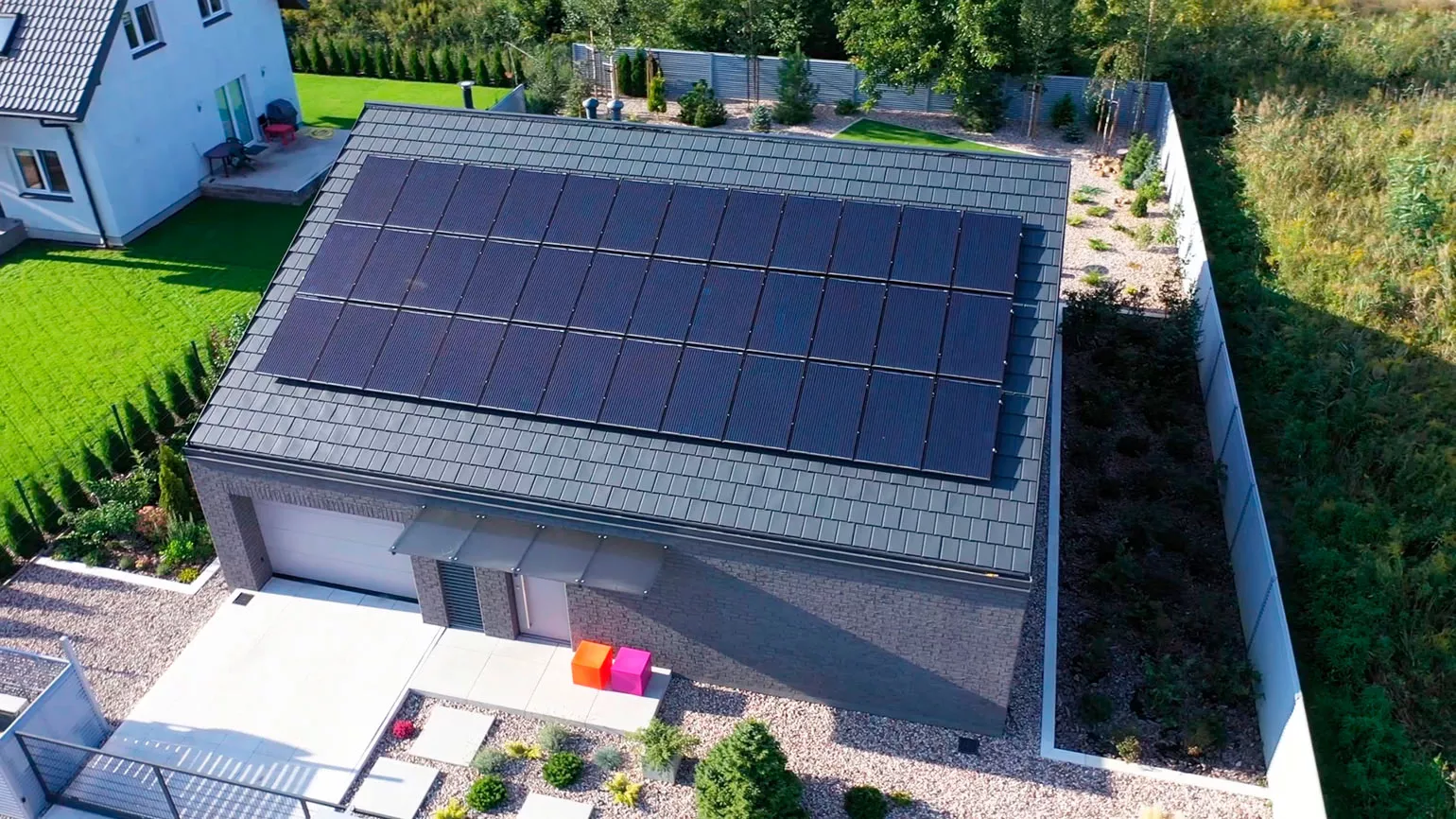

Katarzyna Baran lives in a zero-energy house in Poland and uses a roof-mounted PV system of just under 10 kWp to generate power. A Fronius Symo 10.0-3-M inverter produces approximately 10,000 kWh of CO2-free solar energy a year. Ms Baran uses this not only for her household electrical appliances but also for the electric heating and to charge her electric car.
Heating and charging an electric car with PV energy
In addition to the normal loads, Ms Baran’s zero-energy house also supplies the heating and her electric car with PV power, meaning all her energy needs are covered by solar energy. This shows photovoltaic systems pay off from the first day of their investment, as the energy for heating and charging electric cars would have to be purchased without a PV system. However, since Ms Baran can use the energy generated from her own roof, the investment costs have paid for themselves within a few years.
“I built my first house eleven years ago. At the time, I decided against a PV system – the prices were simply too high. When I was building my new house, the situation had changed. Now that prices are significantly lower, my system will pay off in fewer than eight years, even without a public subsidy.”
PV system pays off within a few years
Thanks to the integration of the electricity, heating and mobility sectors, Ms Baran is rewarded with good self-consumption rates.
Ms Baran's system pays off in fewer than eight years.

In addition to the obvious financial benefits, Ms Baran is also reducing her carbon footprint. Her system generates approximately 9,800 kWh of clean, sustainable photovoltaic energy annually. This corresponds to a CO2 saving of around 5,000 kg.
System data
Size of installation 9.9 kWp
Fronius products
Fronius Smart Meter
Modules Selfa 275W Full Black
Annual yield 9,800 kWh
