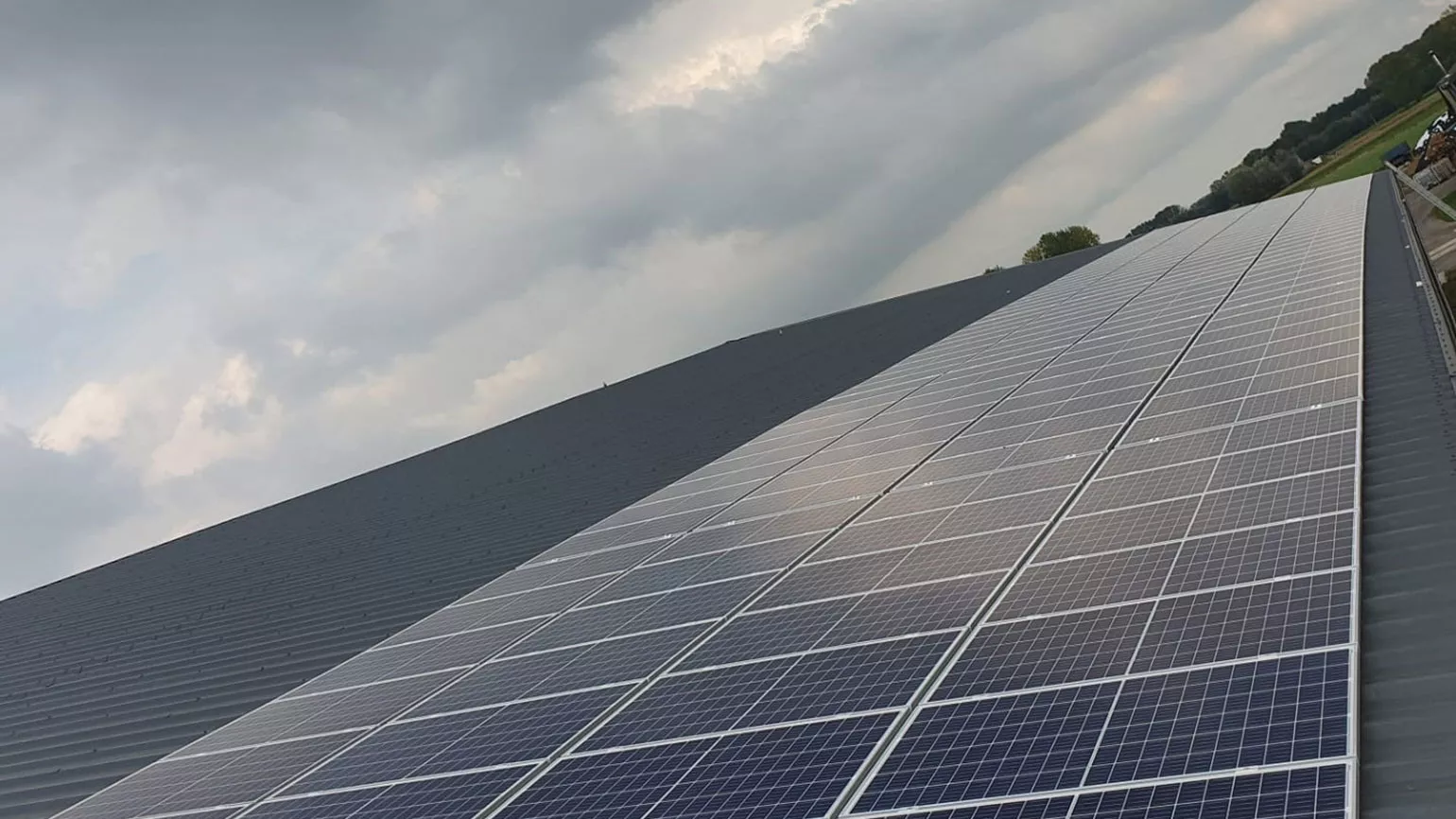

As a dairy farm with 160 milk cows and 100 young stock, who produces about 1,2 million litres of milk annually, Vermeulen LV needs a lot of energy. Therefore, they decided to install a photovoltaic system to supply their farm with sun energy.
The produced energy is used for lightning, gates, chargers, fans, milking robots, high pressure sprayers, cooling, boilers, etc.

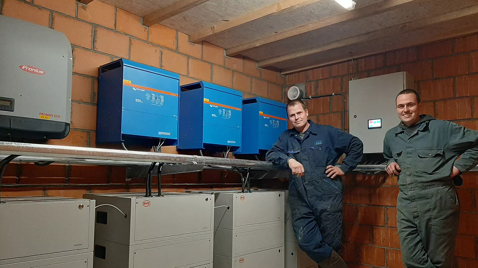

Independency from the grid
With the Fronius PV systems they are able to live completely without the grid.
In 2020 three Victron Quattro 15000 inverters have been installed inside the farm together with the batteries and their chargers.

 Size of installation:  59,4 kWp
 Location:  South Belgium

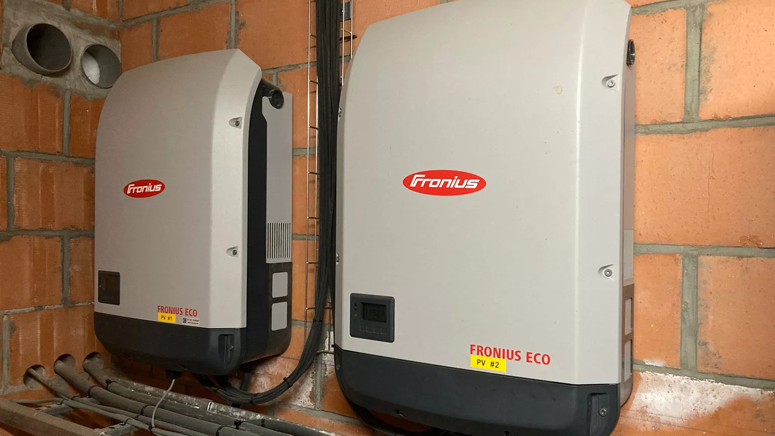

 Module type & area:  2x Fronius ECO 27.03-S

Off-grid systems are complex but with its microgrid option Fronius offers an easy way to integrate Solar panels into this system.
Even when the frequency is pushed, the inverter works perfectly, gives exactly what the consumption needs and works as tickle charger for the battery
