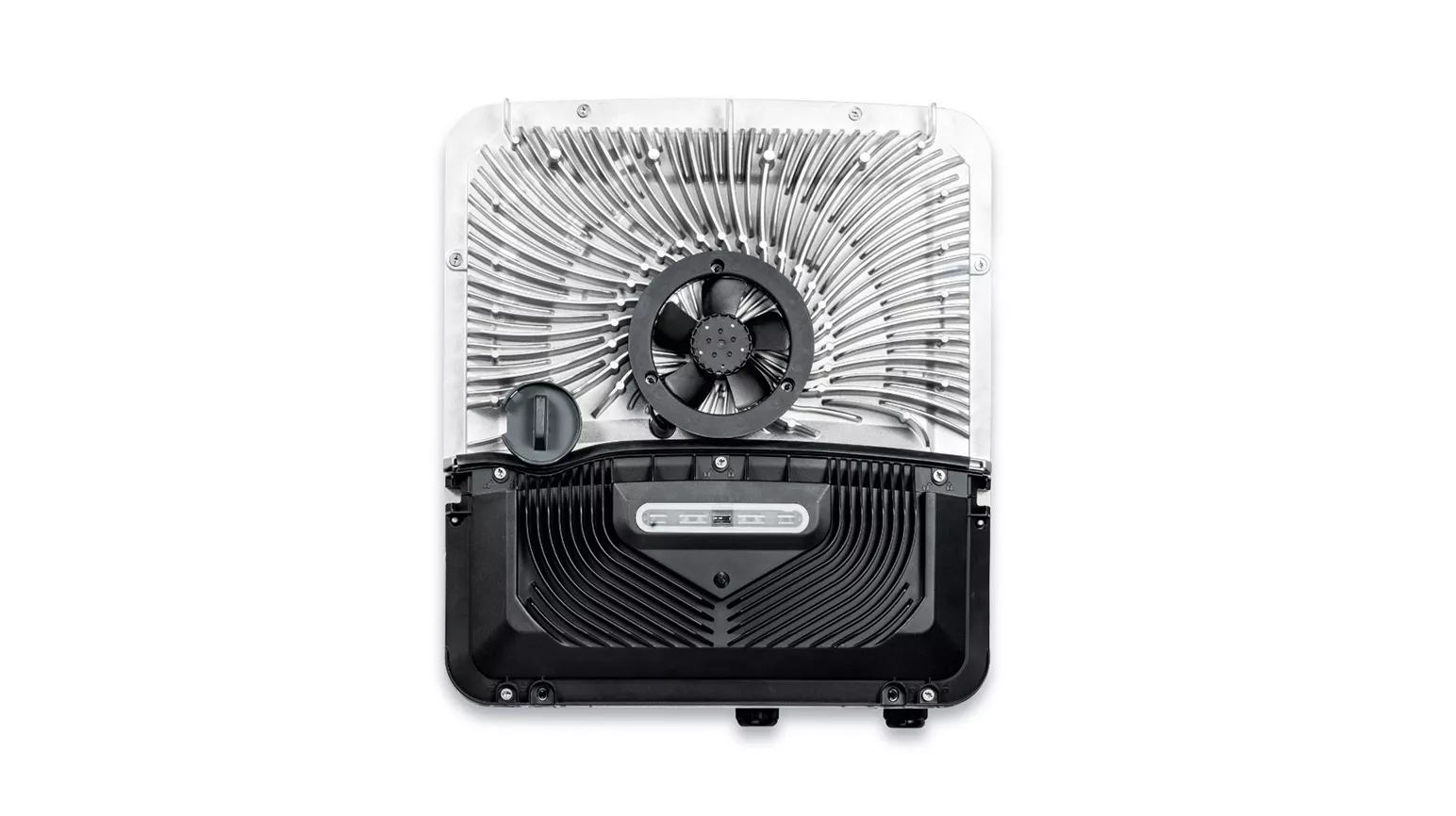

The result is a highly efficient cooling system consisting of a heat sink and a fan that optimally cools the power electronics inside the inverter. The heart of the cooling system is an innovative fan housing, which is integrated into a recess of a die-cast aluminium heat sink with specially arranged cooling fins.
(see figure below)
In this system, the fan housing ensures ideal pressure conditions, allowing optimal intake of ambient air and air flow through the system. Warm air is discharged to the outside via the cooling fins. The electronic components in the inverter remain constantly cool regardless of the external ambient temperature.

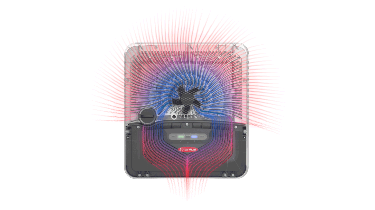

Tests have shown that, compared to a standard fan (0.6 m3 / min.), 250% (1.5 m3 / min.) of the air volume can now be passed through the system with this innovative cooling technology. This makes it possible to dissipate heat quickly and efficiently from the electronic components via the cooling fins, even with very high ambient temperatures. This results in a very homogeneous temperature distribution at the heat sink.
