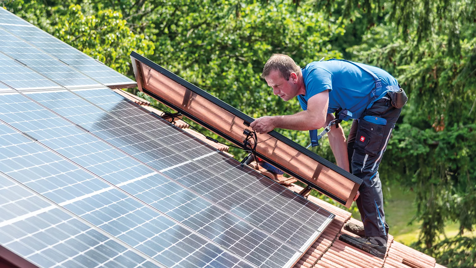

Complex areas such as dormer windows, windows, garden sheds, eaves mouldings or even façade modules can be easily connected to the second MPP tracker with PV modules configured.

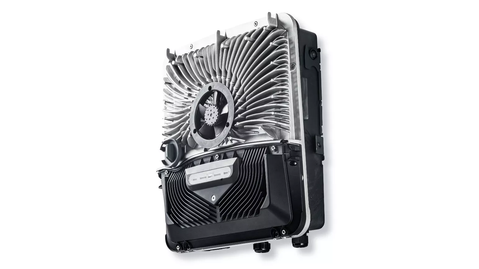

Due to the innovative Active Cooling technology, the GEN24 Plus inverters have an extremely high current carrying capacity. This is because high currents are known for also generating high temperatures.
