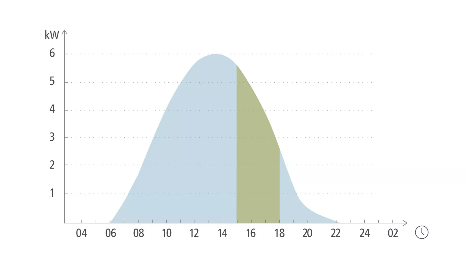

Dynamic PV surplus charging
The solution for optimal utilisation of your photovoltaic system capacity and independent charging of electric cars. The key factor here is an intelligent charging station that instantly detects when surplus energy is available.
• PV surplus     • electric car*
The charging process starts automatically as soon as there is a surplus energy present and adapts to the amount of energy currently available. After one-time configuration by the installer, this solution ensures that the car will automatically be charged using solar power that would otherwise flow into the grid.
This solution can be implemented perfectly with a combination of the Fronius Wattpilot and Fronius inverters. The inverter’s open interfaces enable direct communication with the intelligent charging box.

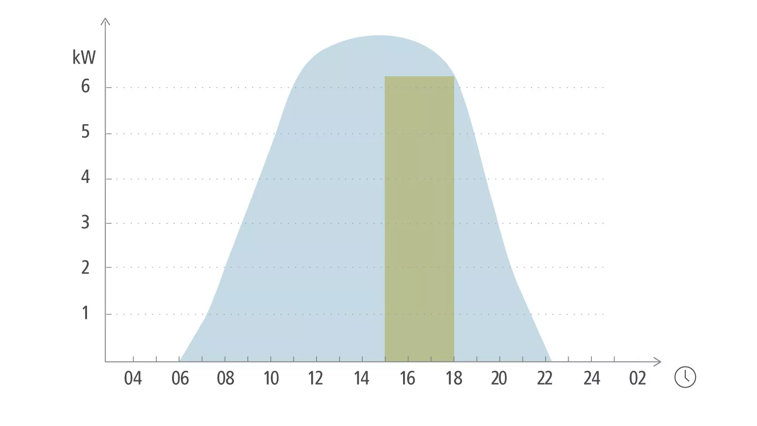

PV surplus charging with energy management
If no intelligent charging box is installed in the system, the Fronius inverter with energy management function can also control the charging process.
The inverter will then always use a digital output to control a charging socket or simple charging box if a defined PV power or PV surplus threshold value is reached.
In contrast to dynamic surplus charging, the charging process for this variant cannot be constantly regulated. The charging power is fixed for each charging process. The inverter activates and deactivates charging automatically depending on the PV surplus present.

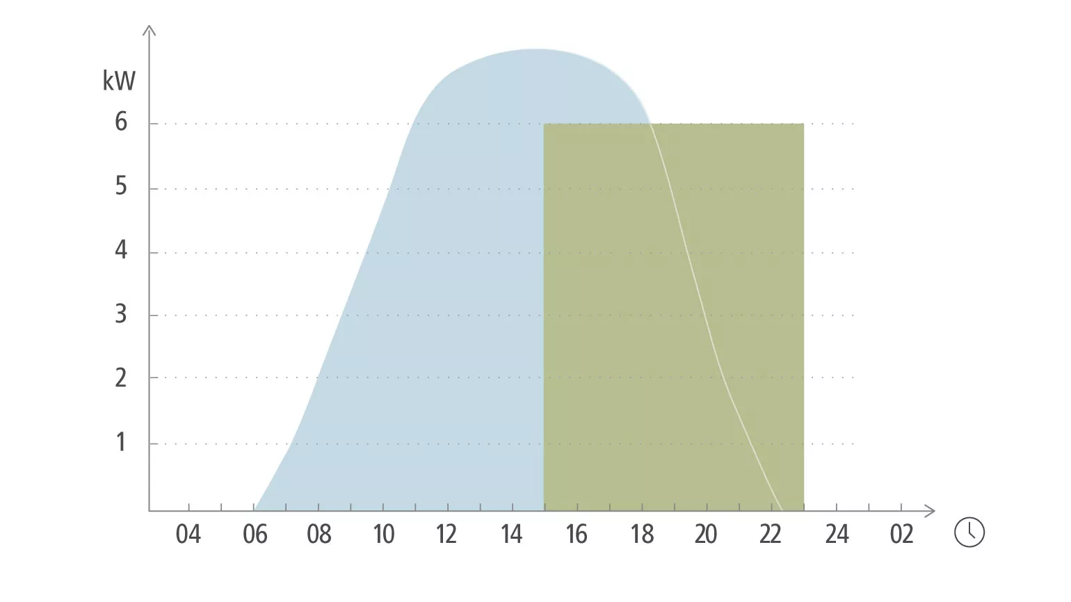

Manual charging of surplus pv
Alternatively, charging can also take place without energy management. However, the charging box must be activated manually for this variant as soon as a PV surplus is available.
Nevertheless, the charging power of the charging box must be adapted to the power of the photovoltaic system. Otherwise this could lead to expensive load peaks.
Possible with
