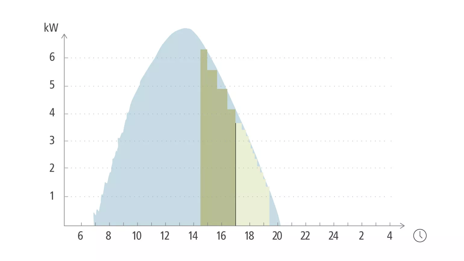

IT DOESN'T GET CHEAPER THAN THIS: CHARGE USING YOUR OWN SOLAR POWER
If your customers are PV system owners, they'll already be benefiting from the environmental and economic advantages of generating their own energy. As electric car owners, they can significantly increase their potential savings with the Fronius Wattpilot.
This electric car charger can make optimal use of any surplus energy from the PV system to sustainably charge the vehicle at virtually no cost.
The benefits: your customers save while they charge and make optimum use of their PV system so that it pays for itself faster.

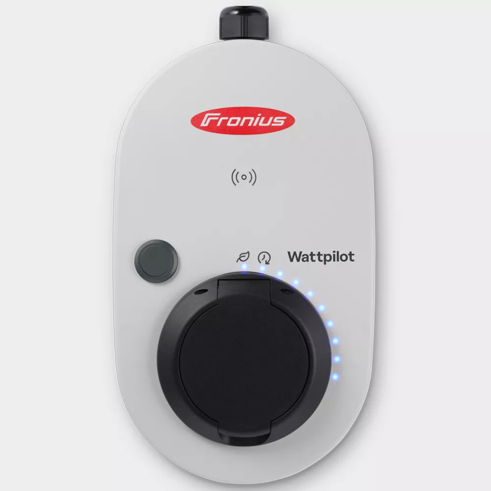

The Fronius Wattpilot The electric car charger for at home and on the road. Useful functions and features for your customers.
Quick selection The Eco and Next Trip modes can be selected directly on the device. The exact charging current can also be set by pressing and holding the button.
1
Residual current device Also protects against additional costs: Since the Fronius Wattpilot detects DC fault current immediately, no upstream type B RCD is required.
2
Security & control The Fronius Wattpilot can, if required, be secured with an approved RFID chip or card, protecting it against misuse and making it secure for use in public spaces.
3
Anti-theft protection The Fronius Wattpilot and the type 2 charging cable are valuable items that you should and can protect. The corresponding anti-theft protection is included in the scope of supply – a shackle as protection for the Wattpilot and the locking option for the type 2 charging cable.
4
1
Quick selection
2
3
Security & control
4
