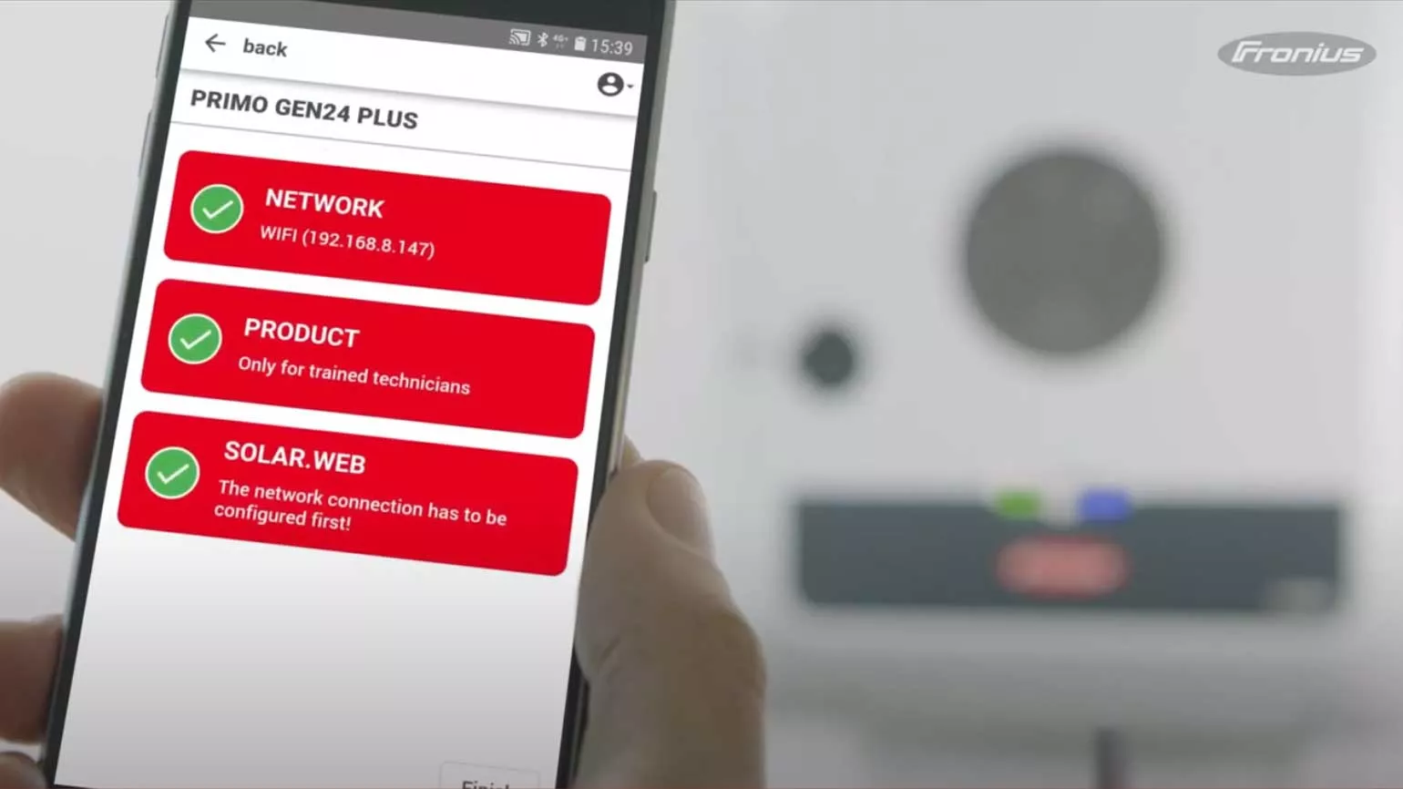

Start up your GEN24 using a smartphone with the Fronius Solar.start app installed. The app will lead you through the process and help you easily connect the inverter to the internet.
Download Solar.start here:
Google Play StoreApple Store
Alternatively you can use your browser for commissioning. We recommend bringing a tablet or laptop for this. Connect your device to the inverter's WiFi access point and enter the following IP address into the address bar of your browser: 192.168.250.181
