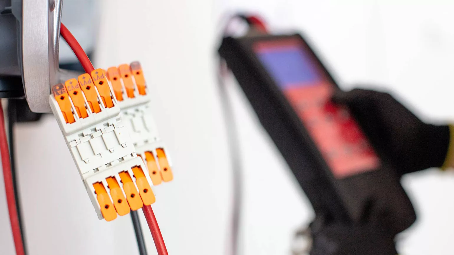

The Inspection Kit GEN24 allows PV systems to be inspected easily and safely. Instead of the cabling to the inverter terminals having to be disconnected, with this kit all the technician has to do is unplug the connectors together with the cables and plug them into the supplied counterparts.
Measurements can thereby be conducted easily, quickly, and safely. The kit is compatible with all standard types of conductor and may be used with or without ferrules.

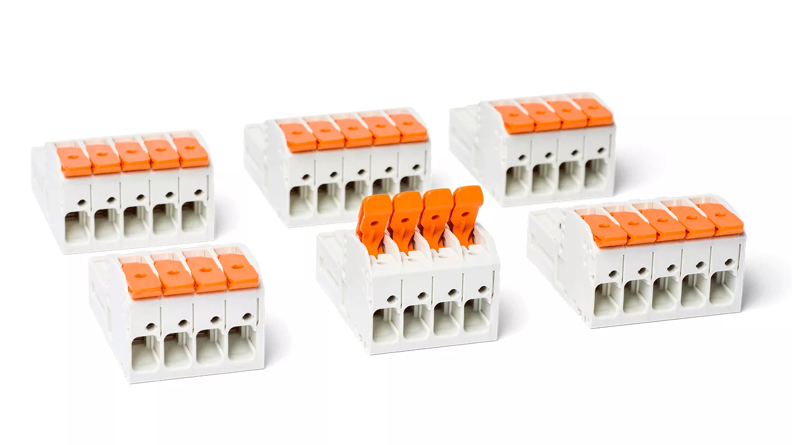

Pack contents | 1x 4-pin and 2x 5-pin push-in spring-type terminal |
Rated voltage | 1000 V |
Rated current | 41 A |
Connection cross section | 0,5 - 10 mm² |
Temperature range | -60 - +105  °C |
Dimensions, 5-pin connector (WxHxD) | 41  mm  |
Weight, 5-pin connector | 31,8 g |
Dimensions, 4-pin connector (WxHxD) | 33,4  mm  |
Weight, 4-pin connector | 25,8 g |
Pack contents | 2x 4-pin and 1x 5-pin push-in spring-type terminal |
