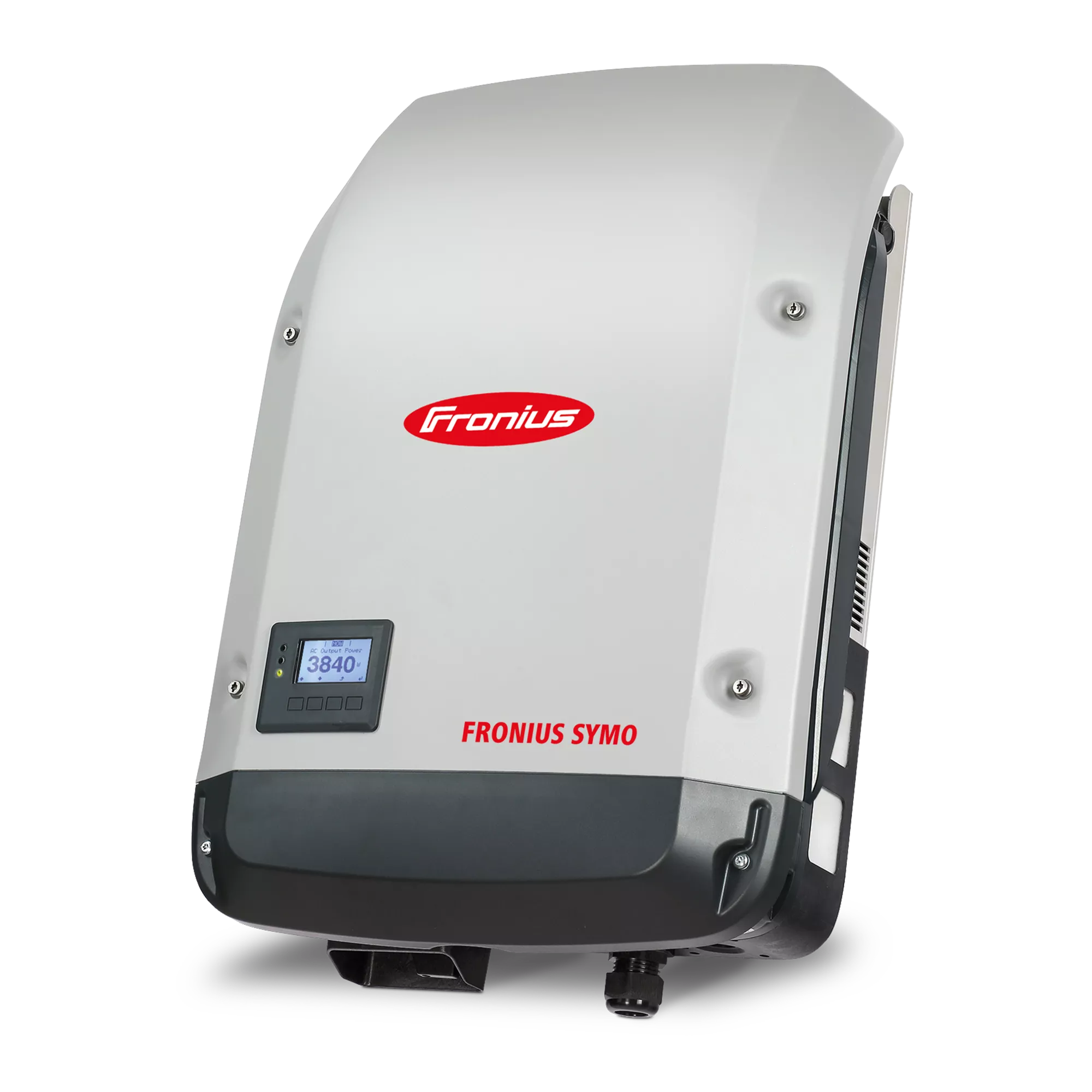

Fronius Symo
Maximum flexibility for the applications of tomorrow.
With power categories ranging from 3.0 to 8.2 kW, the transformerless Fronius Symo is the three-phase inverter for every system size. Owing to the SuperFlex Design, the Fronius Symo is the perfect answer to irregularly shaped or different roof orientations. A WLAN or Ethernet internet connection as standard plus easy integration of third-party components make the Fronius Symo one of the most communicative inverters on the market. Furthermore, the meter interface permits dynamic feed-in management and a clear visualisation of consumption.

SnapINverter technology
The SnapINverter generation of inverters features a simple, standardised mounting system, making installation and maintenance easier than ever. A special feature in the design of the device is that the connection area is separate from the power stage set compartment, with both being installed separately. The remarkably light connection area and all its cabling is fitted to the wall first, followed by the power stage set. The innovative hinged system makes installation and servicing extremely user-friendly. The inverter is simply placed in the wall bracket and then secured. This means that it is not necessary to remove the entire inverter for servicing, just the power stage set. All the cabling remains in place.
