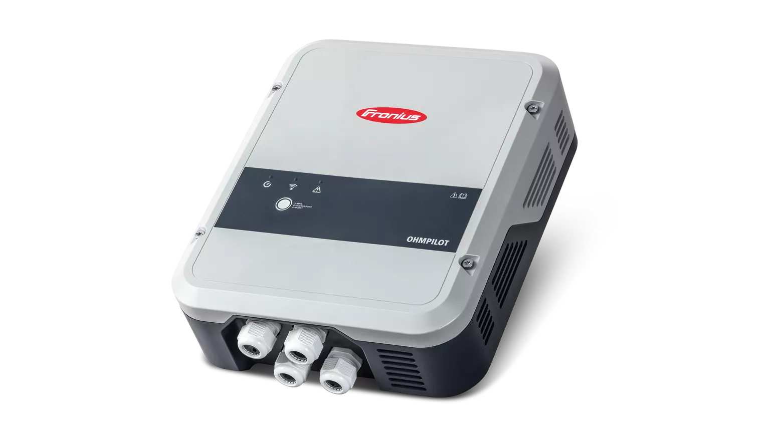

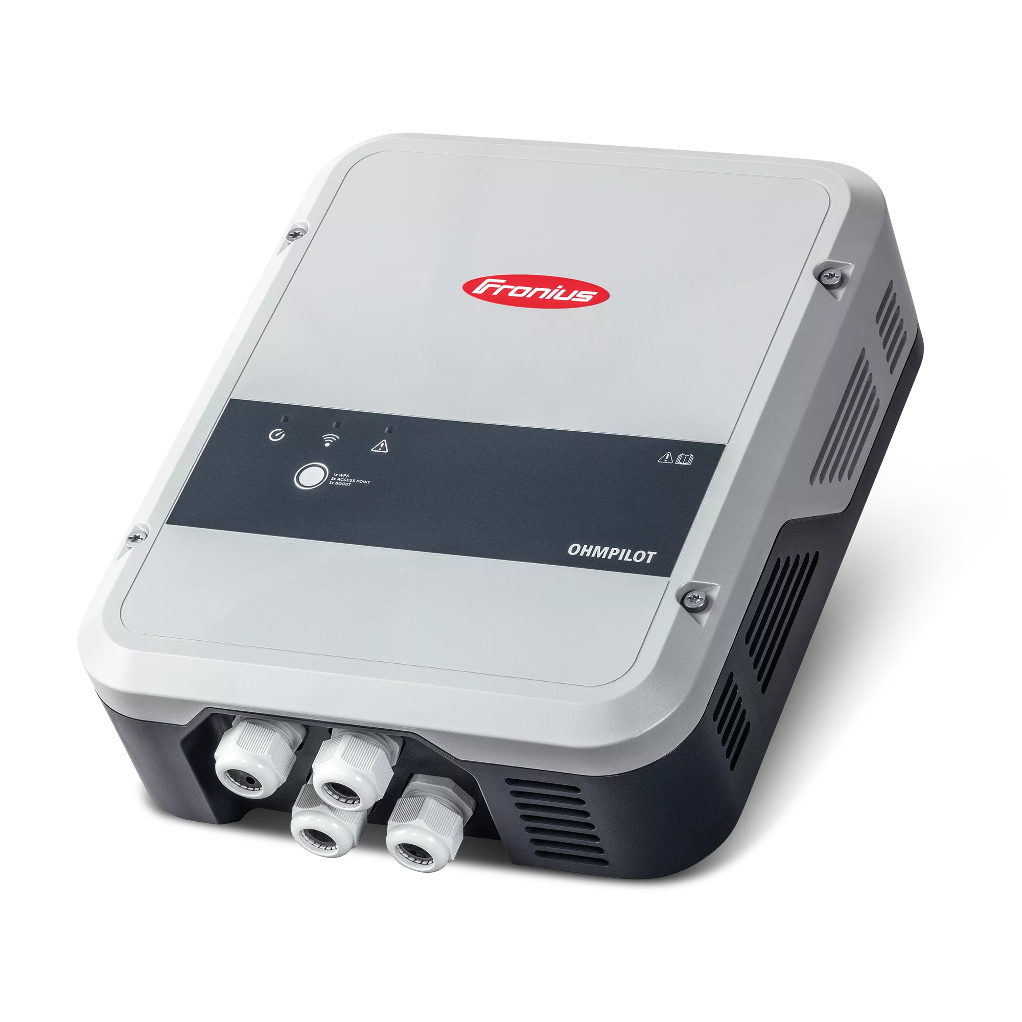

More self-consumption for more independence: this is exactly what the Fronius Ohmpilot was developed for. With our Fronius Ohmpilot secondary regulator, even the smallest amounts of surplus photovoltaic energy can be used for hot water treatment and heating – right down to the very last watt. Fronius Solar.web gives you a convenient way to demonstrate the Fronius Ohmpilot, impressing customers with how quickly they can recoup the investment costs of their photovoltaic system by making the most of self-generated energy. Fronius Ohmpilot. Designed to heat.

Frequency (Input) | 50 Hz |
Max. input current (Iac max) 1) | 1x16 A / 3x16 A |
Input voltage 1) | 3~NPE 230 V (400 V) |
Output Data
AC output current (Iac nom) 1) | 1x13 A / 3x13 A |
Output voltage 1) | 3~NPE 230 V (400 V) |
Frequency (Output) | 50 Hz |
Max. output power | 3 kW / 9 kW (each continuously adjustable) |
General Data
Width | 280 mm |
Height | 350 mm |
Depth | 110 mm |
Weight | 3,9 kg |
Type of power regulation | Pulse width modulation |
Protection class | IP54 |
Installation | Wall mounting |
Ambient temperature range | 0 - 40 °C |
Permitted humidity 2) | 0 - 99 % |
Certificates and compliance with standards | CE, EN 61000-6-2, EN 61000-6-3, EN 61000-3-2, EN 61000-3-3, EN 300 328 |
Certificates and compliance with standards | EN 61000-3-2, EN 61000-3-3, EN 300 328 |
