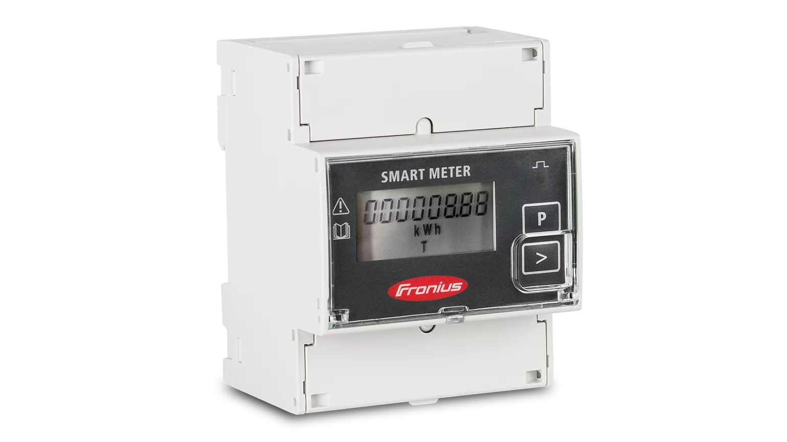

Fronius Smart Meter
Measure to pay less: Fronius Smart Meter
Visualise, control and optimise energy flows: you can only do that if you have the right data. And this is exactly what the
Fronius Smart Meter – our bidirectional and intelligent electricity meter – provides.
Based on the information obtained, and in combination with the inverter and Fronius Solar.web, you can deliver efficient energy management, which saves your customers money – whether for private or commercial photovoltaic systems.
We offer the right Smart Meter for photovoltaic systems for every application. Unlock the potential of the data. You can rely on the Fronius Smart Meter. Designed to monitor.
