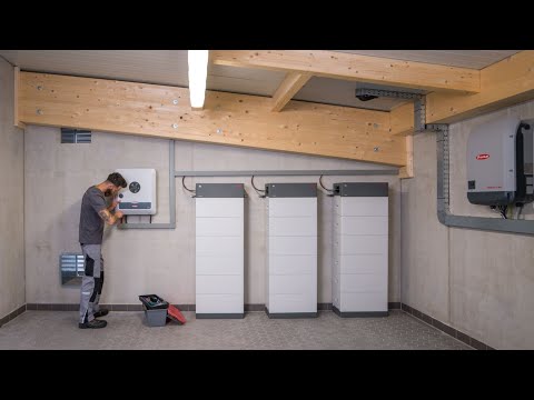

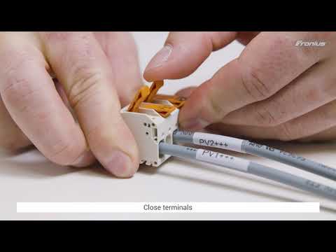

Installation & Commissioning
To help prepare you to install and commission the Fronius GEN24 Plus, we have collected all important information and technical details.
This should guarantee the quick and easy installation of your first GEN24 Plus hybrid inverter!
Software update
Please ensure that your GEN24 Plus always has the latest software version.
This can be installed in Solar.web under Settings - Components.
Don't forget to bring your tried and tested Torx 20 screwdriver. All screws are easily fastened with a quick-lock system, meaning you only need to turn the screw 180° to fasten it.
Please note: Don't turn the screws more than 180° and don't use an electric screwdriver.

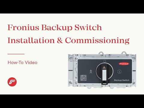

Backup Switch
  • manual switching
  • maximum current load: 63A
  • three-pole (3P) and four-pole (3PN) versions available

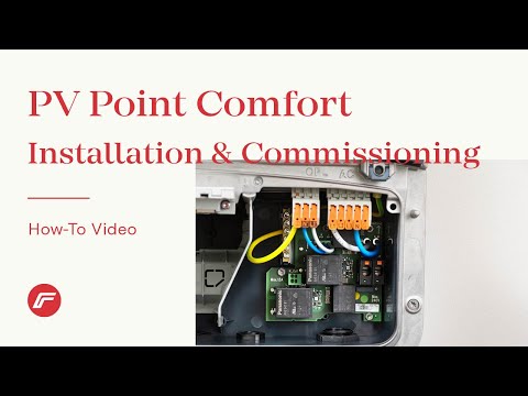

PV Point Comfort
  • Single-phase up to 3 kW
  • Retrofit board integrated into the inverter (no external switching required)
  • No battery required (emergency power purely via PV possible)
  • Supplies socket or circuit in case of emergency power and also in parallel grid operation
For all automatic variants, the switch from normal operation to emergency power supply takes less than 35 seconds.
